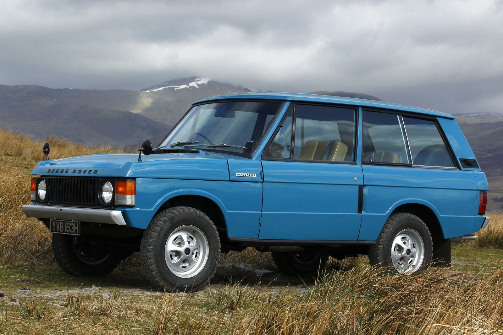

Yup, I'm especially fond of the older range rovers, check this beauty out
wreckdiver1321
Overlander
As happy as I am to be driving my Frontier, I still :drool: over Landys like that. I love the RRC. That particular model was back before the Range Rover was luxurious at all. It had removable floor matting so you could wash it out with a hose. Those two door versions are super rare over here.
