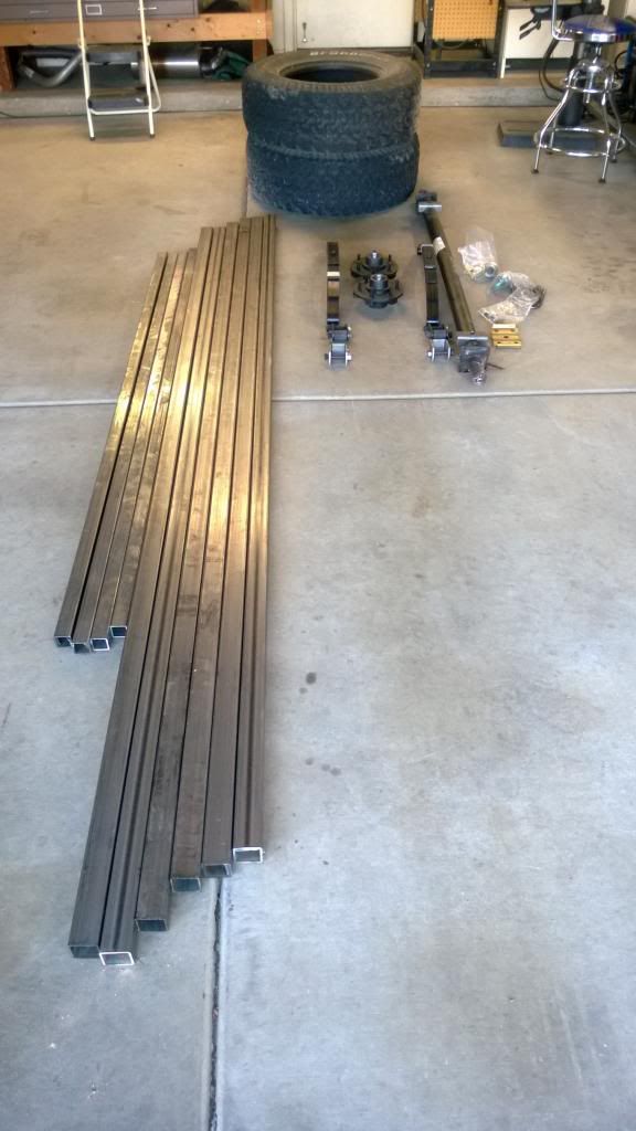

I will start this off as my first post to the forum, I have been wanting for years build me a trailer, to haul my flat bottom pram to go fly fish the remote lakes around the county. I have got some great ideas from all the builds on this forum, I have been on the trailer build for little over a month now. My only three requirement I gave myself build it from the ground up, have it done by May of this year, and 100% tig weld it.
Here is the start of it all.
Fj factory steel rims right off the ups truck.
Here is the pram flat bottom boat the trailer will haul.
The start of the frame.
Yes I own a FJ cruiser Factory 17 inch steel rims.

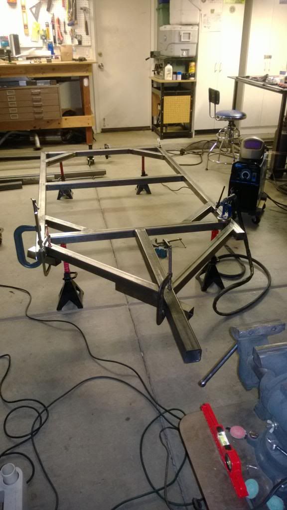

Starting to tig weld the frame.
The frame all welded up I got it done in a day.
Next Day got the axle on.

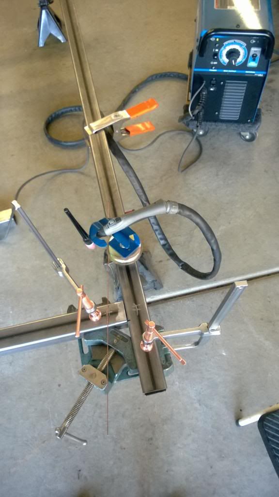

Some close up weld pictures
