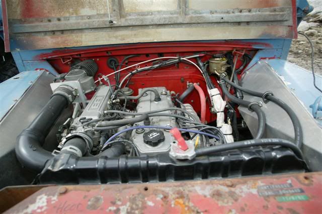

Ours is powered by a Toyota 22RE from a 1991 truck, and backed by a short iron-case 5 speed manual out of a '79 Toyota 4x4, which was built by Marlin Czajkowski as a favor to me. Behind that is an RF1A t-case with 5:1 reduction gears. The axles are 1985 Toyota and have 5.29 gears installed in TRD electric lockers. The front axle has been upgraded with Longfield axle shafts and CVs and topped with high steer via OTT, who are no longer in business. The frame side of the steering includes a Toyota mini truck power steering box mounted almost on the front bumper, poking its nose through the driver side fender. Wheels and tires are stock 15x6 Toyota steelies and 34x9.50 Interco Swampers.
