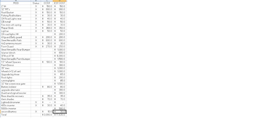

Mods to date
2" Rough Country lift
265/70/17 maxxis bighorn MT's
Steel Armadillo Super Sliders
1.5" Spacer Installed
4xguard Front skid
4xGuard Belly guard

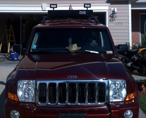

Baja lights mounted in back
CAI by Sal-XK
Chopped front bumper mod
Custom storage box
Dual Batteries
FireStik Antenna on 4xG mount
fishing rod holders
Front recovery hooks
Inverter install in center counsel
Jack storage conversion

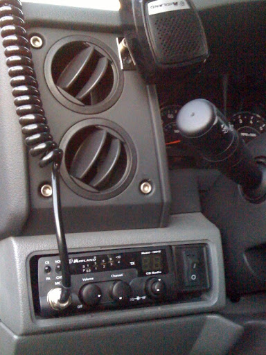

Midland CB in side cubby
Monroe Load Leveling Shocks on Rear
OEM fuel tank skid
OEM suspension skid
OEM transfer case skid
Painted bumper & wheel flares
Painted Rocker & Doors
Rage roof basket
Third Row Removed Storage
uni-strut cross rail mod

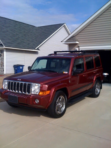

Stock XK

Rage Roof Basket Intalled

Midland CB installed

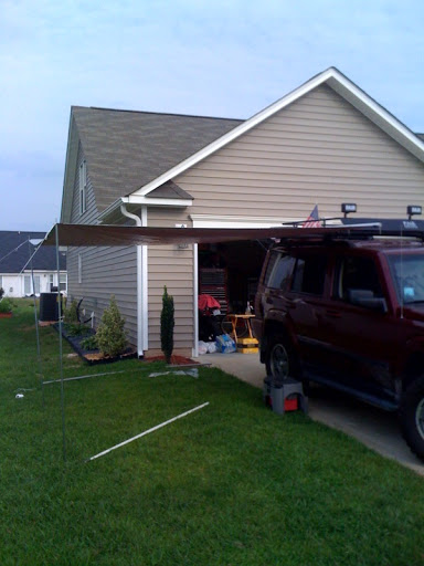

Home mad awning installed
Lights installed
