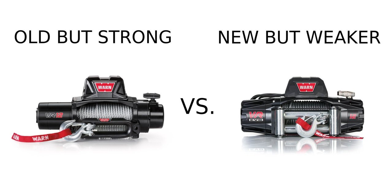

According to this article, the actual strength difference from the older 8k to the newer 10k is one wrap of cable on the drum, meaning if the heavier one has 4 wraps, the lighter one will pull the same load with 3 wraps, plus the cable is smaller diameter so the losses are even less.
Made in China Warn Winches: The Old VR vs. The New VR EVO
The real news with the EVO line is that the motors are weaker than previous generations! Check it out here!
