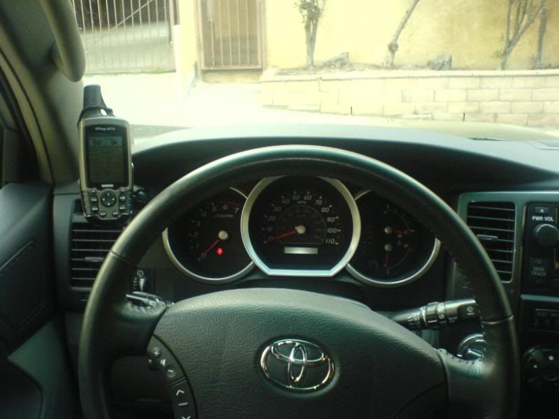

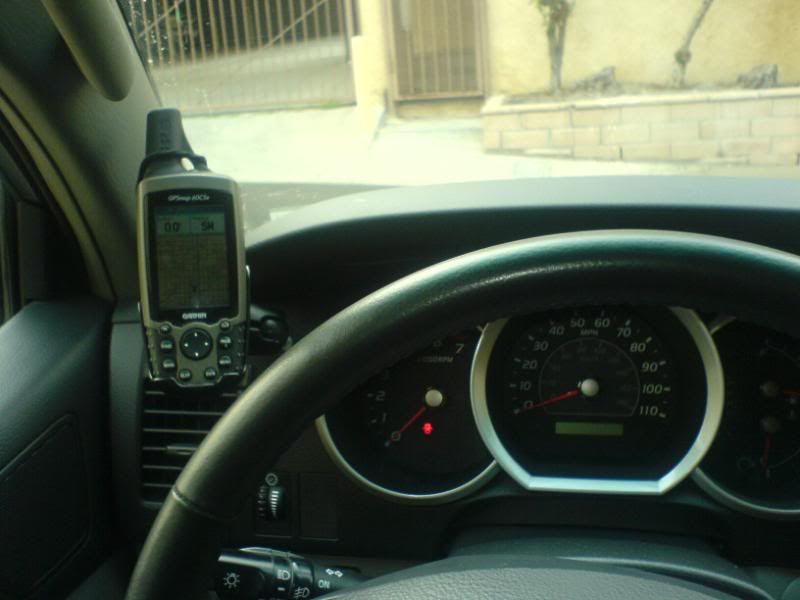

Clark White
I just use a suction mount to the bottom left corner of the windshield. low enough that it doesn't block my view any, and its right there where you can see it and use it while driving with out taking your eyes off the road. One of the best solutions I've seen! Other major pluses is that you can move it, put it in a different vehicle, etc. when you are traveling in another vehicle.
Clark White
My GPS mounted...
The mount it's self.
Drivers eye view.
I routed the power cable through the dash, so it is out of the way and hardly visible. The mount is adjustable, so if you want to move it up or down, etc. you can do that.
