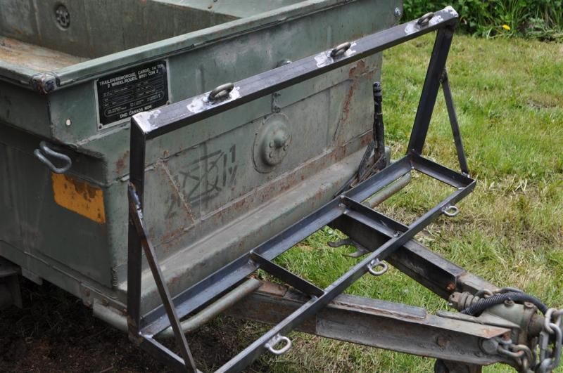

First up a lid and rack to mount the new Tepui Kukenam Ruggedized XL tent.
Framed around the outer edge with 3/16 thick 1.25"X1.25" angle.
Then tacked on the 18" thick 1"x2" rectangular tubing that I welded in bungs with 1/4-20 threads to line up as close as I could with the tents mounting holes. I wanted to keep the tent as low as possible so the extruded channels that are usually used for mounting will not be used in this application.
Cross tube end cap. I added a hoop to them, they are a little small but you can't have too many tie downs :)
Made three hinges. Tried to guesstimate the room to leave for the foam rubber seal before welding in place.
Reinforced the hinge. My welds aren't prety but should hold up :)
Welded on tabs for the lift struts.
My lovely wife was kind enough to paint the frame with POR15 to keep it protected until the whole trailer gets done. She has much more patients when it comes to prep than I do...best to leave it to the professional.
After paint I used Sikaflex to bond a sheet of 10ga 5051 aluminum to the frame.
More to come....

Picked up two adjustable toggle latches from ebay. I liked the looks and added beef of the McMaste-Carr latches better but they wouldn't sell me any since I live in Canada. Ridiculous.
Had to make some aluminum spacer blocks for the latch and I just welded the other half to the lid.
150 pound lift struts. I picked up from the local Peden RV. I just bolted the 10mm ball mount on the trailer but I think I'll add more reinforcement to them soon. A lot of force applied to them.
So much force when trial fitting before I glued the aluminum sheet it would twist the angle iron when closing. I wasn't that confident that the lids frame would hold up to the twisting over time so I made a brace that spans from the tab to a crossbar. Think it's a bit overkill but I like to overbuild.... It's more fun :)
In this pic you can also see the 2"x3/8" foam rubber seal added to the lid. I allowed for 1/4" compression of the seal and it seemed to work out okay.

Oh, in case someone else wants to try. I first mounted the lift struts (or gas springs whatever you want to call them) to the other side of the trailer box so they would act the same way as most rear hatch lift struts do on vehicles. Turned out that 150lb springs would be nowhere near strong enough. In that orientation one strut would not even hold up the bare lid frame. So I swamped it around like you see in all the trailer builds....should have known.
Now with the two struts and tent they work well. It requires a bit of a push to get things moving but it is quite liveable. Thought about adding a handle but didn't want the look of it. In hindsight I should have welding something on to push and pull on. Think I'll try and add a rope or something soon.
