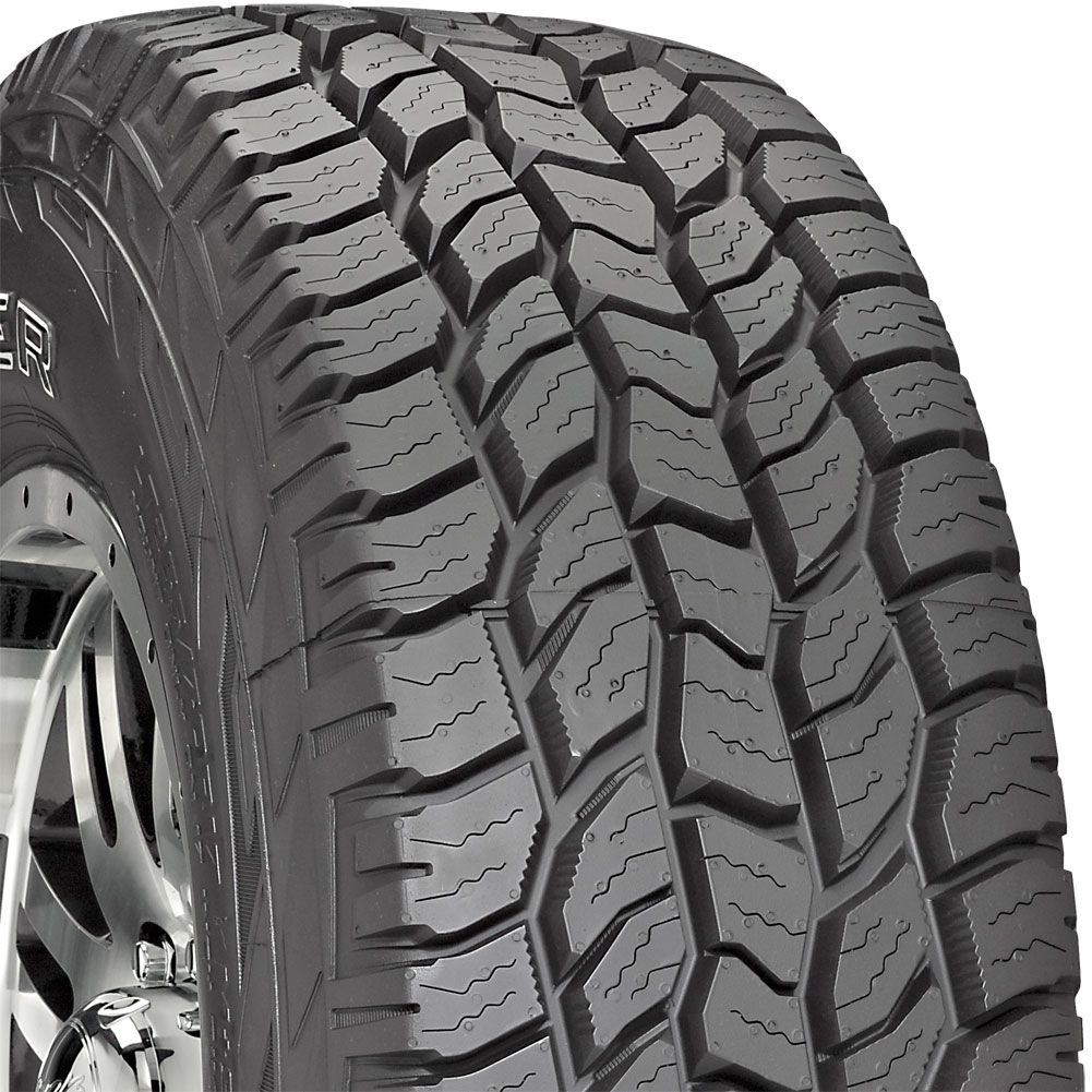

As an FJC owner I know one of the bigger issues with the 265/70-17 size is the lack of C or D Load Range tires. There are few choices and not all are relative bargains. It seems we are stuck with mostly Standard Load (SL) P-Metric tires or overly heavy/stiff E Load Range tires. The more highway-oriented P-Metrics generally don't suit the capabilities of our trucks while the E Loads are so heavy they unnecessarily hurt mileage, ride, and maybe even the ability to conform well when aired down on lighter-weight vehicles. For example, I know for a fact that the Nitto Trail Grappler is almost bulletproof, but it is seriously heavy and the sidewalls are so stiff that there was no significant bulge in the sidewall of a 35x12.50-17 until it was aired down to less than 15PSI on a 2-door Wrangler. There are currently C Load offerings for the BFG All-Terrain ($230ea) and Goodyear Wrangler Duratrac ($246ea), but there is also a C Load version of the newer Cooper Discoverer A/T3 for around $200ea (mount/balance not incl.).
t_20110624_copvl9_xl.jpg~original
