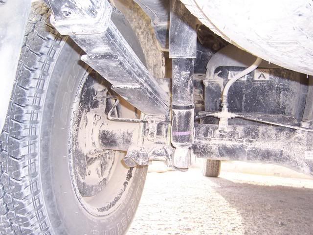

I found this 2006 Hilux in Iraq and took some photos of some things I thought were interestingly different from my 2005 Tacoma
This particular Hilux was built in Thailand... my Tacoma was built in California.
Both are gasoline engines, the Hilux is a 2TR-FE as opposed to a 1GR-FE in the Tacoma.
Front suspension appears identical at a glance, however, the rear leaf springs look much beefier than what my Tacoma came with. Both have the plastic gas tank skid plate.
The biggest difference other than the sheetmetal, interior, and steel bed is the rear frame... compare the rear section, cross members, spring hangers etc. The Hilux rear frame is fully boxed and twice as stout IMO.
