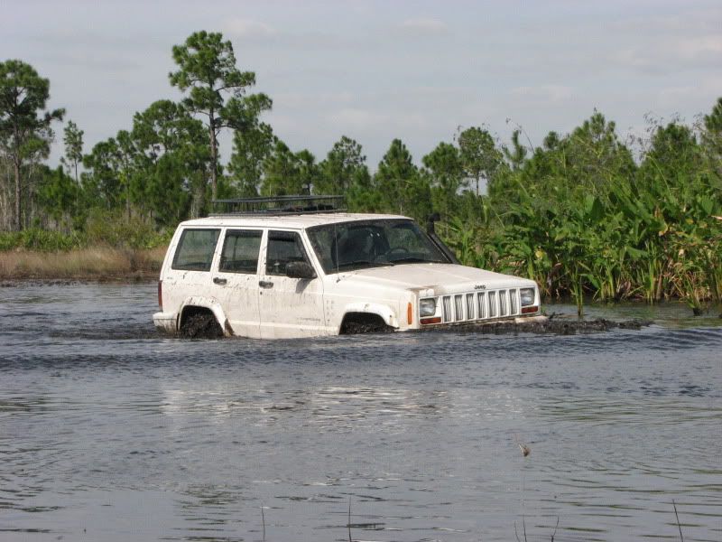

My first 4wd experience, 98? Cherokee that hit a pole at 40mph per the previous owner:
6" Long arm lift on 35's. Never drove it, just rebuilt, then transferred some of the parts to the new white one (xfer case and SYE). 4runner was also only 2WD or I would've lifted that.
I bought the white one mostly modded with a crappy transfer case. It had a 2-3" lift on 31's. It would go through a LOT and keep going.
I'll end up with another Cherokee, but a decent one was in the same price range as the Tahoe, so I figured I'd give it a try.
