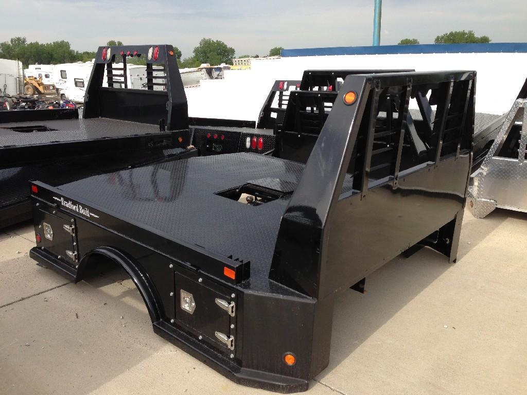

Although I can't find a good pic of the bed I'm actually getting, this different model from Bradford built shows the headache rack and deck detail.

The tire goes under the bed. It actually touches the frame rail. On the passenger side. I may have a picture in my build thread. F450 flatbed camper build. I will look. Where the little door is on the bed shown. The box / door is made 36 inches. And the tire fits there.
Thanks Capt. I already have custom built under body boxes built for that spot. Bradford has some lost space at the headache rack, so I'll use that space with a pair of spares. Thanks though. It's a great idea.
