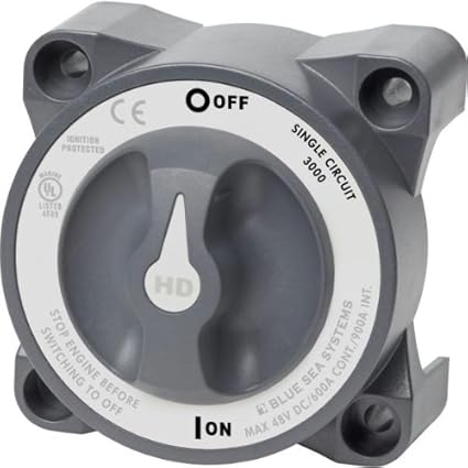

instead of installing a set of quick connects for my winch wiring i would like to install a easy to use switch on the (+) wire under the hood. Does anyone have a recommendation? I would rather not use a big BlueSea battery switch, looking for something simple and small.

The only real way, with 500 Amp Continuous Duty, to have a tiny switch inside the car, but heavy duty operation under the hood is going to be with this:
http://www.bluesea.com/products/7700/ML-RBS_Remote_Battery_Switch_with_Manual_Control_-_12V_DC_500A
Not the cheapest option available, but I wouldn't go cheap when I'm dealing with the amps in question. Marine grade durability, performance proven around the world, you can't go wrong with Blue Sea.
The hella switch will do the trick affordably, but removes the convenience of the in-dash switch.

Dennx
I got this Blue Sea switch for my winch install.
Continuous Rating 600A
Intermittent Rating 900A (5 min)
