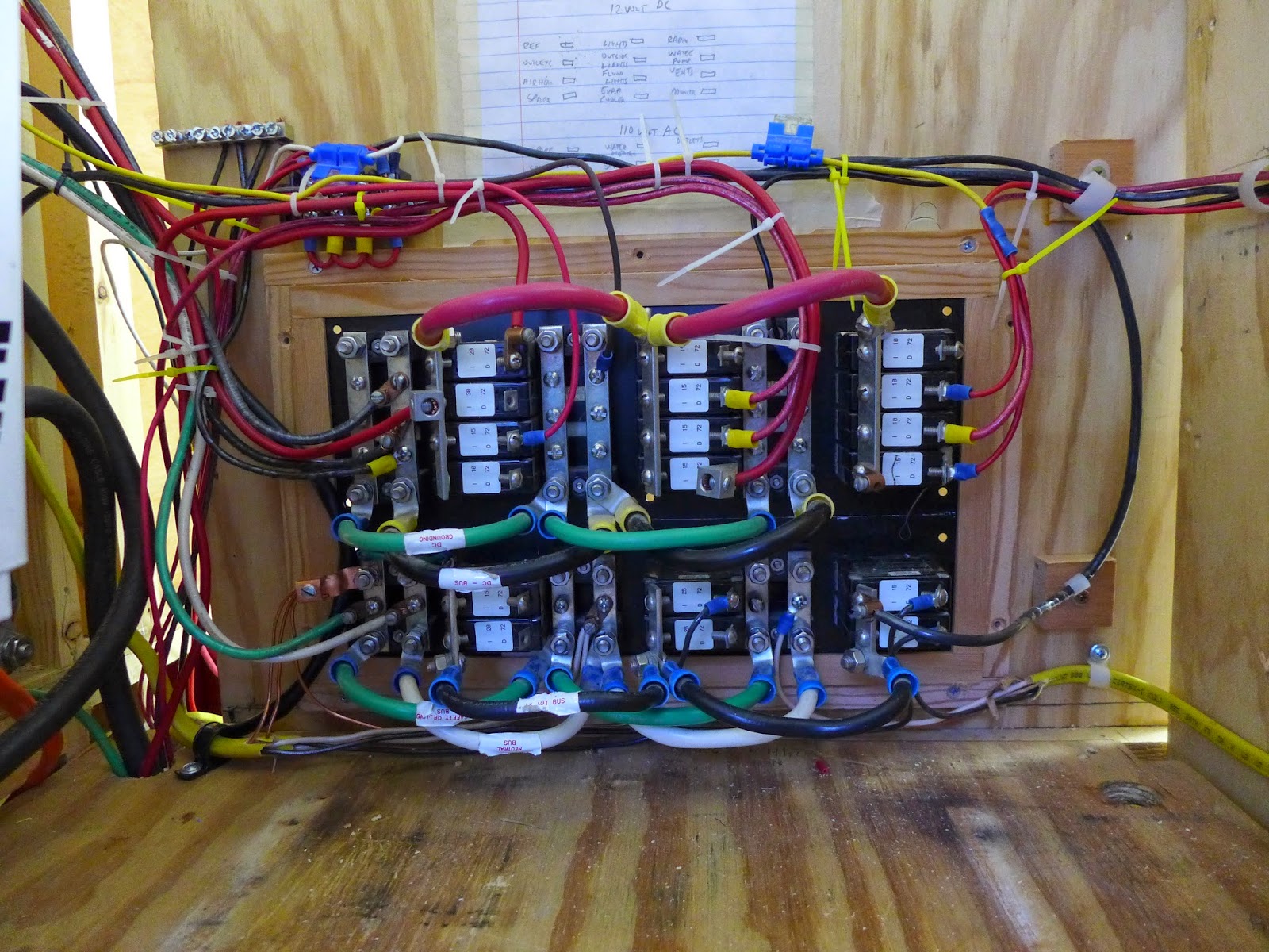

As iffy as the wiring was . . .
Look as if the biggest problem was that it was done by someone who didn't know they'd invented cable ties and wire sleeving. Easier to trace, though. ;)

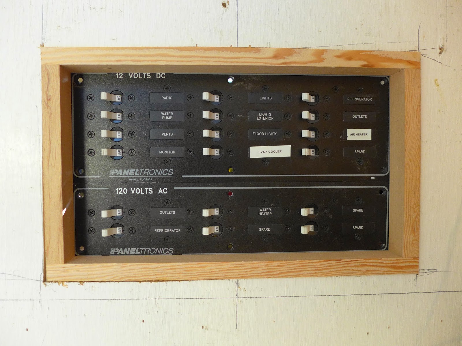

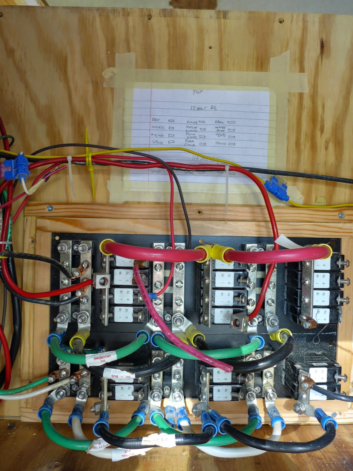

(above) With the major electrical demo done, the breaker panels were relocated closer to the power source... Sharing the inverter / battery compartment...
The inverter was mover over a couple of inches and lowered about the same...The solar controller was treated the same way...I just know that later the new empty space will be needed, and I will be glad to have it...

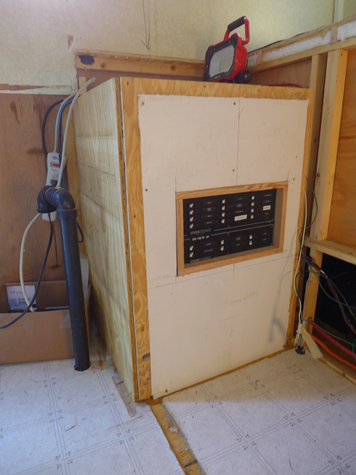

(above) The separate panels were ganged together in a recess mount VG fir case...VG fir will be the predominate wood inside the cabin...The panels are recessed to prevent the switches from being accidentally bumped...The panel case was kept low to open up the possibility of additional storage under the future countertop...
(above) I was gifted more than enough clear VG fir to do whatever I want trim wise on the inside...The first few strips make up the panel case...There is a groove around the fir case that the edges of the panels fit in... Slick...
(above) View from outside, looking into the battery / inverter case...the new panels are in place with a bit of reconnecting of existing circuits done...
(above) Close up of the combined panels and some very preliminary wiring into the panels...

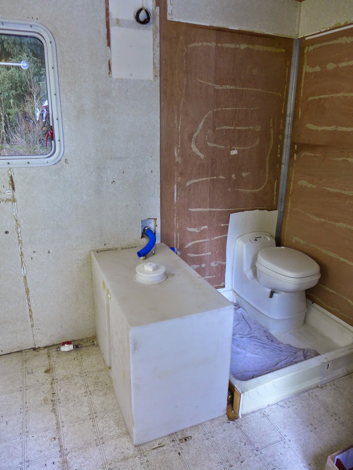

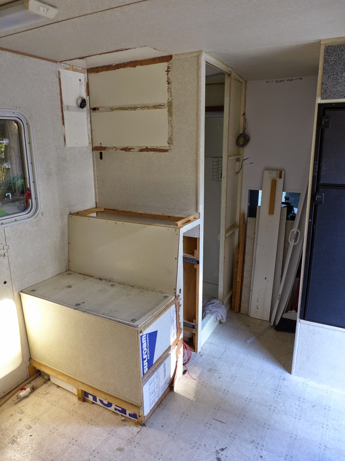

Wiring and plumbing needs to get to the shower/ toilet area, and the existing shower stall and seating are an obstacle to doing that...Besides they are butt ugly and poorly constructed... Every time I look over there I feel depressed that it so funky (in the bad sense of the word)... Time for a change...
(above) Twenty minutes later it is as open up as it gets... I feel much better... Now the whole cabin will be refreshed and hopefully pretty cool, figuratively speaking...
(above) The fresh water tank will remain although it is a bit too tall to design natural height seating around... I need to think about this a bit...

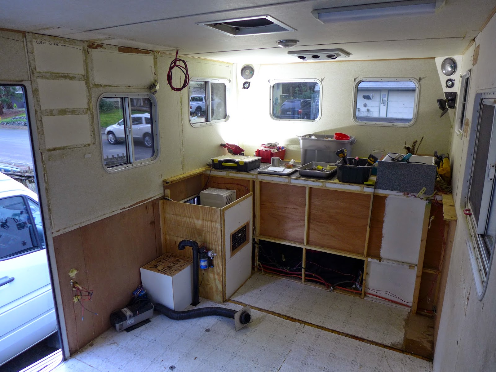

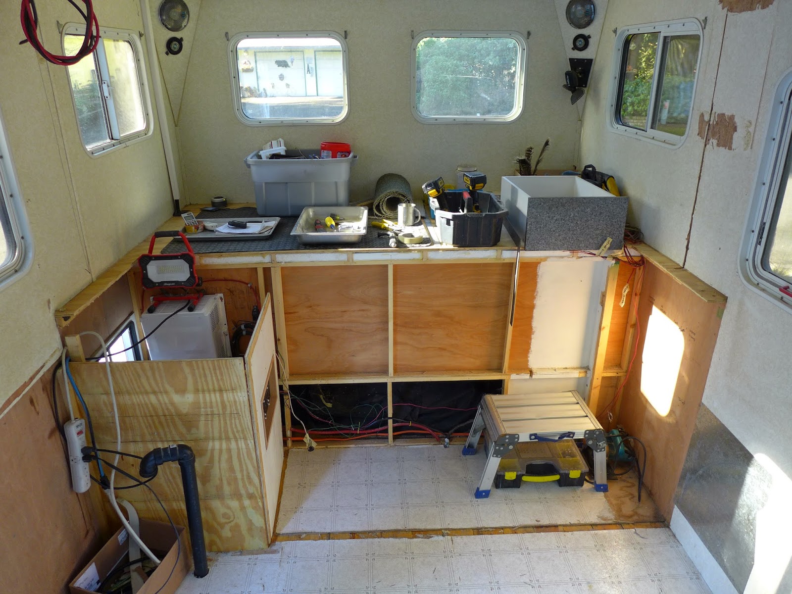

(above) The kitchen cabinet, next to the battery compartment, will be home to the new tankless propane fired water heater... I made a mock up, to scale, plywood cube to help visualize placement...The water pump will be in that compartment as well...The diesel fired air heater is pretty much unmovable there, but I can rotate it enough for the air distribution hose to be un-kinked when finally set...A lot of stuff in a small space, thank you Mike Hiscox for the formal training...!!!...
I am feeling really good how this has come apart and how it will come together...

Do you plan to place the dinette booth on a raised platform, about one step in height?
May I suggest angling the lower section of the bench inward so as to make sitting more comfortable?
Yes that is the way it was before (stepped up). It did sort of separate the sitting area from the rest. This sounds good but I think it took away a bit from the interior flow and roominess. Maybe a different tank? Paul knows best...

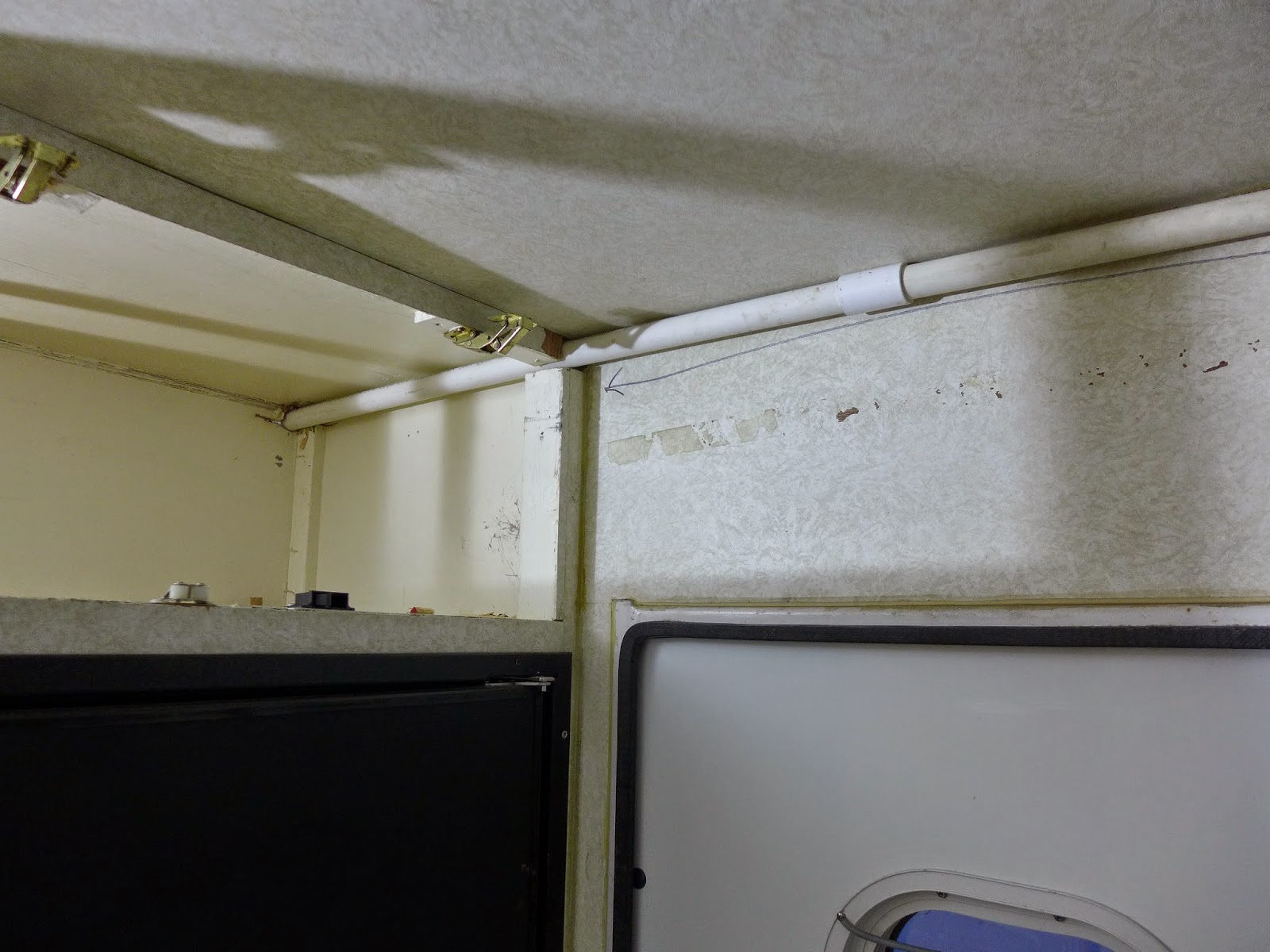

(above) After some more work, it looks like this...Trying not to get to OCD with this stuff, but still make it understandable...

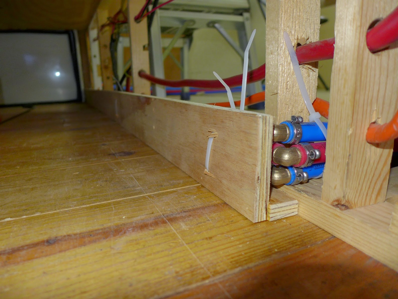

(above) Say hello to waterlines... Protected somewhat from the BBQ and slide in bags...
(above) Simple, fast. cheap...

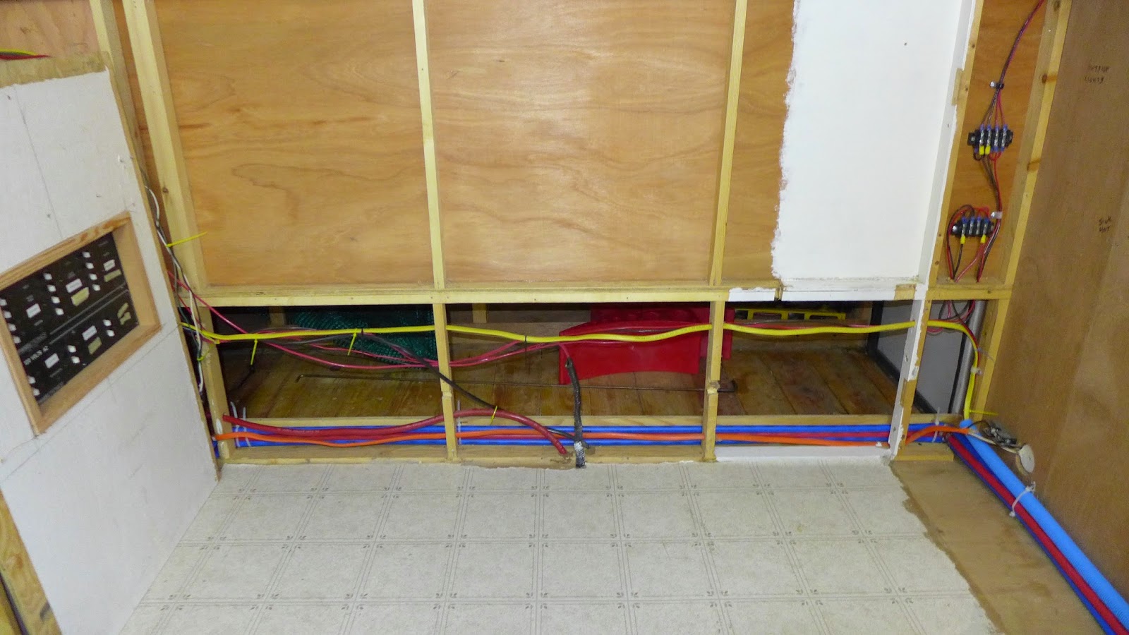

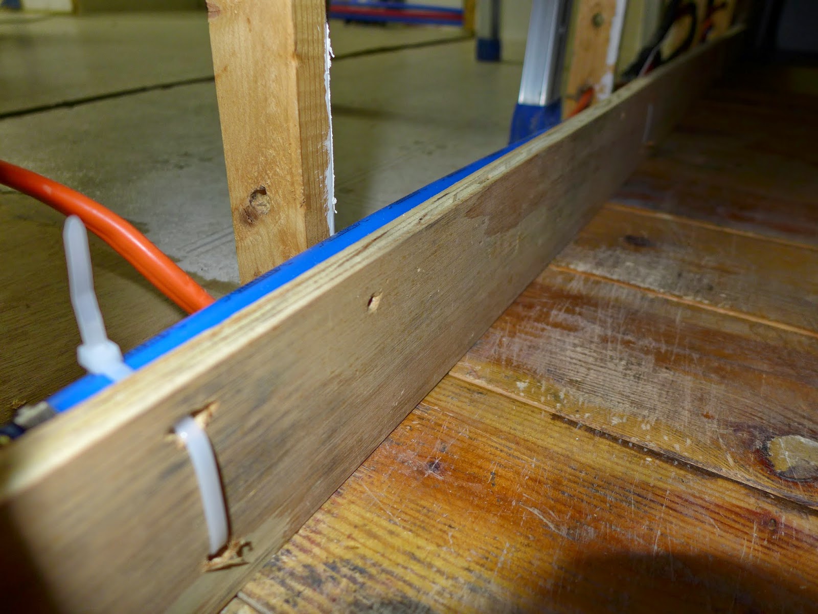

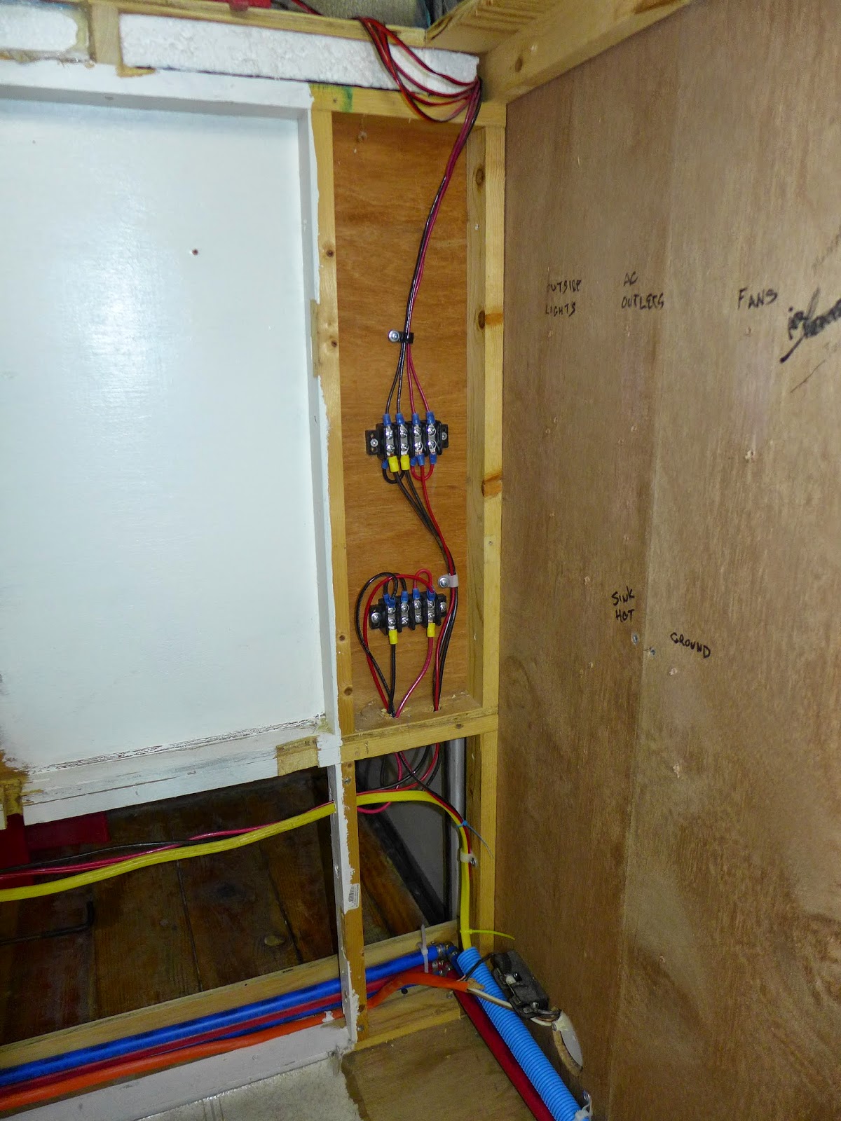

(above) Refrigerator wiring #1 ... Oversize wires to start are a good thing... A splice under the bed, for the fridge circuit maintains the # 8 wire to the fridge... The standard is set...More power, "mo bettah"...Room for expansion later, if needed...
(above) Relocating the electrical drop back here, to one point, just makes sense... The 3/4" wiring chase does too...
(above) Back At the top of the fridge, the conduit continues...
(above) ....behind the fridge, at the top...
(above) Better than before...
(above) Basic wiring and plumbing completed...
