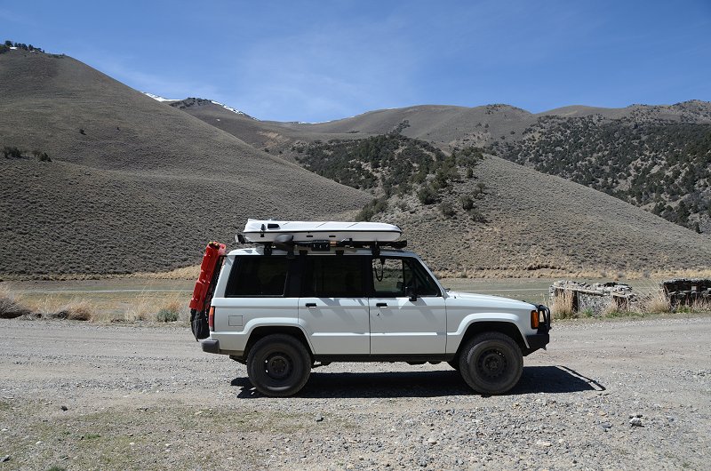

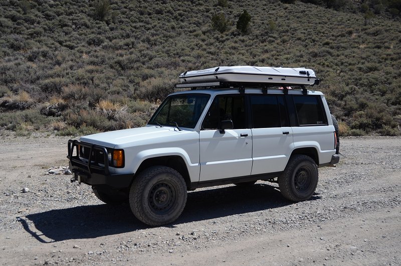

I like to write, and I like to take pictures, and since I have never seen a full blown Trooper build on here with photos and reviews, I decided to put this build thread together.
And for those of you who don't like to read or flip through multiple pages, here's a before and after.
From this:
To this:
I am a firm believer that the key to happiness in life has less to do with getting what you want, and more to do with understanding and eliminating the things you don't. This philosophy leaves you with only good things, good experiences and overall peace of mind. And one thing I know I don't want is complexity. Over the years I have owned a lot of vehicles and driven a lot of rentals. And I always come back to my older Isuzus. To me, simplicity is king, and manual is the way to go. So when I found this base model 1991 Isuzu Trooper S, I was pretty stoked. It had around 72,000 original grandma miles, and was in immaculate condition save for an exhaust manifold leak and a bad thermostat, both of which were easy fixes. I paid $2,500 for this Trooper. It came from the factory with no a/c, no cruise control, manual windows and locks, and a 5-speed manual transmission. Perfect!
Having gone through three other 4-door gen1 Troopers before, finding this one in this color and condition was a true stroke of luck. But I also had to take immediate action before someone else did. Today, most older Troopers you find are in fairly beat up condition with high miles and a grocery list of issues. But there are still some gems out there. In my opinion, early Troopers are an excellent choice for base overlanding rigs. They are relatively small in stature compared to the larger, more common overlanding rigs like the Land Rover Defender and Toyota Land Cruiser, but they have a great deal of cargo space with their box on wheels profile. A gen1 Trooper is definitely big enough for me, my wife, two small dogs and loads of gear.
Now, people generally shy away from Isuzu because they are no longer selling and supporting passenger vehicles here in the USA, that is, if you even remember the Isuzu marque in the first place. Also, Isuzu has a nearly non-existent aftermarket, and that can be intimidating for normal folks who would rather just buy a cookie cutter Jeep off the shelf and pick parts out of a 1000 page catalog. But for me, there are really only two other makes, mentioned earlier, that I would even consider buying for an overlanding rig, and both of those vehicles would require me to take out a second mortgage on my home.
I will admit, older Troopers do have some shortcomings. Mainly, they are slightly underpowered for their size. The 1987-1991 Trooper came in two gas powered flavors: an Isuzu 2.6L 4 cylinder, or a GM 2.8 60 Degree V6. I've owned a few of both, and I can honestly say with 100% confidence that I prefer the Isuzu powerplant over the GM motor. The 4ZE1 is simply put, what belongs under the hood of the vehicle. The GM motor is ok, but I believe the 2.6 makes more power and is overall just as simple and easy to work on once you wrap your head around the spaghetti bowl of vacuum lines. That said, a good clean 2.8 Trooper is nothing to pass up. The GM motor is very common and parts are plentiful and cheap. And while the 2.8 is notoriously gutless, there are some fairly simple swaps that can be done to get you going faster. Either way, I am committed to the Isuzu 2.6.
Another issue that some folks have is the IFS. But to me, a solid front axle is really only a concern if you plan to do a lot of hard core rock crawling. Otherwise, IFS works just fine for general travel and trail use. I won't deny that a solid front axle would be simpler to maintain and stronger in the long run, but I have never had an issue beyond dry rotted or broken CV boots that need changing. So the IFS doesn't bother me at all.
So here she is, a few days after I bought her from the original owner's son out of Chico, CA.

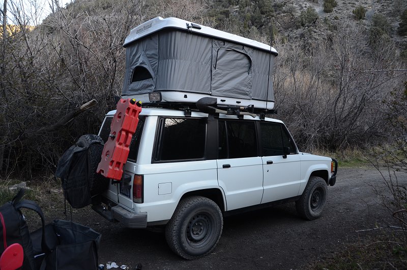

Rotopax 4 Gallon Auxiliary Fuel Containers
After removing my Con-Ferr basket, it was time to come up with an alternative solution for carrying fuel containers. For a long time, I have stuck with a couple tried and true NATO 5 gallon Jerry Cans which I carried on the roof rack. I tried a pair of the ever coveted Sceptre cans as well, and they quickly went up on Craigslist. So once I was faced with having to come up with something completely different, I looked to Rotopax for my solution. I ended up buying two of their largest containers, for a total of 8 gallons of auxiliary fuel. I then used one of their locking mounts and welded it to a custom bracket that holds the containers firmly to my Independent4x rear door ladder.
This worked out quite well. I can fill the jugs without removing them, and take them off just as easily. While I can only carry 8 gallons as opposed to 10 now, it is still better than nothing, and if I ever find myself needing to carry more, I can simply buy another Rotopax extension and another container. Problem solved.
Trasharoo Spare Tire Garbage Bag
This thing is great. It's like a backpack for your truck. I was a bit skeptical of it until I attached it and subsequently loaded it with two nights worth of firewood for the way out, and a contractor bag of trash for the way home. If you have a rear spare tire, and you spend time camping, this is a great addition to any rig. There's no excuse for not packing it out, ALL OF IT.

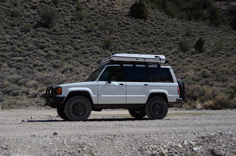

THE ROOF RACK
Custom Roof Rack
I used to run an old school Con-Ferr roof basket. You pretty much cannot ask for a bigger and better roof basket.
However, my desire to upgrade to a primo roof top tent meant the basket had to go, and I needed to make something to suit the tent. I wanted to make my own platform so I could add my existing accessories exactly the way I wanted to. I also planned the rack to re-use the Con-Ferr rain gutter mounting system, which is hands down the strongest way to carry weight on top of your rig. So, after my tent arrived, I was able to plan out and build a platform specifically to suit the tent. I also added custom mounting points for an axe & shovel carrier, front driving lights, reverse lights and a CB antenna. The end result worked out quite well. The roof rack blends right in, and the whole package looks quite nice and tight.
I had a friend with a tube bender make the corner pieces for me, and the rest I built myself out of square and rectangular steel tubing. Here it is getting welded up.
This is the base of the platform before I added mounting points for my lights, axe and shovel mount, and CB antenna.
Mounting points added...
Some test fitting...
Paint...
50” LED Lightbar and 2x Hella reverse lights

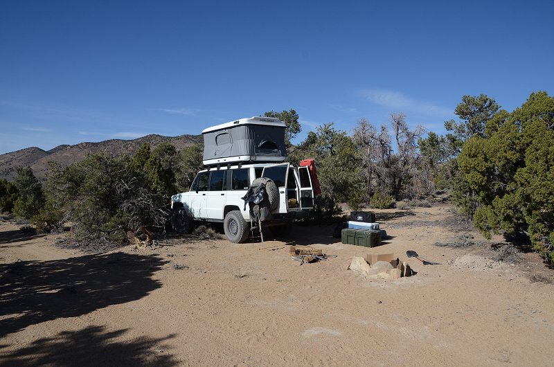

THE TENT

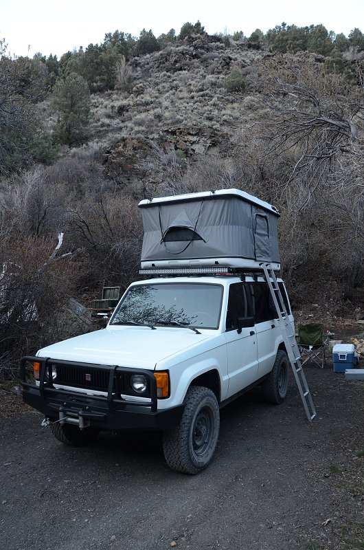

James Baroud Evasion EVO Roof Top Tent
When it comes to accessories that cost more than the vehicle itself, I tend to hesitate. But I have an obsessive personality, and once the seed is planted, I have a hard time beating back my desires. I looked at RTTs for a few years and after careful consideration, I concluded that I did not want a folding type tent. So that left me with only two choices: Autohome or James Baroud. When it came time to commit, I pulled the trigger on the James Baroud Evasion EVO. I chose this brand over Autohome because James Baroud offered a few little extras that appealed to me. So I checked the map of distributors, and gave Tom Herzog at Adventure Ready a call. He answered all my questions, and again, out came the plastic. I waited anxiously for two very long weeks before my tent arrived, only to be wrought with disappointment when my tent came in damaged.
What you get...
Be sure to check the bottom of the box!
Apparently, the skid the tent was shipped on was carelessly broken apart by a forklift along the way, which flipped a board over nails up, and poked holes through the box which ultimately chipped away some of the fiberglass gel coat on the bottom.
The damage...
Truthfully, the damage was not that bad and could have easily been repaired with some filler. But after dropping over $3,000 on something, I was not about to accept any damage. Immediately I filed a claim with the freight company and called Tom to let him know. I also sent him pictures of the damage. Thankfully, Tom hastily and professionally handled the problem, and within a week or so a new tent was on its way to me. So I have to give a big thanks to Tom at Adventure Ready for being a stand up dealer and getting this fixed for me as quickly as possible. Thanks, Tom!

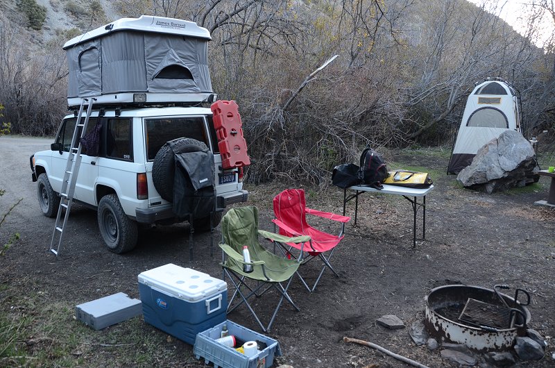

The new tent on top of my Con-Ferr rack after I loaded it up to bring home from the loading dock at work. (shipping to work saved me about $200)
Now back to the tent. There's no bones about it, the tent is heavy and it was challenging for me and a friend to get it up onto the roof platform.
In general I do not think it is really all that much heavier than my old steel Con-Ferr roof basket, but still, it's a cow on top of the vehicle. The mounting system uses three pairs of threaded rods that slide into two integrated rails on the bottom of the tent. From there you button everything up with some flat bars and nylon lock nuts. The tent is on there and on there good.
Opening the tent is quite simple, and having it ready to climb into literally takes less than five minutes. This means you can leave work early on Friday and get some driving out of the way, pull over when you get tired, find a level spot, flip the rear latches then the front latches and voila! Sleeping quarters appear before your eyes. Next, pull out the included aluminum ladder, hook it up and climb in for the night.
No more pitching tents in the dark. No more inflating bed rolls that barely save you from waking up crippled, and you can also say goodbye to sleeping bags if you want. And that's the other nice thing. The tent comes with a 2” memory foam mattress that is contained in a condensation proof, zip off liner. That's the ladder in the middle. Yes, it comes with it's own bag.
So my wife went to TJ Maxx and bought a cheap set of cotton sheets, complete with a fitted sheet for the mattress, regular sheet and pillow cases. Add a down comforter, extra blanket or two, and a couple nice pillows and you have full comfort. What's more, is all of your bedding, as well as the ladder can stay in the tent full time, clearing up storage space inside your rig. You could probably leave your pajamas in there too.
Those elastic cords running horizontally are there to help pull the tent fabric in as you close it up. You remove them while you are inside.
Now I was concerned that the memory foam mattress wouldn't be enough as I am a side sleeper, but I woke up pain free after the first night I spent in the tent. A nice surprise. Hopefully it will hold up and last for many years without loosing any cushiness. The Evasion EVO has three entry points, one on each side and one on the back. This is great for me, because if I am not carrying spare fuel, I can leave the supplied ladder at home and just use my rear ladder for entry and egress. The tent also has a built-in, solar powered, LED light, as well as a solar powered, two-way vent fan.
There are side pockets and an overhead net for stowing gear. The doors/windows have strong and thick Velco fixtures, as well as zippers to seal you up inside and keep bugs and the elements out. Closing up the tent before moving out takes a bit more effort and time, but can still be accomplished in roughly ten minutes. The key to closing the tent is making sure you do it in the proper order. First, you pull the front down using a built in pull strap, and buckle each latch without locking them in place. Then you can move to the back and pull it closed while your camping partner walks around the perimeter ensuring the tent fabric tucks in properly . This task will take a bit more time if you are out solo, but I would imagine can still be accomplished easily with some practice. Once the clamshell is closed and you are sure everything is folded away nice and tidy, you lock the latches in place and roll out.
Driving on the road with the tent up top is noticeable but not overwhelmingly so. The contours of the shell make the tent fairly aerodynamic and wind noise is minimal. So far, I have not noticed a major reduction in fuel consumption, which is also nice. When taking corners, you might feel the top heaviness a little, but again, it is hardly noticeable on the street. On the trail, I feel that my overall awareness while driving on off camber paths will be more acute, fine tuned, and the whole experience will be even more nerve racking than usual. I plan to avoid severe angles even more than I have done in the past. That said, with skilled driving and proper spotting, I think the Trooper will continue to eat up dirt and get me to my destinations rubber side down. If I had to find some cons about the Evasion EVO, or roof top tents in general, there are the obvious things. After several brewskies around the campfire, you have to remember draining your bladder at 3am is going to require a trip down a ladder in a half stupor. So there there's that. And I need to come up with a way to keep my shoes outside the tent before climbing up the ladder. This isn't such a problem in dry weather, but the last thing you want to do is introduce mud and dirt into your bedroom. I plan to make some sort of bag or net where footwear can be stowed just outside next to the ladder. And if you are like me and my wife, then your dogs are family, and go in the tent at night too. For us, this isn't a problem as our dogs are just little buggers. But if you are used to sleeping in your ground tent with your Rhodesian Ridgeback, you had best think twice about a RTT. I suppose I could also complain about the loss of available roof top storage space, but this was a conscious choice, and forced me to get creative. And once you don't need to carry sleeping bags and bed rolls inside the vehicle, you have a lot more storage space inside anyway.
As for the Evasion EVO itself, it appears to be of superb build quality, save for the ABS plastic hooks on the ladder. One of my hooks broke almost right away, which was very shocking. When I got home I did a little research online, and found that this is apparently a known issue with the James Baroud ladders. I was already in contact with OK Auto 4WD & Tire (the US distributor for James Baroud) about returning the damaged tent, and when I told them about the broken hook, they confirmed that there is a repair kit for this problem which they are sending me to keep on hand. I have high hopes that the repair kit turns out to be some nice machined aluminum replacement hooks, but I have yet to recieve the kit. I will report back later with what the repair kit consists of after I receive it.
I was also shocked that the tent was not shipped on a solid pallet or at least with some additional padding. At such a cost, and with such a long way to travel, you would think the tent would be packaged a little better to ensure damage during transit never happens. But perhaps my situation was an anomaly. The only other thing I wish the tent had was a padlock system for the front and back to deter any potential meddling while the Trooper is parked in publically accessible places. You also must take into consideration that your vehicle will no longer fit into standard height garages, and removing the tent is no easy task. So you better be happy with it up there for a good long while. I personally like the way the tent looks on my Trooper. It fits nicely and blends in with the color scheme as well. So all in all, you definitely jeopardize your center of gravity, and you have to part with a hefty chunk of change, but there is nothing better than a good night's sleep in a comfortable, weather proof shelter. So far this appears to be the answer to any and all sleeping and shelter concerns.
