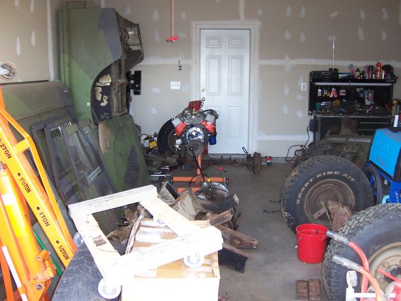

Now starts the disassembly. What fun that is. I am almost done on that. Got rid of the engine, the transmission and transfercase is leaving soon. The Axles are going. What am I left with? A shell and a frame.

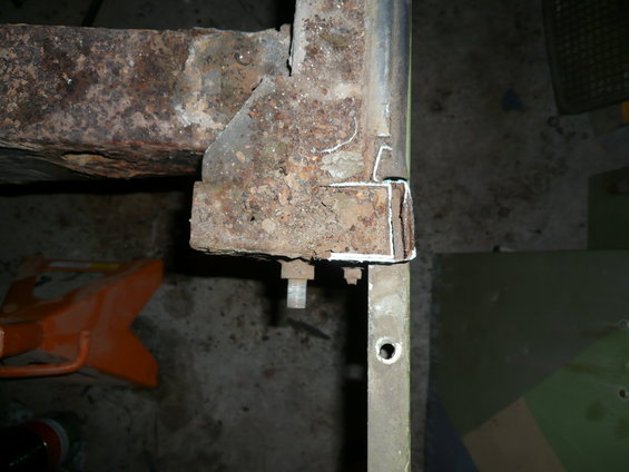

Well i found out why i had to cut the old bulkhead off.
no amount of penetrating oil would have loosened that up.

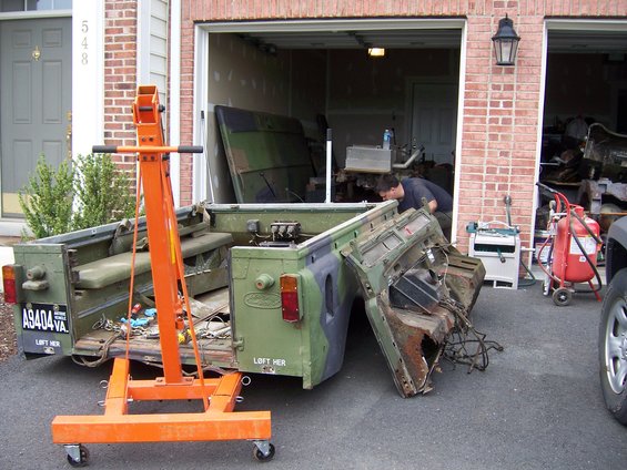

Aside from that, the rear tub is off.
It does not look as bad as i thought it would underneath. The Braces will need a little work, but not as much as i originally thought.

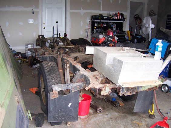

here is a shot of the old frame right before i cut it up (saved the front horn with the serial number though). You can also see the aluminum rear tank.
Looks like i might actually have some room to work.
Just need to get rid of the old frame pieces and the old parts.
One thing i noticed was the rear spring were the 535173 springs (one ton?) (guess that is what the military models got). These are heavy and several clamps are loose (one fell off).
Looking at them, it must have given an unbelievable rough ride. Think i might see if i can save the rears at least.
At least the original shackles look to bee in good shape and i will reuse them (military extended shackles)

Where did you get that fuel tank? Nice big capacity.

That tank seems to be a standard issue on Norwegian Land Rovers from what i have found out.
I will get the info off the tag on the tank tonight when i am home. It tells you manufacture, SN, and fuel capacity.
