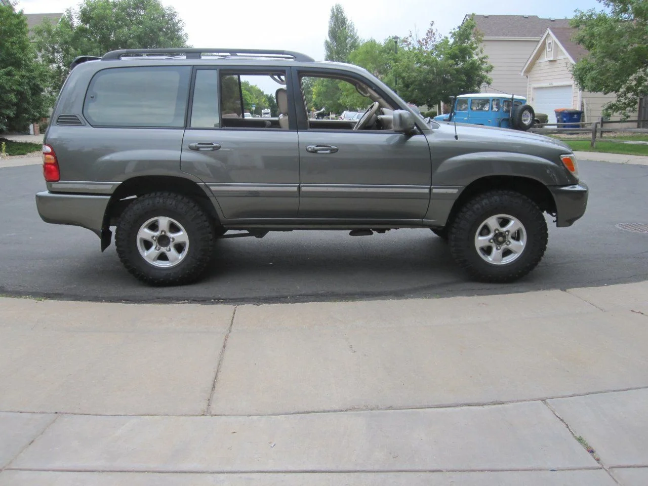

    I bought the 100 series after searching for a clean 60/62 turned out to be a tougher than i thought. I was finding nice clean 60s and 62s but they are starting to fetch big money. That and the fact that I wanted to swap in a V8 and the platform quickly became expensive. Once reality set in on the 60/62 search, I had to decide between the amazing 80 and 100 series. Everyone knows the 80 is perhaps Toyota's all time best off road machine out of the box. But since I already have a lifted locked FJ40 with 35s' and since clean/locked 80's are getting tougher to find, we decided that the 100 series fit our family of 5 perfectly. Our main goals with this cruiser are hauling the family on camping adventures, touring the western national parks, family road trips and sloshing the ski gear to the mountains during our ski seasons.
    We've had the 100 for over 1.5 years, it has a lot of miles but drives like a dream. I'll fast forward my build up to where it is today and update as I add bits and bobs to it along the way.
    Here's where I am coming from, I've daily driven my 40 for over 15 years and I am just the second owner. I built the trailer for camping, back country adventures and hunting. You can see the whole build thread in my sig line. I LOVE THE FJ40! When I drive it still, the world seems as it should be. My kids love it, but we outgrew it... but as the saying goes 40's are only to be sold at Estate Sales. I hope to chop the rust out, repaint it and drive it for another 15 years... but that is another thread.
    And our new to us 100 series, 1999, full options, rear locker, 1 owner.
    And how it sits as of Mar 2017

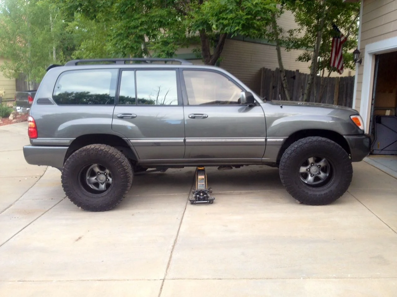

  10. #10
    Join Date
    Dec 2006
    Location
    COLORADO
    Posts
    1,024

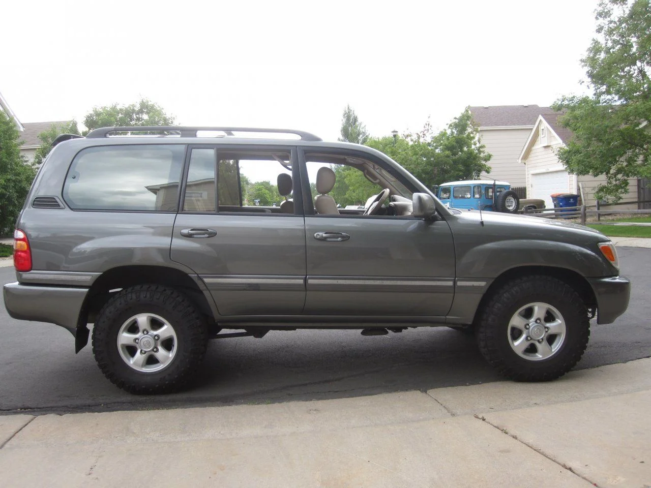

    In the end, reason got the better of me and I decided to roll with a 33 instead. I bought a set of used 285/75-16s off craigslist and mounted them up. After all, I have a FJ40 that is locked with 35s to tackle any trail I'd like, and this is my Daily Driver and family hauler. In the end, reason won. I will likely step up the 35s once these wear out and I bolt up a OEM lift. For now I cranked the Tbars and added a Slee 30mm spacer in the rear. Still rides like factory and it is just enough tire to play here in Colorado.
    Pre lifting the 100.
    Here was my thinking at the time...
    I have gone around and around on tire size, I bought a used set of 315/75-16 Goodyear Duratrac's about a week ago. Then as I got deeper and deeper into the necessary mods to make them fit I got cold feet (for now). So I called up Nakman of Gamiviti and asked to take his 100 for drive to our local club meeting last week. Tim is on 285/75-16's and OME 2.5" lift. I was impressed with the quality of the suspension after driving a worn out factory ride for a year. There was really no power loss on the 285s that I could notice, combine that with the ease of strapping a set of 285's on without NEEDING, spacers, lift, gears etc. I poked around and found a barely used set of 285/75-16 Duratracs locally on CL near my house. These tires only had 4,000 miles on them so I jumped on them, shelved the 315's for now, and tossed the 285's on the truck Friday.
    I will end up with 315's I am sure as I think they fill out the proportions of the 100 better than any other size available. However, for now I will save up for all the necessary goodies to make them fit and work properly. For the rest of this Colorado wheeling season I will the 285's and re access if I NEED the bigger tires for the trails we run.

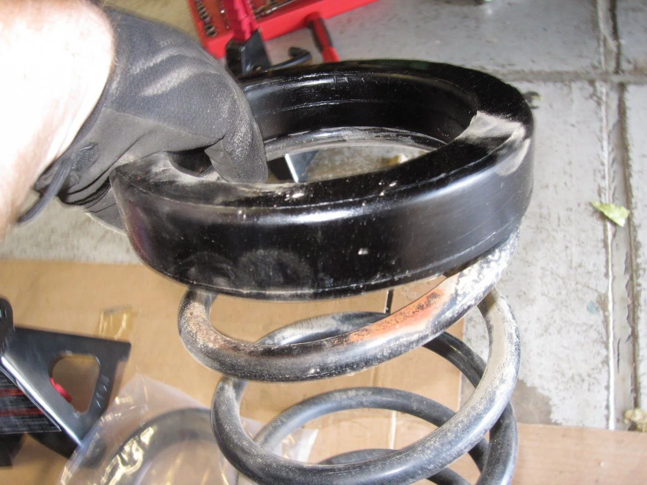

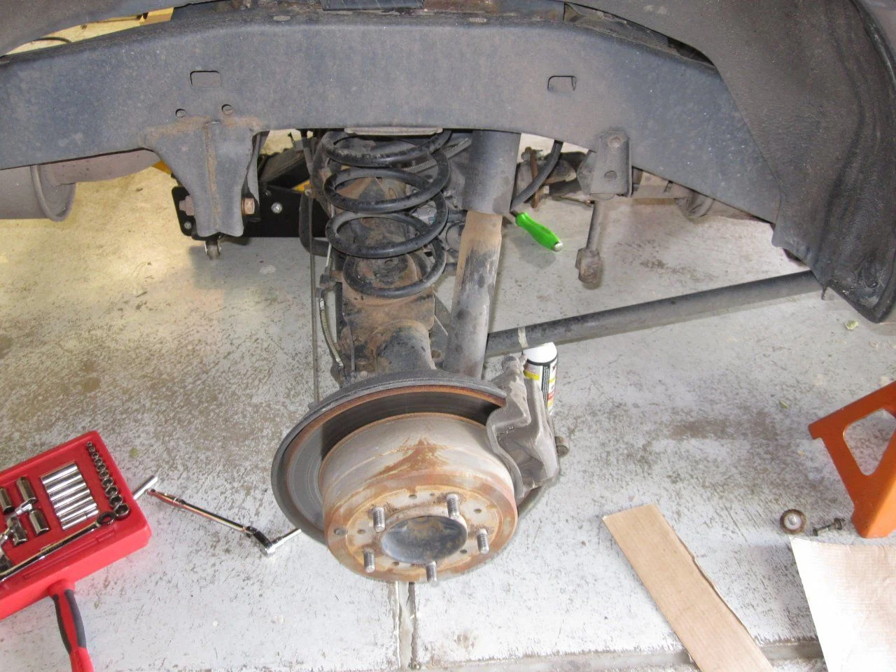

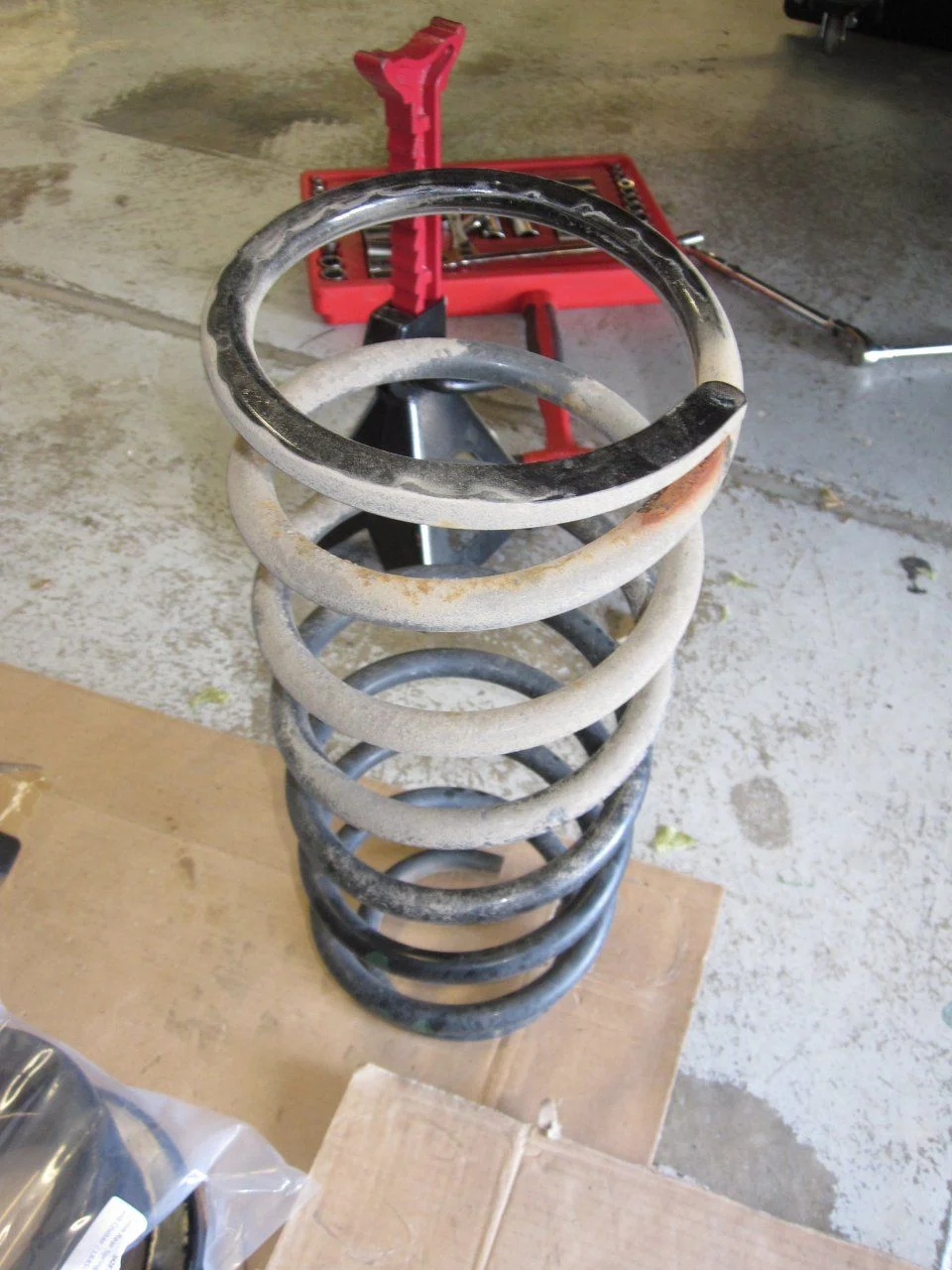

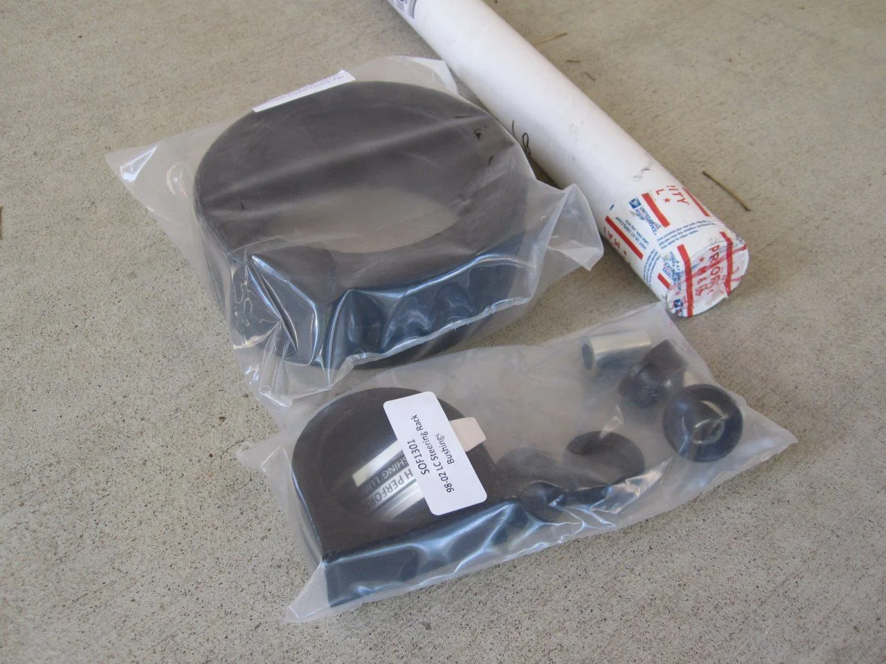

    For now I plan on adding a 30mm Coil Spring spacer to the rear coils and adjust the front torsion bars to match, align it and run it!
