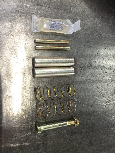

Now that you have a beautiful and clean Running Gear, it is time to reassemble your Hi-Lift. Open up your Hi-Lift Fix-It-Kit, and layout your parts. I find it easiest to do each runner assembly individually so I don't have to second guess myself on whether I oriented the Climbing Pins correctly.
Grab one of your Climbing Pin Springs and install it in a runner location. Now install a Climbing Pin in the same runner that you placed your spring. Be sure to orient the Climbing Pins with the beveled edge facing towards the top of the jack!
Take your new Cross Pin and install it. The Cross Pin must be installed below the spring, and not through it! You want the spring to press against the outside of runner and against the Cross Pin, which forces the Climbing Pin into the upright holes. Grab the base of the spring and compress it towards the palm of your hand. It is easiest to install the Cross Pins from right to left, the opposite of removal. Slide the smooth section of the Cross Pin into the Climbing Pin until it reaches the knurled section. Tap the Cross Pin with your punch and hammer, verifying that both sides of the spring are contained by the Cross Pin. Center the Cross Pin equally on both supports. It must be centered on the supports, which may mean it is not completely centered in the Climbing Pin, this is OK.

The safety feature built into every Hi-Lift, the Shear Pin, is designed to break if the Hi-Lift is subjected to excessive weight beyond its capacity but will not drop the load if the Climbing Pins are engaged. Grab your two 1/2" wrenches and remove the Shear Pin. If your Shear Pin is bent, you may have to use your punch and hammer to tap it out. Install the new Shear Pin included in the Hi-Lift Fix-It-Kit and tighten.

The rebuild kits are cheap enough and if it makes them work better then these jacks could use all the help they can get. I wonder if these kits fit the other knock off brands? I've had good luck with them. One more question. Is the shear pin just a nut and bolt? I may at least make sure I have one of those in the rig.
I Leak Oil
Funny, I was at TSC today and noticed they carry the Reese farm jack rebuild kits and wondered if they would fit a hi-lift. But at less than $6 not sure if I'd WANT to use it. As far as the shear bolt goes (notice hi-lift doesn't call it a shear pin) I doubt it's a standard bolt. Most likely it's a specific material, sharp undercut at the head and waisted just right at the threads.
RyanHeller
The rebuild kits are cheap enough and if it makes them work better then these jacks could use all the help they can get. I wonder if these kits fit the other knock off brands? I've had good luck with them. One more question. Is the shear pin just a nut and bolt? I may at least make sure I have one of those in the rig. Here is the rebuild kits for sale. http://www.4wheelparts.com/Winches-...pcfon=1&gp=1&gclid=CNq0x9_ch84CFQyGaQodLbcHvQ
I can't specifically say whether or not the rebuild kits fit a knock off brand of Hi-Lift. We haven't ever sold, or recommended someone buy a knock off brand for this reason, and many other reasons. We also don't recommend installing a non Hi-Lift brand rebuild kit on a Hi-Lift. I don't trust the tolerances or materials on the knock off brand climbing pins. A Hi-Lift jack always gets a Hi-Lift rebuild kit. The cost difference between a Hi-Lift rebuild kit and a knock off kit is so minimal, there is no reason to trust your life or rig to a potentially inferior product.
In regards to the shear bolt, there are no head markings on any of the kits I have installed. I can only assume that the bolt is Grade 8, because a 7000lbs. shear strength that Hi-Lift states, coincides with the shear strength of a 5/16" Grade 8 bolt. The grip range of the shear bolt is also very specific to not have any of the forces or rotation happen on the threaded portion.
