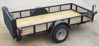

Have a Big Tex 5X8' for the dirt bikes, have had it for 15 years...has been bomber. Only paid a $1000 for it brand new. Can get about any size you need.
Like the round tube top rail over cheaper angle iron versions. The round tube has better torsional stiffness. Be a good mounting point for truck bedside tool boxes.
The only thing I had to do it was, the center mount jack barely cleared my tailgate when open...removed that, and I welded on a jack that rotates out of the way.
If you want a smoother ride over leaf spring, sure they can install a set of Timbren axles on it for a hell of a lot less than what that AT cost. Or do a torsion axle.

We have similar setup, I run a Wildernest on a Tacoma...that size trailer seems about right for offroad. Have dragged it many a place.

I like this price point much better. I should start looking for a used trailer and change out the axle. That timbren set looks really nice but the ural is heavy on the bike side and light on the sidecar side so no way to evenly load it. That is unless I put a tool box on the side car side.

Those little utility trailers come up on craigslist all of the time. Should be able to find one a bit under $1000. Those AT's are nice and all....but man, that is half the cost of another Ural!
Have some riding buds that have the Torsion Axle on theirs, fairly happy with it. You may not even have to change the axle...get one, use it and see how it goes. I find just driving a bit slower when in the dirt helps a bunch.
I would put the tool box on the sidecar side, help balance it out. I used to carry my bike on the one side instead of the center...mainly a lazy way so I don't have to jockey it from the center chock when we would load up a buddy's bike if we were car pulling. he live 30 minutes away...over a couple years of doing that. Noticed the one tire wore out a bit faster. Trailer didn't pull all that much different...though that bike is only 250lbs. What do those Urals weigh, about 700 lbs or so?

Looks almost exactly like the trailer I have.
Bi-Fold ramps are nice too, so it isn't such a parachute back there.

I run about with mine on a Kendon dual folding trailer with the torsion bar axle flipped. Plenty of clearance and very light but rides extremely well. Not much room for extras though.
My other trailer is a military one with independent suspension and a 40 gallon diesel tank underneath. The trailer only weighs 1200 lbs but can carry another 3700 lbs (enough for a CJ or Suzuki 4WD).

The key is finding a trailer wide enough. I had a 5 X 7 trailer and had to put 2 x 6 boards on the floor so the Ural would clear the side rails of the trailer.

I found a used alumalite atv trailer and mounted a heavy duty wheel chock. Worked out well but only because I have a winch to load and unload with.
