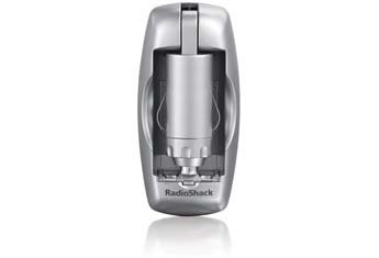

I only do AA rechargeables, but I use them a lot. I have one of these that I got years ago at Radio Shack for 3 bucks. Works fine:

This is what I was thinking about, thanks for the push in the right direction.
IdaSHO
IDACAMPER
One tip....
Any time you have a device like the one pictured that uses a "brick" transformer.
MANY utilize a DC output of 5V or 12V
What that means is that you can snip the wires from the brick, and direct wire them up to USB (5Vdc) or 12Vdc outlet like a cig lighter.
