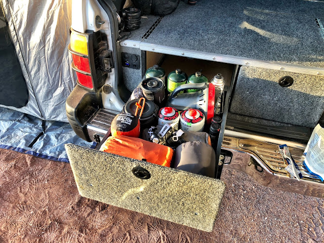

The drawer system has given no hint of trouble. I only wish I used a lockable set of sliders on the stove/sink drawer. If the Nomad is parked a little nose heavy the drawer has a tendency to slide back in, not something you want to happen with a hot or burning stove element.
Many meals have come out of this set-up, along with a lot of dishes washed. I've installed another utensil drawer just beneath the stove/sink pullout for easier access to cooking tools.
