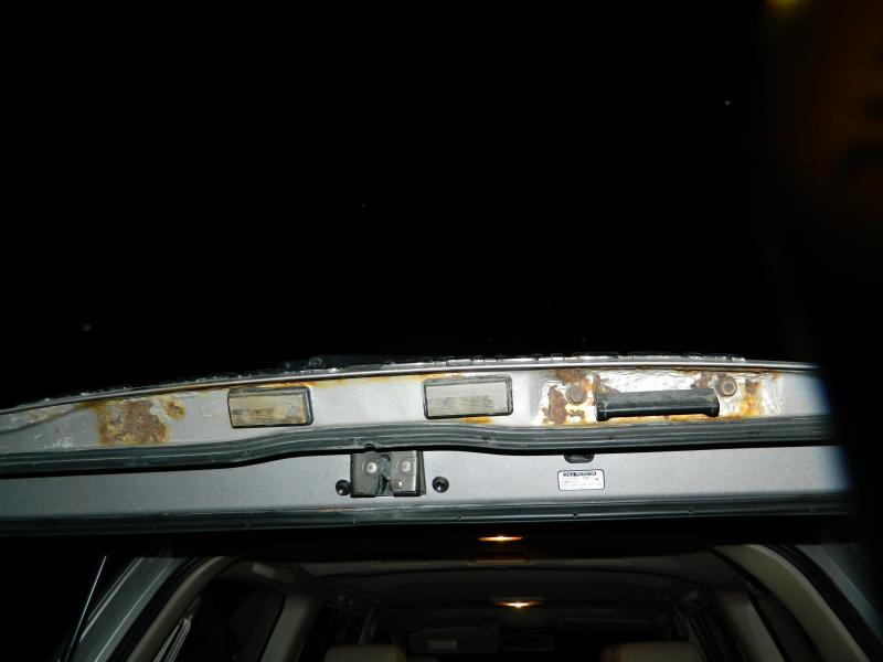

MarcFJ60
Looks really good. Check for rust at the bottom/under the upper tailgate. Not sure why they rust there. I know there are drain holes but maybe they get clogged or just don't get all the water or it is a gasket issue. May not be an issue in Seattle.
