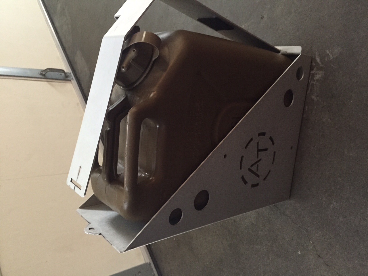

Considering how fuel thirsty my 2005 Tundra is, I only get about 400 - 450 kilometer range on a tank of fuel. I'm planning to pick up 3 of the good 20 liter (5 gal) Scepter military fuel canisters and 1 20L water canister. However, I'm going to need a way to mount them in the box of my truck. I want to put them in pairs, behind the wheel wells near the tailgate.
I can't seem to find any jerry can mounts that fit these canisters though. All I can find are ones that fit NATO spec, which from my reading is different and won't work (eg. Frontrunner's description says theirs won't work).

NATO jerry can holder OUGHT to fit a Scepter MFC. That's the whole point of milspec. Are you instead referring to Scepter's 'civilian' fuel and water jugs with the smaller black caps that look superficially like their MFC and MWCs? Because those are trapezoidal, fatter at the bottom and taller and thinner at the top and certainly do not fit a NATO jerry can dimension holder.
I built a snug fitting plywood box to socket (3) MWCs into, but as it was going in the back of my Suburban I didn't make any provision for locking them in. Although I did outfit it so the jugs could be lashed down with a ratchet strap - http://forum.expeditionportal.com/threads/135929-Jerry-Can-MWC-MFC-stowage-box-build
The problem with the metal mounting brackets mostly comes down to the shape of the corners. They're more rounded, suited to the metal jerry can shapes. And the squarer bottoms of the MFCs don't quite fit.
There are lots of aftermarket metal strap type carriers, which lock, and which typically have a squared-corner cage design which fits milspec MFC and MWCs just fine. You're going to have to ask each manufacturer directly and just google for some discussion topic somewhere that has more autism.
I would suggest googling specifcally for "scepter MFC mount" and looking at image results to find mounts that specifically show the plastic Scepter MFCs / MWCs in the holders and then backtrack the makers from there. If you just look for 'jerry can mount' it's a crapshoot that they'll work with Scepter MFCs / MWCs

I ran into this problem. I have several (10 I think) dual milspec Scepter can holders off of MRAPs. I thought I'd buy a gas version at COSTCO as I had plenty of diesel Scepters. Got it home and discovered it's wider than the milspec ones and won't fit the holders. Now I'm back to looking for some gas Scepters that will fit as I traded my diesel F250 for a gas Titan.

well Hell, say no more and get busy. You can make exactly what you want / need. Two side by side is going to be wider than your wheel well and impede your ability to haul 4'x8' sheet products in your Tundra bed, if you do so. Maybe single holders placed before and aft of each wheel well?

The Baja rack scepter can holder is perfect for two of them. Military type. I have a Front Runner RR and just drilled different holes to allow it to mount. It is lockable and you could, of course, bolt it to the truck bed with the standard holes. I have since reverted to carrying water bricks (3.5 gal available thru Amazon or Sportsman's Guide) behind my seats as it puts the weight lower and lifting a 5 gal water or petrol can off the roof is getting a bit annoying for my 71 years.

man, these things got heavier. Here's a few pics to illustrate the problem. The 'civilian' version AREN'T taller as I recalled. They are certainly much fatter / wider in the bottom.
They screwed up my storage box plan. Thought maybe with the trapezoidal shape I might get by with flipping one around, but no. Not even close.

fore and aft would also leave the central area open for bulkier cargo, or other outdoor gear or even sleeping in the bed.
Guestimating your wheel tubs are about ~9-10" wide at the bed floor, with the curve at the top maybe forcing the cans inward towards the centerline. So that puts the can and mounts projecting inward about 4-5" into the central part of the bed. That would narrow the central bed area down to about 39"
Too, have you checked the Tundra bed height against the height of the jugs? Did a timing belt change on my neighbor's Tundra and I wasn't paying real attention to it but the bed struck me as kind of shallow compared to my C-10. There are several interesting designs for can holders where the cans lay back n their spines. And that might also work well for piling in other cargo, depending on what sort of gear you haul.
