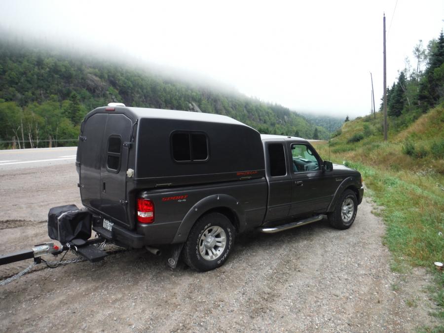

the main issue with low profile unit like cowboy, eureka etc is they are less aerodynamic than a cabover camper so end up costing you more in gas vs a well design small cabover.
One very good option you could find used in canada and also in usa closer to the northern border is a spacekap.
a lot profile like this can be a very good start to build custom interior design
http://www.therangerstation.com/forums/attachment.php?attachmentid=17565&d=1420916323
i myself got the version with the cabover that is very well design aerodynamic wise...and the penalty on the truck is less than 1-2l/100km.... or perhaps 1 mpg. could perhaps be a starting point
when it come time to put interior shelf etc...fiberglass is actually a very easy material to work with. you can glue wood stip as reinforcement before screwing and it will be very strong. if you break something....repairing fiberglass is easier than most material... it s very forgiving
