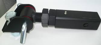

Are those two pieces pulling apart or is it what they are now shipping??? That is strange looking.
I have an older yoke but the trailer piece with red bushings is like this one with a very small gap between the two pieces:

I can only assume I have the fourth gen, as stated I was never able to get in touch with anyone. Not even a bot, auto reply of thanks for contacting us, your email has been received etc. I assume it's the latest ver based on the casting mark or whatever that is on the top of the square tube in the limited amount of pics I've seen.
As far as the piece pulling apart that was my initial question for cu offroad. It free spins 360* but I have only seen pics online of an older design with no gap thus I was freaked out. I've been checking it before and after every trip and while the gap hasn't gotten any wider their super special polyurethane bushing continues to fail after less than 5 trips of a total of 3k or so miles. No water crossings, no mud, always greased. Just rain, dust and dirt :rolleyes:
