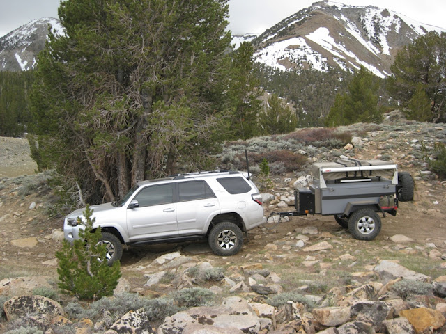

Well, I don't get paid to be out on the trails although I do get out quite a bit and take the time to write about it on my blog: http://suntothenorth.blogspot.com/
I'm still behind on finishing the write-ups for 2018.... but in case you were concerned I was merely a member of the Expo Chair Force I pasted a few pictures below.
