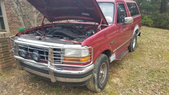

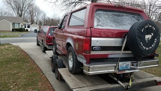

Long story short I don't do trucks. I'm a lowered car guy that is sick of standing around parking lots. To be fair I traveled the country in my teens, including 11 days and 90+ miles remote hiking/camping at Philmont Scout Ranch in northern New Mexican Rockies, Sierra Nevada trips with Scouts, many miles on the Appalachian Trail covered, and I consider myself to by a conservationist and practice leave no trace camping. I want to extend my knowledge to some overlanding adventures with pals. My wife has always told me she wants a Bronco, ideally a 1st gen. I grew up in the 90s and the newest vehicle we ever owned was my dad's '95 F150, so OBS Ford does all of the good nostalgia stuff to me. We settled on an OBS Bronco (that I think I got a steal on).

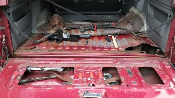

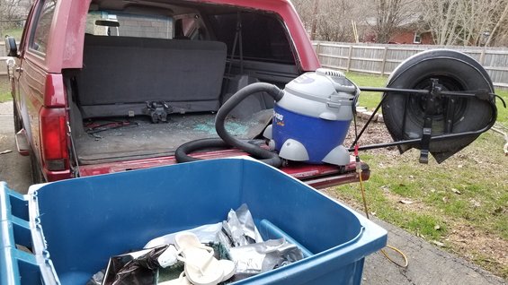

It runs and drives, 4x4 high and low both work, heat and AC do as they should, the interior is 90% together, but the back window is busted out, has a power steering leak and the rear spring hangers disappeared years ago so the spring has been riding on the body long enough to cause some serious damage. It's really not that bad compared to other trucks I've looked it.

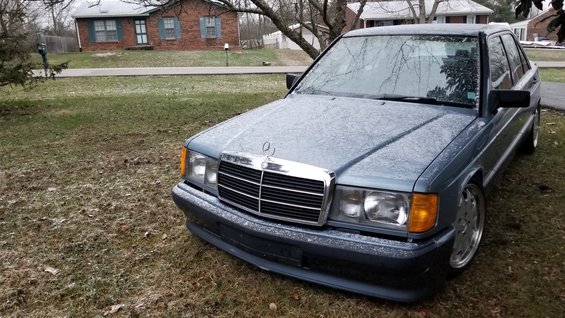

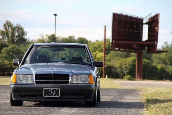

Here's my commuter, I'm pretty proud with this one:
jeep-N-montero
Rust is going to be the biggest headache with your project, but you seem like you know what you are doing. Loving the Benz, part of me has always wanted to find a mint older diesel for a daily driver.

If the previous owner was driving around with the spring riding on the body I would not be surprised if the body was not twisted in that corner. Do you know how the back window got broken? You already have some big rust holes in that body; removing more material for fiberglass fenders will make it weaker. You might want to run some braces in key spots to reinforce the body. Broncos are known to develop cracks in certain places from all the flexing.
Amen on the cracks. Seems like that is all I have been doing is fixing cracks and internal bracing to help them. A pillars both sides at the top of the windshield, B pillars both sides, rain gutters and roof seams So far that is all I have found. It gets worse if you add any kind of roll cage or do a lot of flexing. It took a long time and a lot of research to decide how I wanted to cage mine. Decided I am setting the body on poly mounts in factory locations, bet money your body mounts are shot and rusted. Going to allow the body to float around the cage, no floor flanges or body tie ins anywhere. Cage legs will pass thru sealed opening in floor and attached to the frame with poly bushed outriggers. Yes it means a smaller caged space, like a cocoon for driver and passengers. Have to allow enough room for body to move without hitting the cage. Seats have to be tied to the cage not the floor.

Thanks guys! I understand the headache surrounding the rust, that's why my game plan is to get the truck on it's feet, then fix the rust in the rear of the truck before I start modding. I have the LMC catalog to order replacement panels (I'm a believer in stamped sheet > welding in some angle). I've thought about doing a rear cage to pick up new seat belt mounts, floating the body does seem like the safest option at this point. As far as the structure in the rear, I'm going to build a frame for a drawer system out of 1" square that I'd like to bolt into the floor, as well as side to side. I think this should make up for the lack of metal bedsides.
The rear window was busted out so a thief could get some free subs. Finding free audio equipment is awesome.
