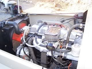

The original F engine came out and a rebuilt forklift Toyota F engine went in. I drove it like this for 5 years when I burned an intake valve and decide to replace the F with a 1973 F.5 or Transition engine. The refirb grew out of the engine swap.

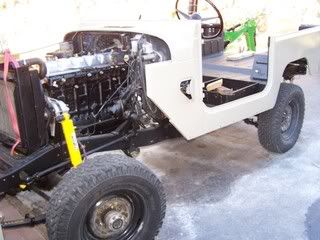

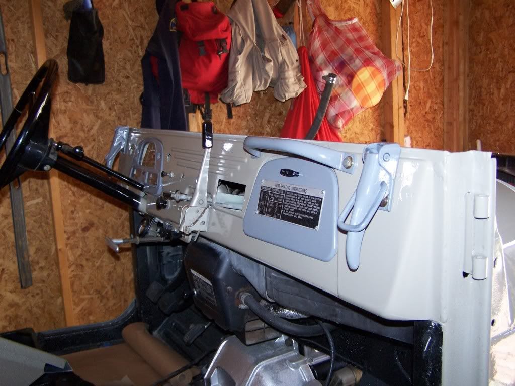

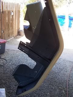

I pulled the drivetrain (3 spd trans and transfer case), rebuilt the F.5 and cleaned and painted the frame. The vehicle had very little rust so that didn't occupy too much of my time. The interior of the tub was stripped, primed and coated with Durabak.
fireflyr
The body work was finished, PPG primer and Nason's Dune Beige 416 sprayed (in the driveway). I would wait until about 7:30 PM, when the winds died, and the bugs were down to spray. Get a couple coats on whatever pieces were being painted, then move it into the garage to dry. This went on for a couple weeks until I had everything painted.

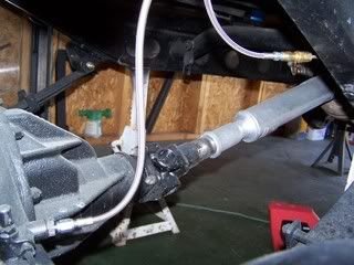

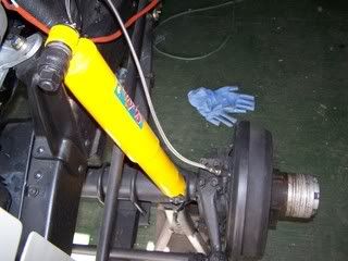

I installed a MAF 4" lift with Safari springs and OME shocks, extended steel braided brakelines (Downey Off Road: RIP:() Jim at Downey was a huge help. He even called a couple times when I was in Montana to verify info. If anyone has dealt with early Landcruiser brakes, they know that sourcing parts can be difficult. Downey will surely be missed.

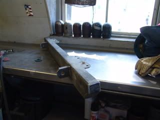

Homemade front bumper:

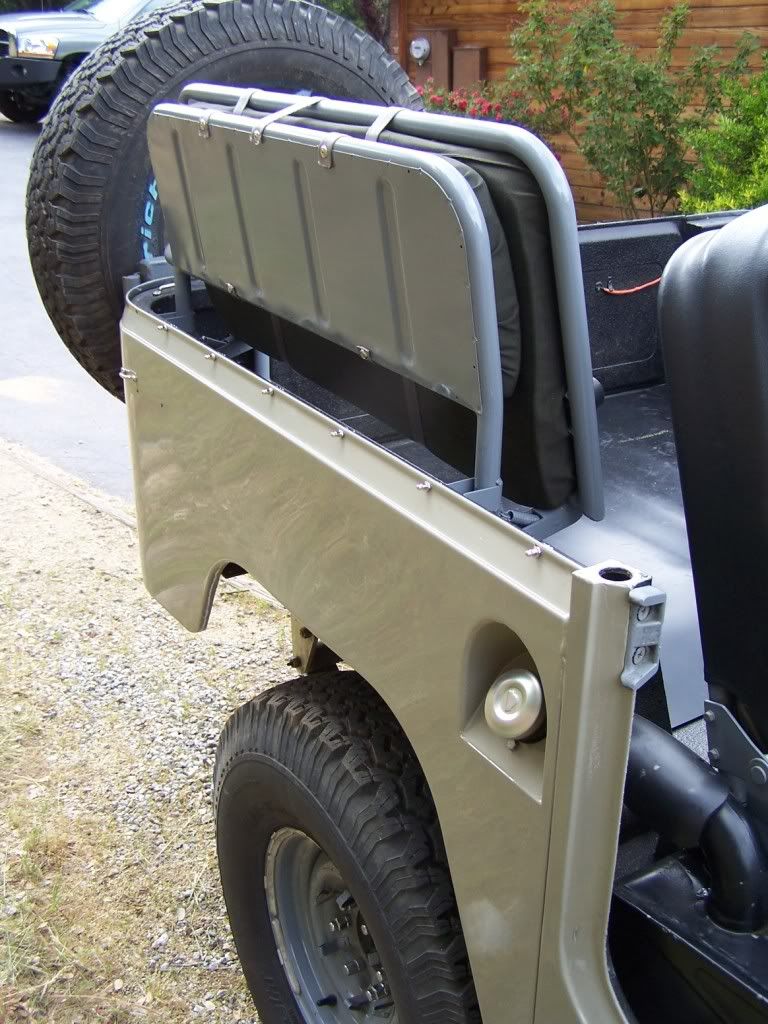

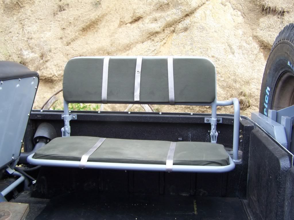

Cheap jumpseat rebuild:

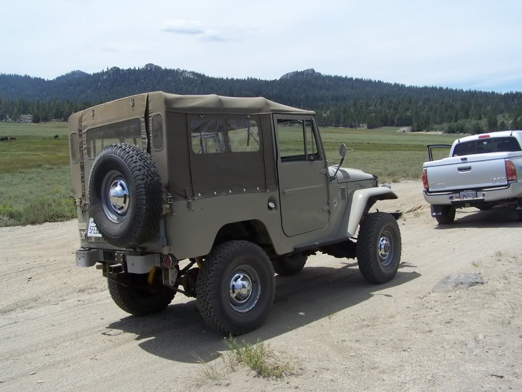

Paki Soft Top install:
I wish I had taken the time to do this during the last year that this all took place. As time goes by you tend to forget all of the problems and solutions that kicked your butt, but the aim was never to "restore" the vehicle, but rather to have a reliable fun 'Cruiser that the family could enjoy. I think we nailed that.:smiley_drive:
Finished Product:
