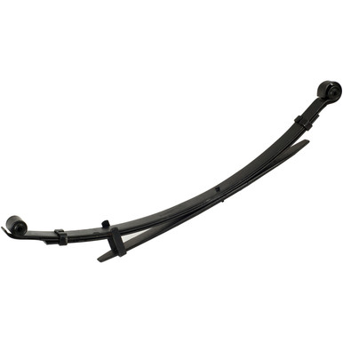

I just picked up a 1987 22re pickup 4x4. It needs leafs. I am going to keep the truck stock height.
I called NWOR, they said the factory that makes them is shut down b/c of Covid. I also called deaver, they will make a custom set but it will cost me.
It seems all the other places only have leafs with a lift.
Any suggestions, thanks

Old Man Emu makes a nice set of springs for the 1st Gen Toyota PU and 4Runner.
Just like Deaver not cheap however a quality product.
If you want stock do not order the heavy duty spring option.

This is the stance of 25mm torsion bars and OME standard duty leaf springs (3 main + 3 progressively thicker overloads) with longer than stock shackles. It's not excessively high and would be at last an inch lower with stock length shackles.
jgallo1
That stance looks really nice. I am really surprised at the stance height. I love OME, I used them on at least 5-6 vehicles. I always ended up at least 2" over stock.

I spoke with alcan about springs, I was surprised at the price they quoted for custom springs. it is not bad. I would not put it in the budget category but definitely alot cheaper than deaver.
jgallo1
I have been curious about General Springs. I have only found one review of there springs and it was so -so. Have you heard good things?

So so, I just threw them up because you were looking for a stock pack.
Personally I would go with the deaver or the OME springs.
It is higher than stock, about 1.5" (no additional cranked in lift, its all higher spring rate) in front and 2" in back. But realize at this point there's some miles (about 7 years old) on the suspension so was also fully settled.

I talked with the guys at Rocky Road today . They said If I cranked my Torsion bars, about 1/2" , with the medium duty OME pack, stock shackles, and Shell, the rear should about 1" over stock.
Every OME pack I have put on an older Toyota has always ended up being about 1" over what the spec is. I am a little leary. I do not want the stink bug look ha ha. The guys at Rocky Road also told me to talk will best deal spring in Utah. They are as expensive as having a custom pack made.
