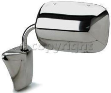

Hey guys. I have a '90 Sub that I am thinking of going from the black plastic power side view mirrors to the standard manual mirrors. Anyone try this or know of any issues?
Also, anyone want to swap? I know the power ones are desired.
These are what I want:

FYI for anyone thinking to do this... be ready to have some body work done. GM permenantly installed a plate with three studs to the inside skin of the door which hold the power mirrors in place. These studs will have to be cut, grinded, all (6) of the holes will need to be welded and grinded, then floated out and prep'ed for paint. I am considering just getting a couple of straight doors (manual mirror doors) to replace my current doors when it's time for paint. The manual mirrors on the other hand just bolt in place... it's nice. :) I will post pics soon.
