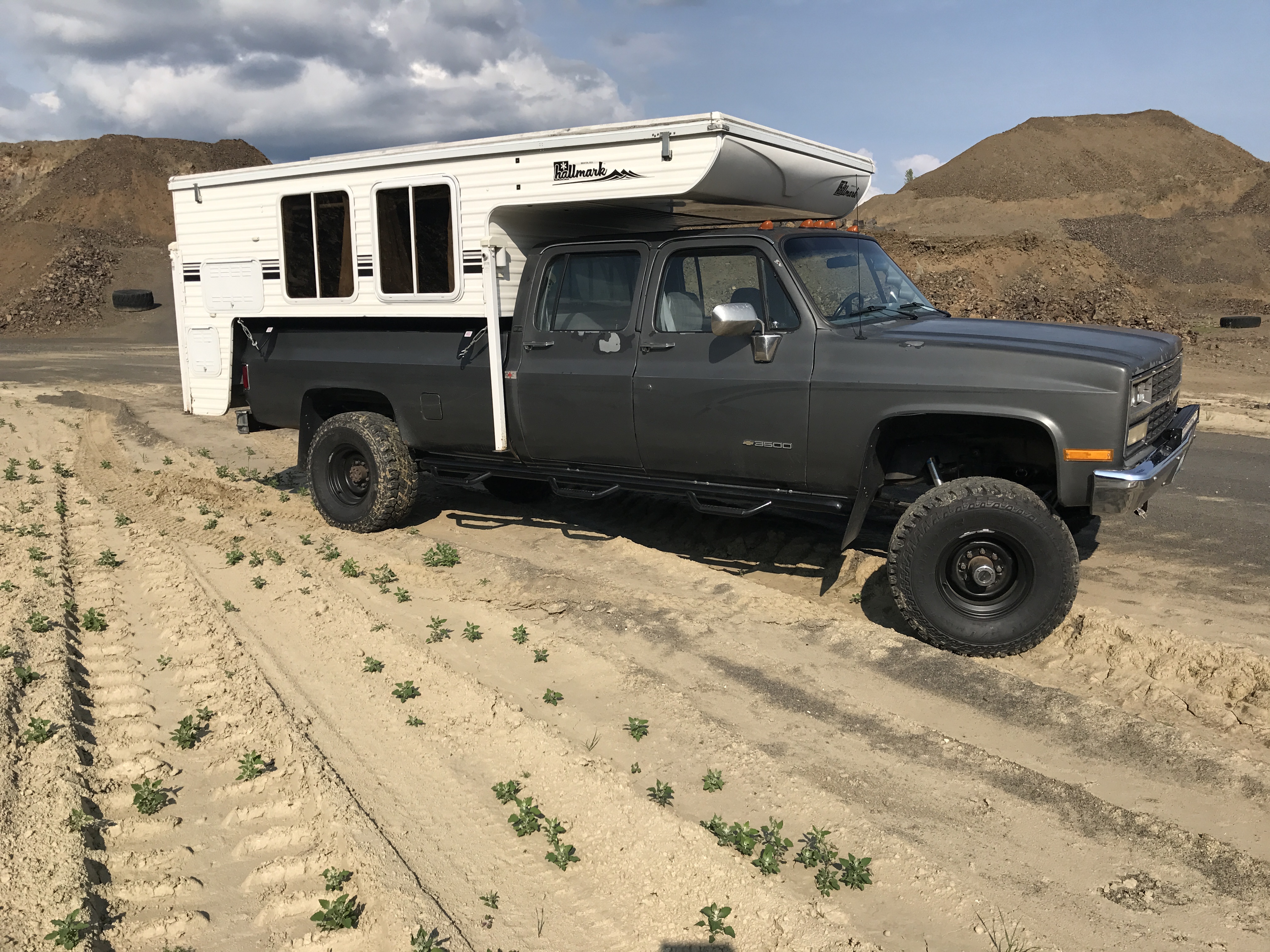

1991 V3500 One ton single rear wheel crew cab 8' bed
Factory 5.7 TBI V8, 4L80e transmission, NP205 with vss transfer case, 14 bolt 10.5" ring gear rear (open), dana 60 front (open) 4.56:1 axle gears

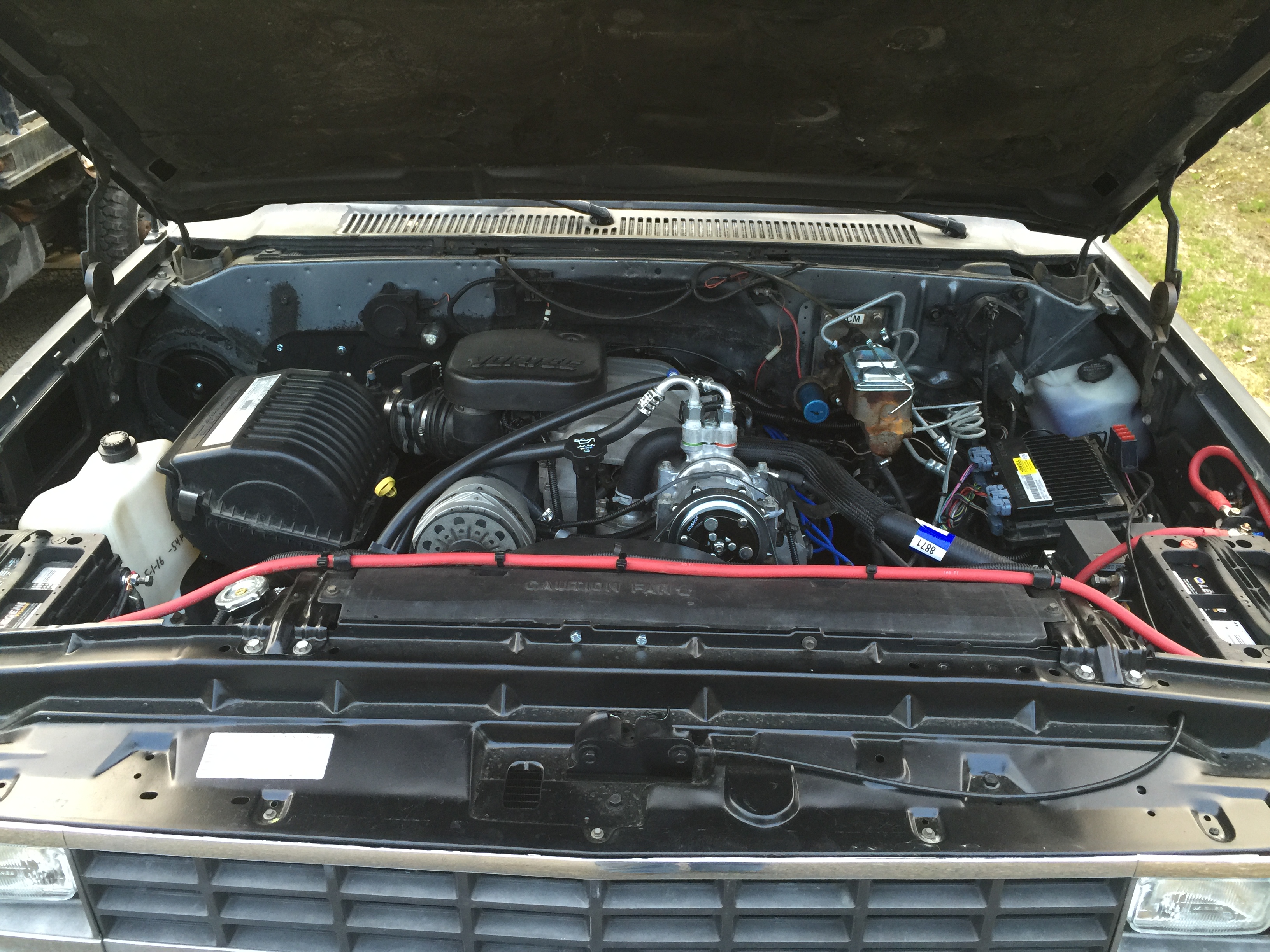

Installed in 2016 rebuilt L29 7.4 MPFI with comp cams RV roller cam, roller rockers, valve spring rotator eliminators, LS1 injectors, billet distributor, valve job, new valve guide seals, thorley tri-y headers, into 3.5" single exhaust with magnaflow catalytic converter and muffler, Howell harness, custom PCM tune. Motor cleaned up with a hone and polish on the crank (by machine shop not me) and received new oil pump, water pump, sensors and probably 100 other small parts I'm forgetting. High pressure pollack fuel selector valve and new GM in-tank pumps for ~60 psi fuel supply. Rebuilt (a couple times 4L80e) and rebuilt NP205. Receipts for everything.

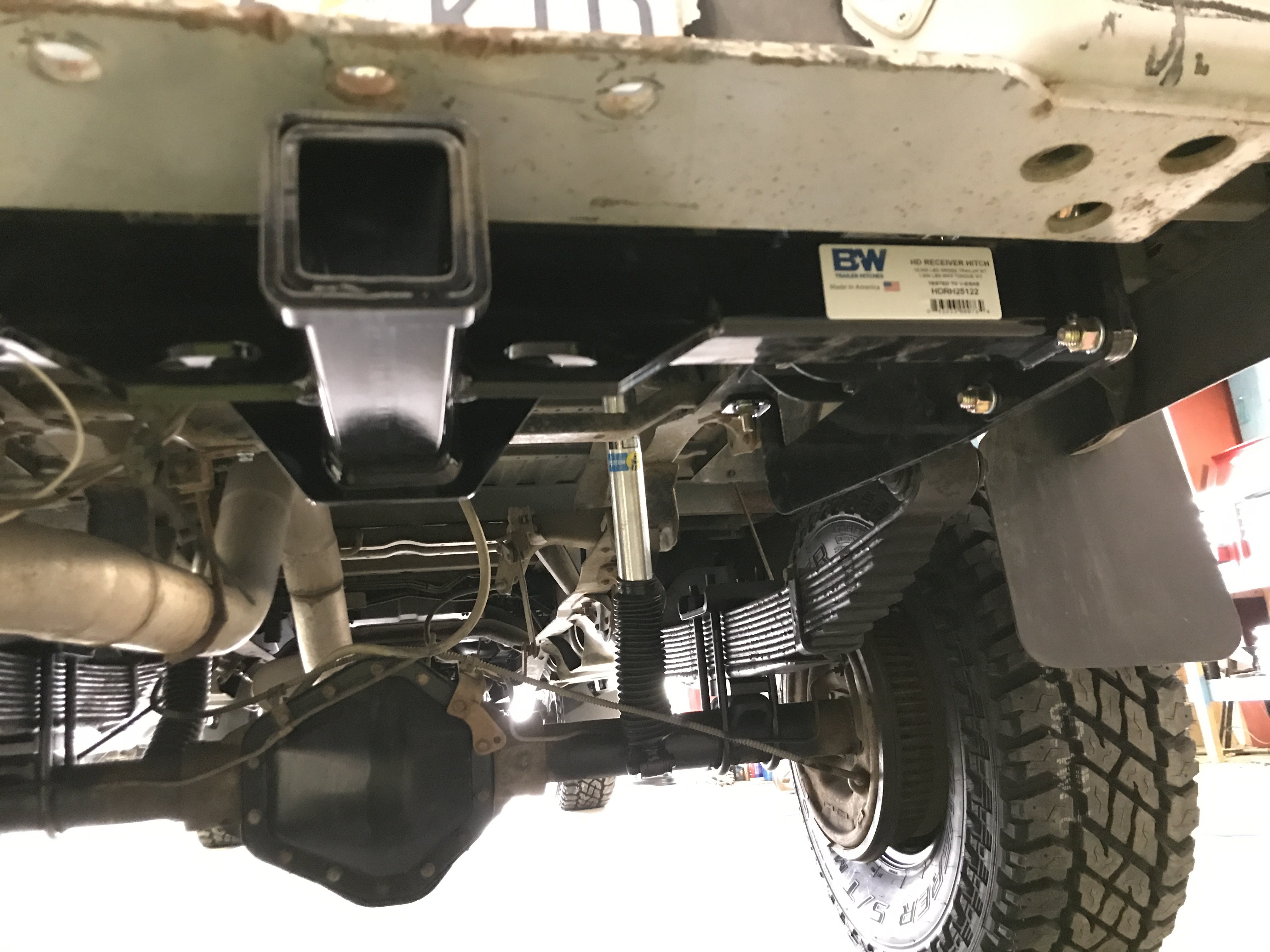

Suspension primarily by off road design. Front custom springs 4" lift, rear 2.5" shackle flip with ORD shackles and 1" zero rate. Bilstein 5100's with extended mounts up front. Sway bar correction / disconnect. Steering brace. New rear HD springs without overloads and I think 11 or 12 leaves. B&W 12k lbs receiver hitch, 7 pin connector on bumper and another in the bed for the camper. Wheel vintiques 16x8 steel wheels (5), and 315/75R16 Cooper ST Maxx siped for winter driving. Block heater, oil pain heater, trans pan heater, battery trickle chargers. Warn front receiver holds spare tire holder with another 315/75R16 on it. I don't usually bring it on short trips because these tires have been very tough. I keep a plug kit and viair compressor along usually instead. NFAB steps.

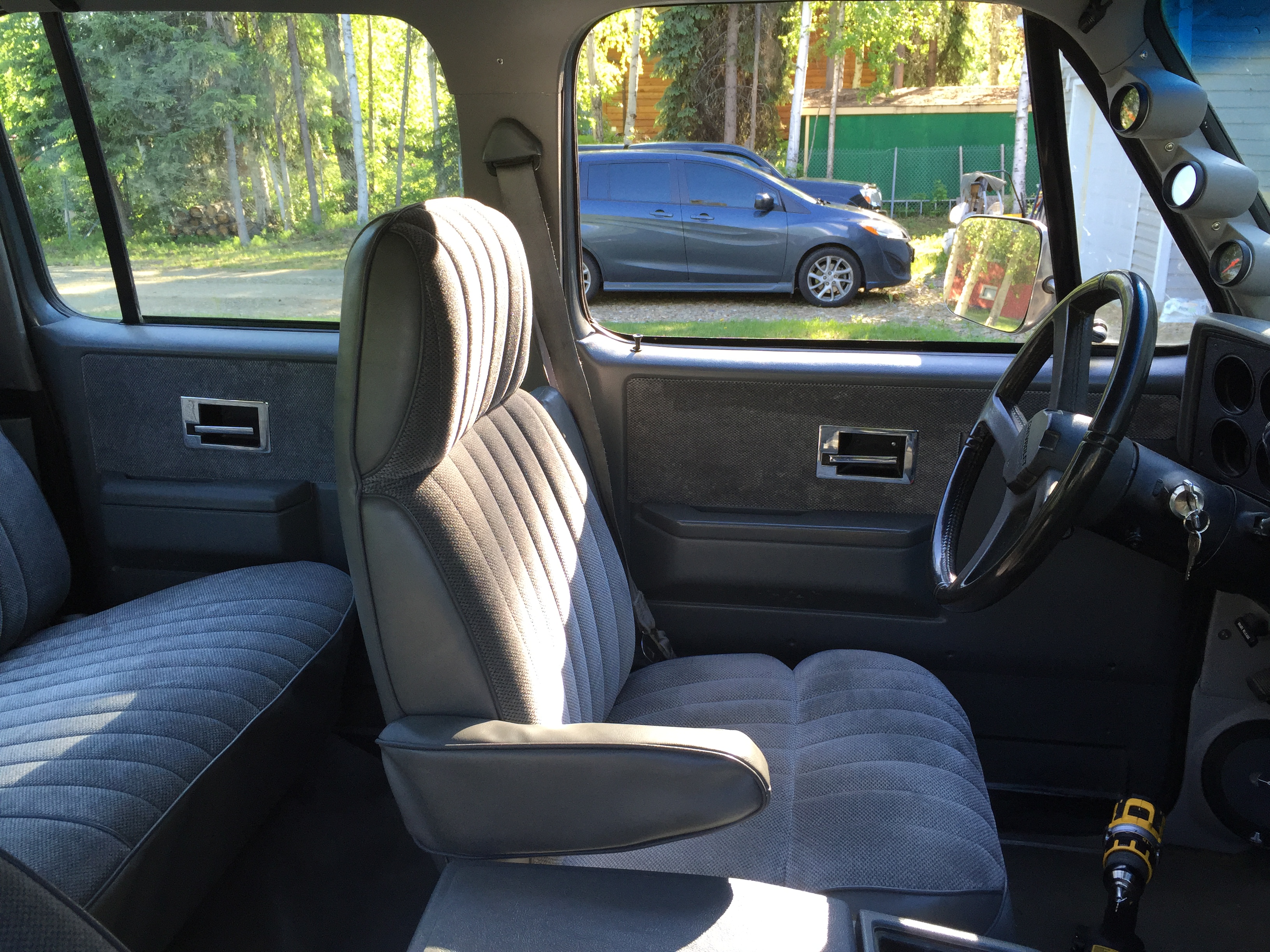

Interior has all factory gauges working, plus trans temp, oil temp and tach on the a-pillar. Tilt steering wheel, suburban front seats with arm rests and center console. Rear factory bench. Seat heaters for all positions except the middle rear. All new seat covers with vinyl backs for easy cleaning. USB and 12v ports all over the place with bluesea marine parts. Vintage air A/C with new OEM compressor matched to the L29. Alpine CD player with bluetooth and hands free calling. JL audio 5 channel amp, 6.5" front in the kick pannels, 6x9 at rear cab corners, and pair of 8w6 subs behind the seat. Sounds good. Viper 2 way auto start.

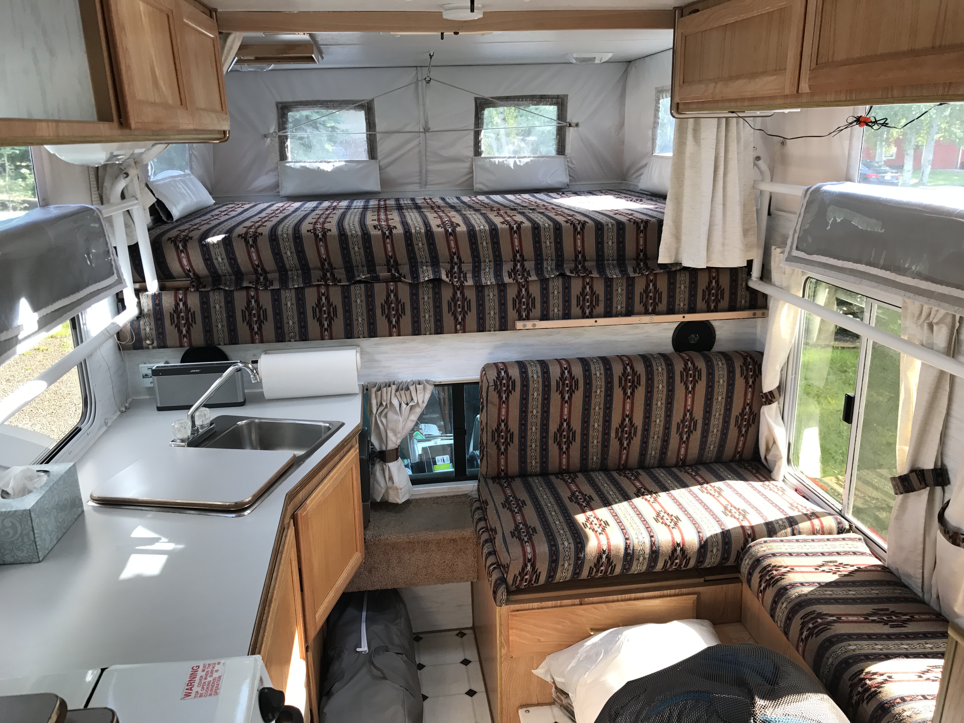

Camper is a well-used but functional 2001 Hallmark Cuchara. 100w solar, duracell 6v golf cart batteries in series, Dometic 2 way compressor fridge. Boondocker 30 amp power center. Bluesea 12v and usb plugs with digirtal volt meter. Digital thermostat for the furnace. Fantastic fan and two new shaded vents. Queen east/west bed cabover with lots of storage underneath. Indoor and outdoor hot showers, flush toilet with black tank. Two sinks, propane stove / oven combo. Pretty basic tank level monitor for fresh, gray and black tanks. Power roof lift. Rubber roof. LED interior and exterior lights. I've kept up on annual cheaning and treatment of the rubber roof and fixing nicks in the rubber or cracks in the caulking. The roof droops a little at the front and rear outside of the lifting structure but doesn't leak and I think will last for many more years. I store the camper under a carport out of the weather when not in use. Dinette converts to a bed that I can lay in (6'2") and there is a home made bunk bed that can be installed over the top of it.
