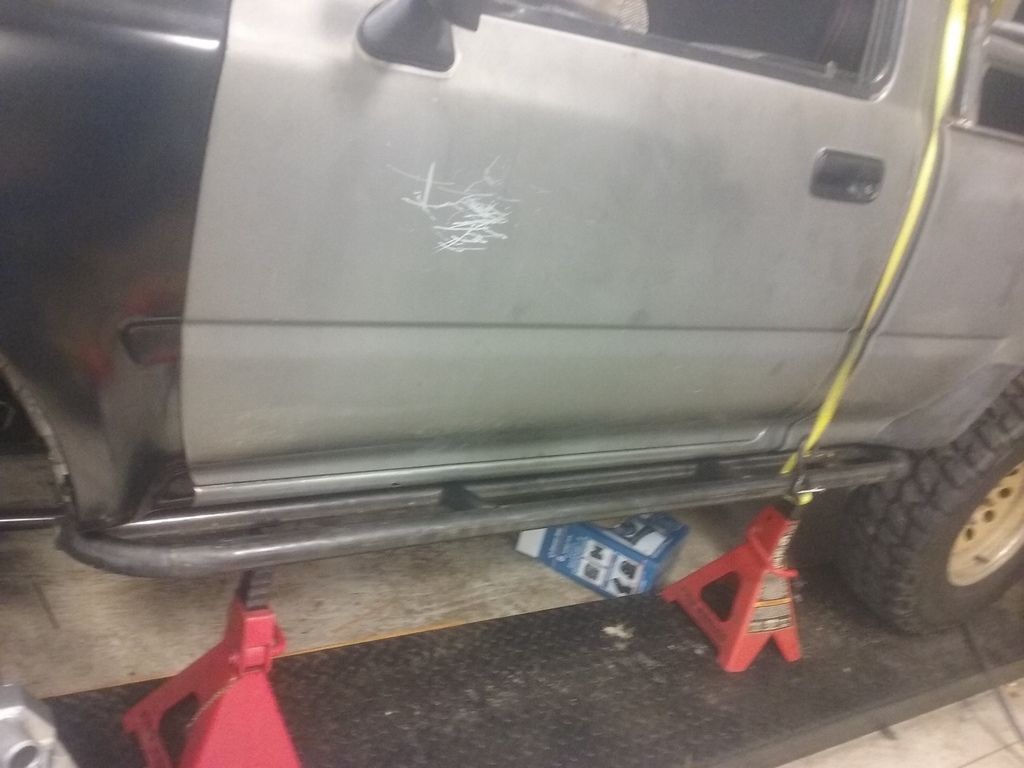

I should probably post more than just pictures, so the paint I used is durabak 18 and is supposed to be super tough stuff.

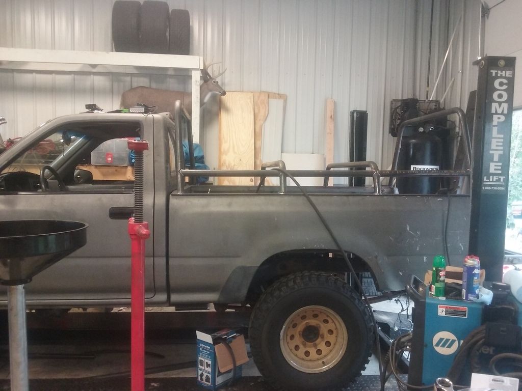

Also picked up a set of axles with electric lockers already installed, going to be finishing off the interior and commence daily driving status this week.
And installed some OME rear springs for overload and a small lift.
Also this is what the rtt looks like on my rack, going to add some removeable bars and make a soft top for it(stealth mode)

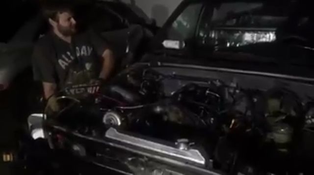

smaller turbo was installed spools like mad, came off a 2013 dodge dart.

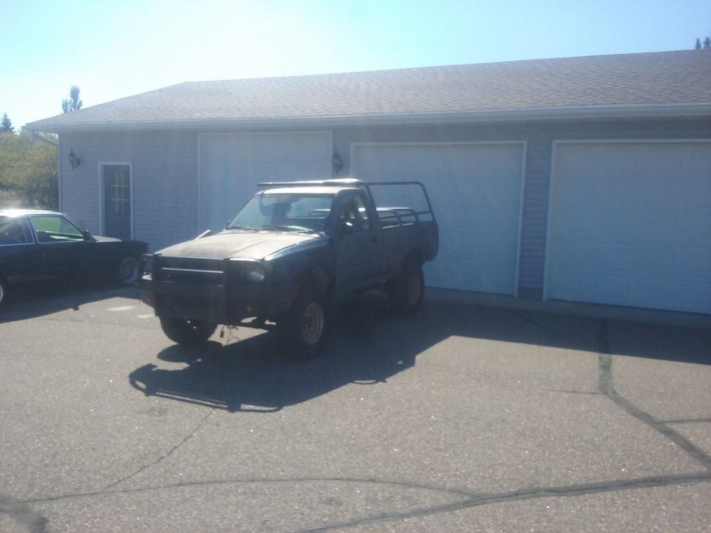

It's driveable now with an e locker in the rear, I did also just received my front ome leafs and hanger kit to put my solid axle front end in complete with hi steer and an e-locker. Going to start driving it in the spring when the salt is off the roads.
