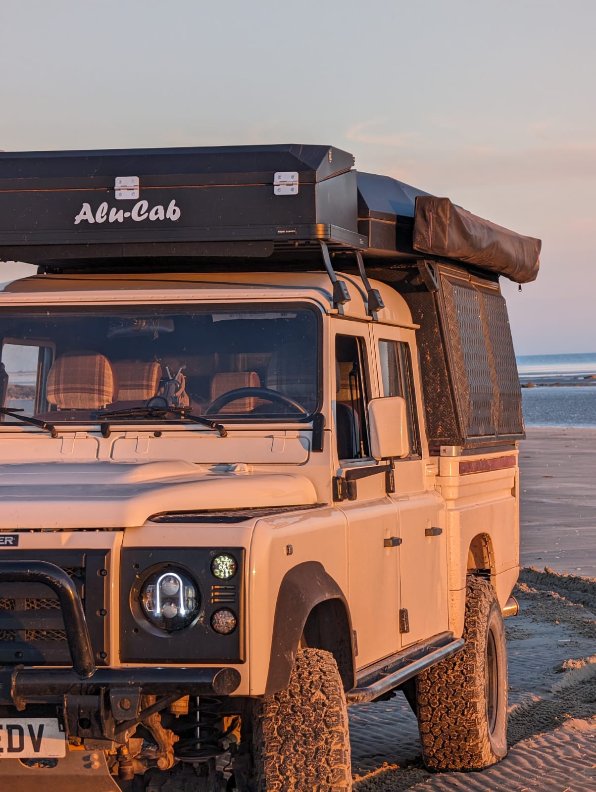

At the beginning of our Sonoran Rovers journey, we purchased this truck to be a support vehicle to use for our tour company. The goal was to build a Defender platform that could drive comfortably on the freeway for 6 - 8 hours with a crew of 4 and carry all the gear needed to support a trip of up to 20 people. Apart from a full sized American double cab pick up (and where is the fun in that) this is hands down the best platform we could come up with.
After well over 1,000 hours of work and multiple adventures across the Southwest and Mexico, it is finally time for us to say goodbye to this build. This truck has been foundational in creating and building our business, but we’re excited to see it go to a new home where it will be appreciated as much as it has been here! For us to build a truck of this caliber again would cost well over $250,000 and take at least a year. Don’t miss out on your chance to buy what is probably the most capable Defender 130 in the States!
Mechanical
  • Completely rebuilt chassis - Stripped and chemically dipped with new outriggers and rear cross member
  • Double skinned chassis for extra strength to handle the Overland build
  • Swapped to Left Hand Drive
  • OME heavy springs and BP-51 adjustable shocks
  • Heavy duty steering arms from Gwyn Lewis 4×4
  • Rebuilt axels
  • Rear ARB locker
  • Rebuilt R380 5 speed transmission
  • Rebuilt LT230 transfer case - 1.2 ratio for freeway driving
  • All new disc brakes
  • 1 Tonne wheels with 285 75 r16 BFG ATs
Interior
  • Ministry of Defender air conditioning
  • Custom Puma seats - for 5 with leather and hunter check - designed and built by Kens Customs in UK
  • SONY Double DIN with sub woofer, as well as Apple and Android Car Play
  • Custom wooden dash
  • All new VDO gauges
Expedition build
  • Alu-Cab Canopy Camper for 5.5 foot bed
  • Alu-Cab awning AND Shower Cube
  • Rear spare wheel carrier
  • Auxiliary 75 liter (20 gal, if you prefer Freedom Units) stainless steel chassis mounted fuel tank and transfer pump for a total fuel capacity of 155 liters (41 gal) for a 700+ mile loaded range/
  • Auxiliary 75 (20gal) liter stainless steel chassis mounted water tank with pump
  • DH9 Diesel Hot Water System with Espar Hydronic HS3 D5E
  • 180 watt Sun Flare flexible solar panel
  • DCS 200 AH LFP
  • Red Arc Manager 30
  • Red Arc 2000 Watt Pure Sine Wave Inverter
  • BCDC battery charger
  • ARB Twin Motor compressor
Paint and Body
  • New rear tub
  • New galvanized Puma doors
  • New bulkhead
  • New roof
  • New puma bonnet
  • New glass all round
Asking $195k and located in Tucson, Arizona. The truck will be available at Sonoran Rovers for viewing, or if still available by March, will be at the AZLRO March Rally. Reach out for more info or with any other questions!
