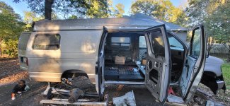

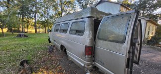

1995 E350 Extended Van Overland Build Project
I have decided to sell my project. Currently, I would like to sell it as a whole. If and when I decide to sell the parts individually, I will update this ad. Until then please do not inquire about individual pieces. Thankyou.

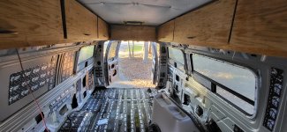

Basics: 1995 E350 7.3L Diesel 144,000 miles, fiberglass high top with built cabinets in ceiling...

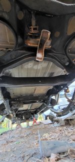

Frame has been fully chassis saver coated.
1" body lift(this is huge for maitnenance and helps some with heat management of the 7.3L). Bushings are in great shape. Previous and first owner kept the van in Atlanta, Ga for its life.

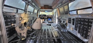

Van floor has been sanded, primed and coated x2 in valspar anti rust
Doors have new cables and metal ends (common headache)
Custom windows and pop out stock windows all around
Smittybilt Swing RC Rear Bumper and Tire Carrier with Jerry can Tray (1000$) Bumper is designed for JK Jeep but with some trimming to body lines and fab work on mounting will fit van no issue.
Front bumper from 2017 F250 (450$) Should improve air flow into motor and with frame reinforcemment bumper bracket (think UJOINT bolt on style) will bolt right up with a little work. (seriousle 4 of the 8 mounting holes line up as is)
Engine Doghouse has Foam and sound deadening already applied
Floor and walls and doors have kilmat applied

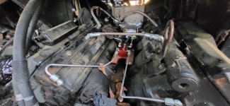

7.3L No major known issues everything has looked great!
CNC Fab stage 1 HPOP installed $579, CNC FAB hpop lines with crossover 225$, ALLIANT 160/0CC injectors 2550$, rebuilt IPR, melling LPOP 158$, Gates water pump and new neck 150$,
FUEL - CNC FAB 4 Line feed Fuel kit (fuel bowl delete) 400$, Air Dog 2 5G 860$ (wires into factory wiring and has regulated return, pump, air water seperator etc all in one unit and lifetime warranty), simple setup that runs 1 line of fuel straight from pump to motor), fuel tank cut and modded for 4wd with hutch mod and sump 250$ for full fill ups and a sump with drain and catch to save on fuel pump life. The tank inside is perfect with no delamination issues etc. that can ruin pumps and motors..

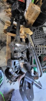

2012 F250 Axle <100k miles, from non wrecked truck, 4.30 gears with elocker (will include instructions and necessary relay to wire it up) currently perches have been trimmed to be rewelded on for van$1200
2015 f250 axle <100k miles, also non wrecked truck, 4.30 gears, fully rebuilt, new timken wheel bearings 450$, balljoints 230$, seals, dana ujoints 100$, everything is new to ensure smooth and safe driving. all parts were mevotech ttx for balljoints and installed per mfg. axle also painted in anti rust paint. This axle has larger balljoints and ujoints and knuckles than earlier year models.

Reality: The van is on stands. 90% of this is not installed but ready to be. Everything not listed as used is brand new and in boxes. I am happy to discuss the build and how and whys if you are serious. All of it has been carefully selected for a comprehensive build from talking with the best companies and ford guys in the business that should work very well together (37inch tires, 4.30 gearing, final drive ratio of the e40d, Brian jellich tunes, the rpm range of the 7.3 with the 1.0 housing and balanced turbo assembly...) Its a spectacular build list and an immense amount of research and time has gone into the project. I am sure I have not listed everything but the majority of what I have. I will update with photos soon.

Sorry for the delay. These are very rough and I have yet to organize everything nicely. But should be able to next week.
