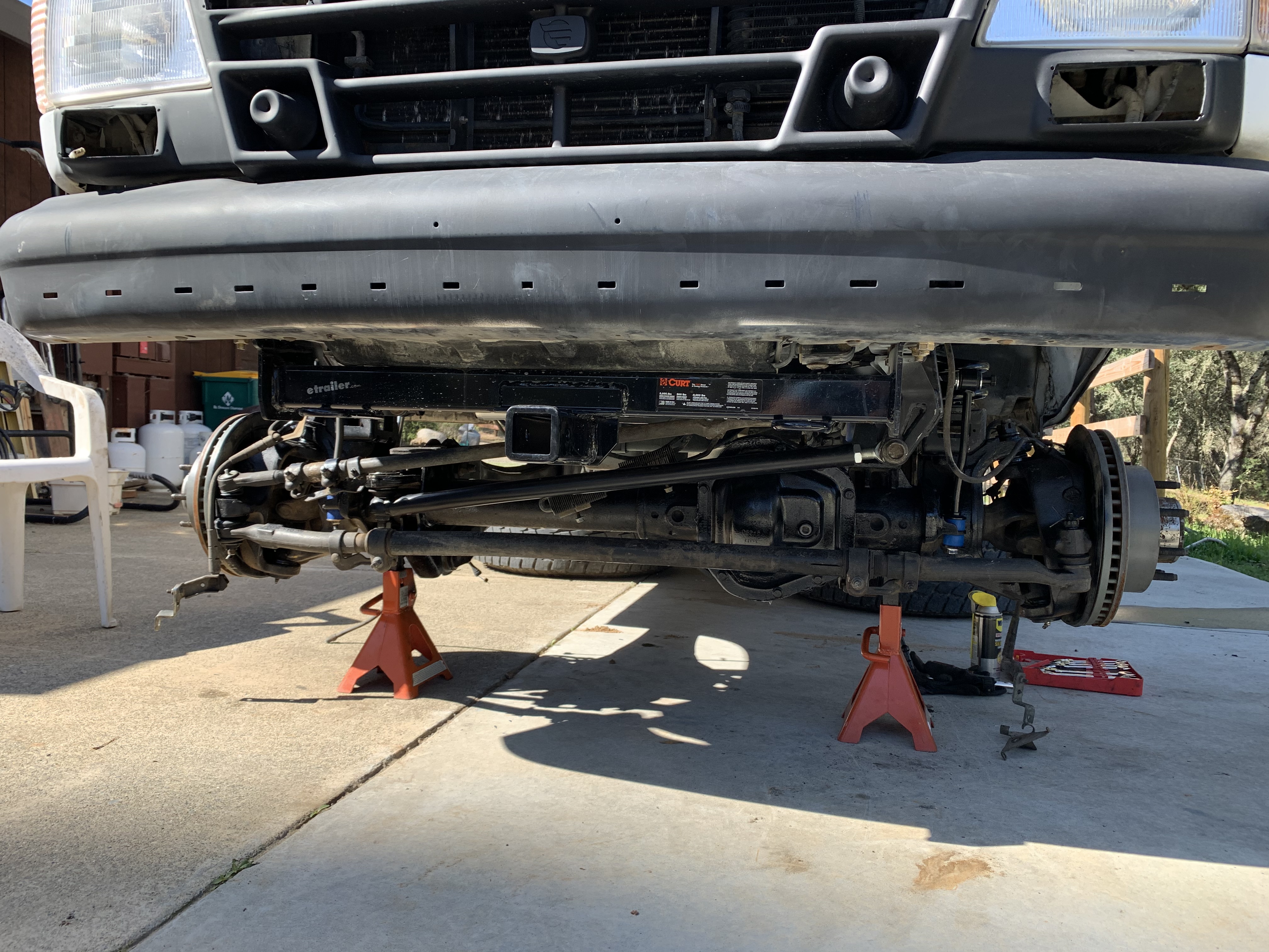

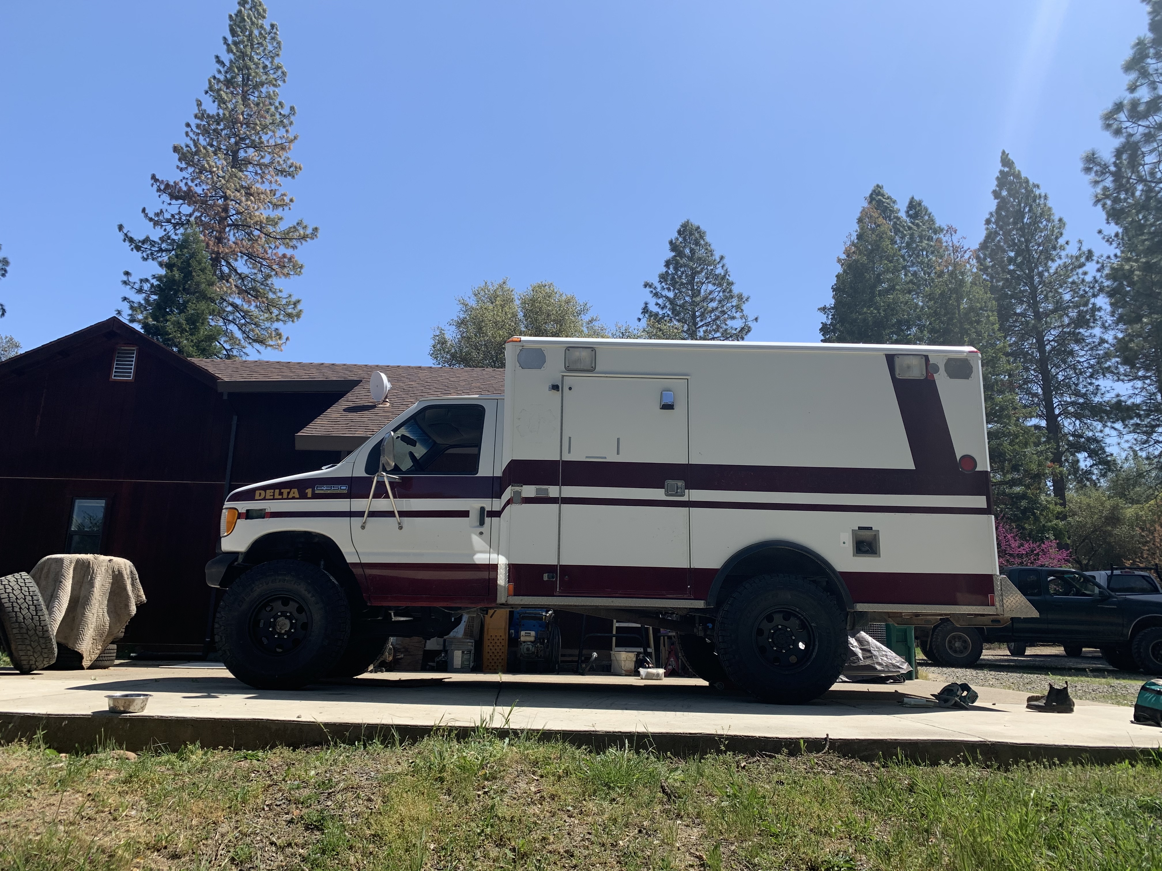

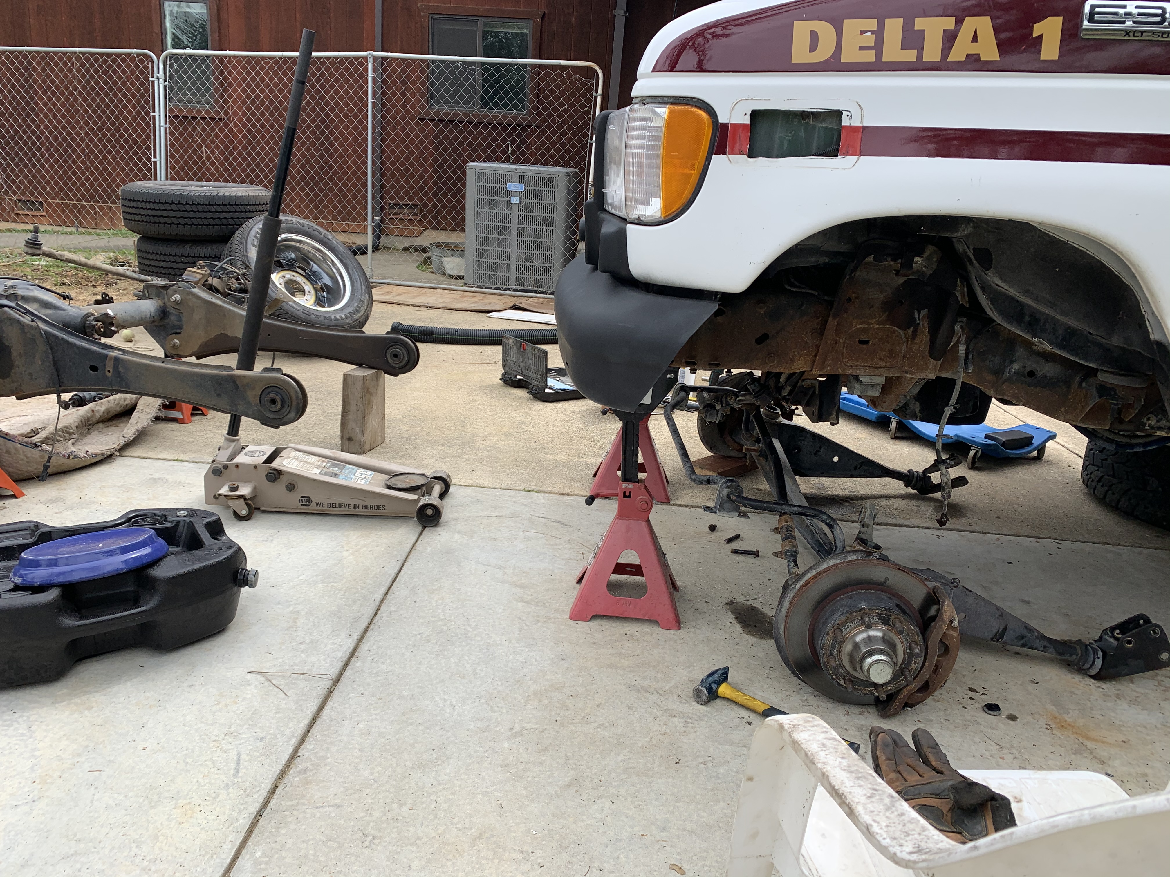

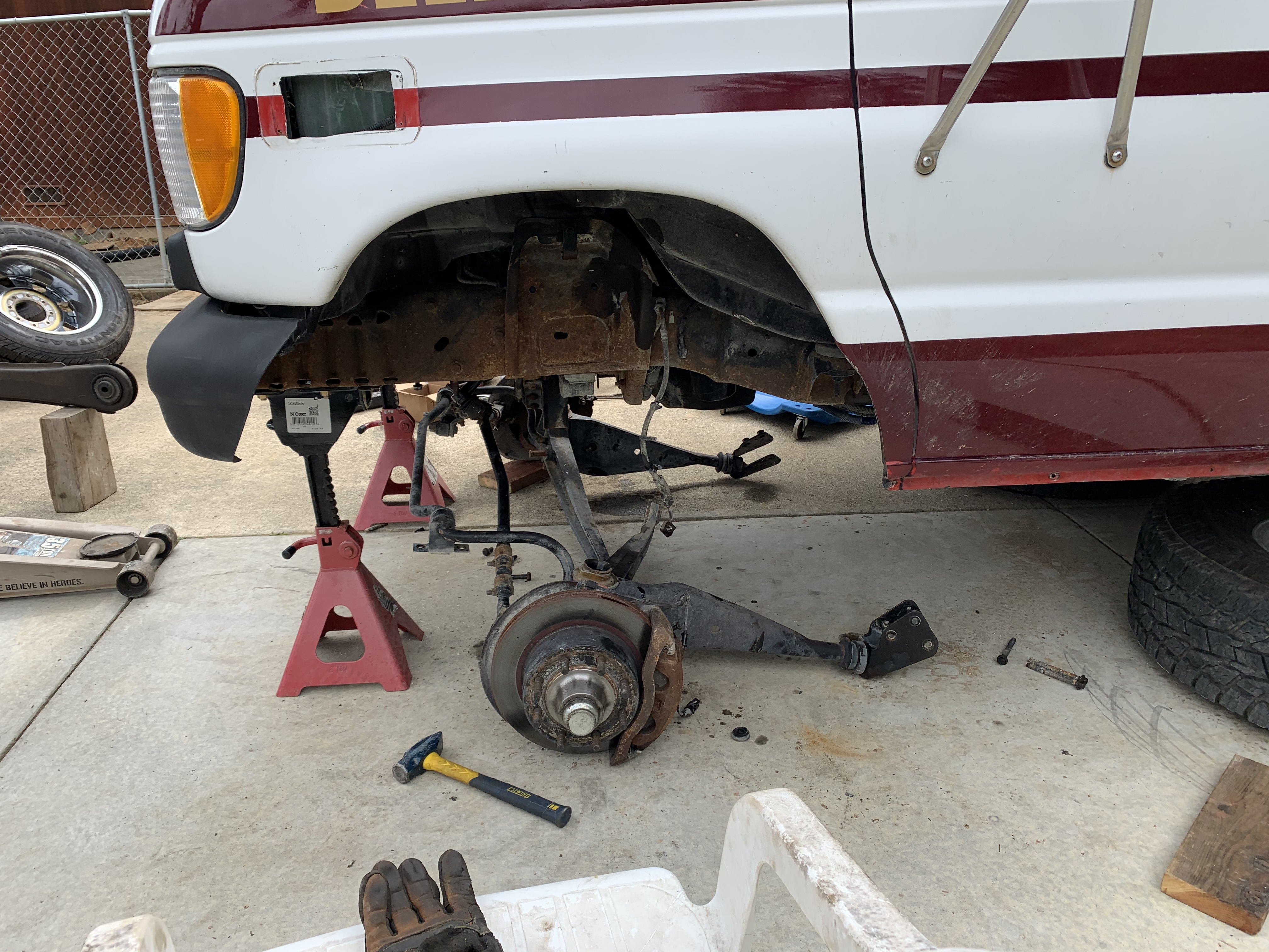

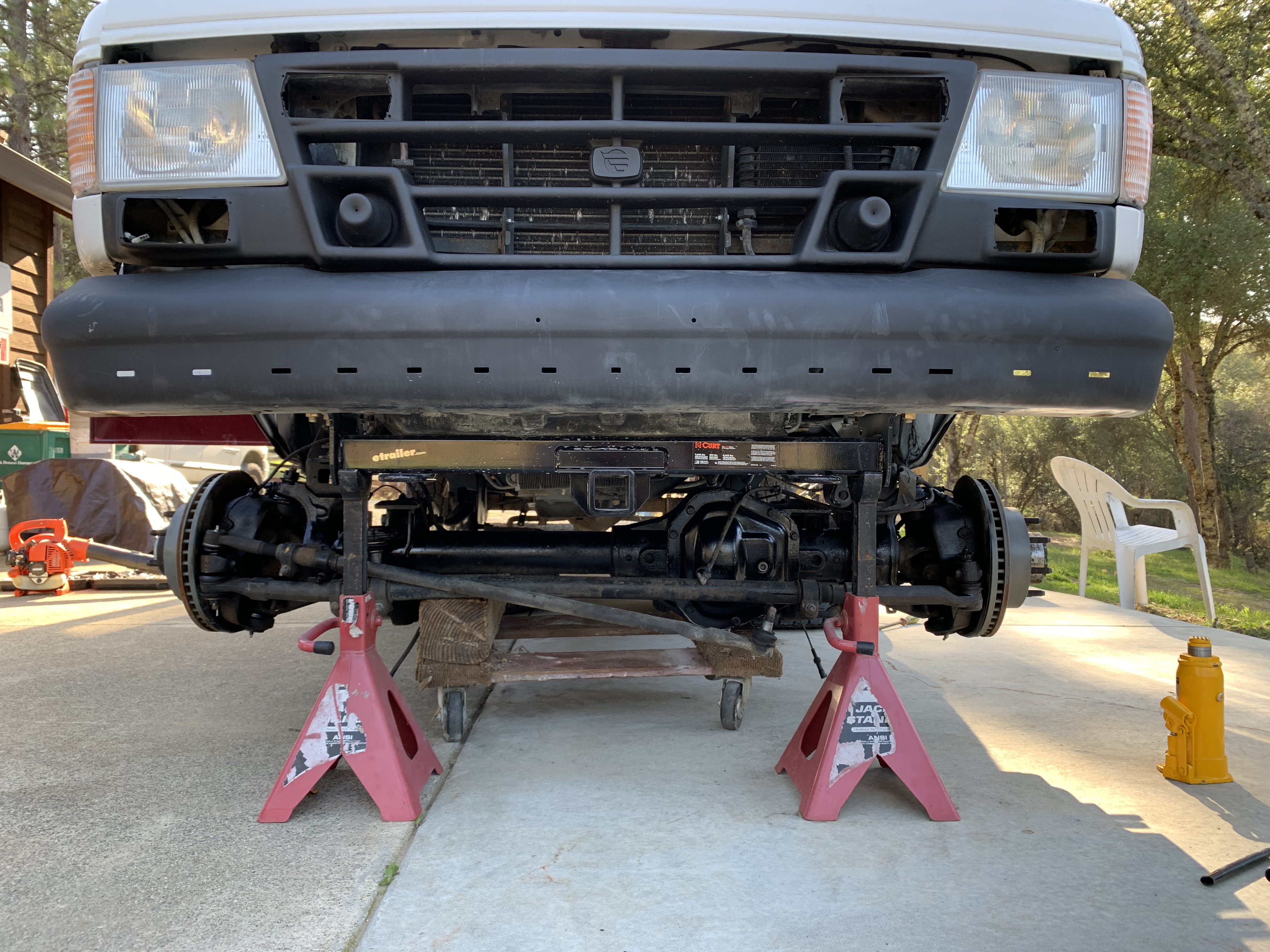

  • The 4x4 conversion is the Expo Van(MG Metal Works) bracket kit with a complete 2008 f350 front axel. Fox 2.0 shocks all around, and Timberline vans rear lift and lug pattern adaptors.
  • Sitting on brand new Cooper AT3 extreme 37 x 12.5 x 17's

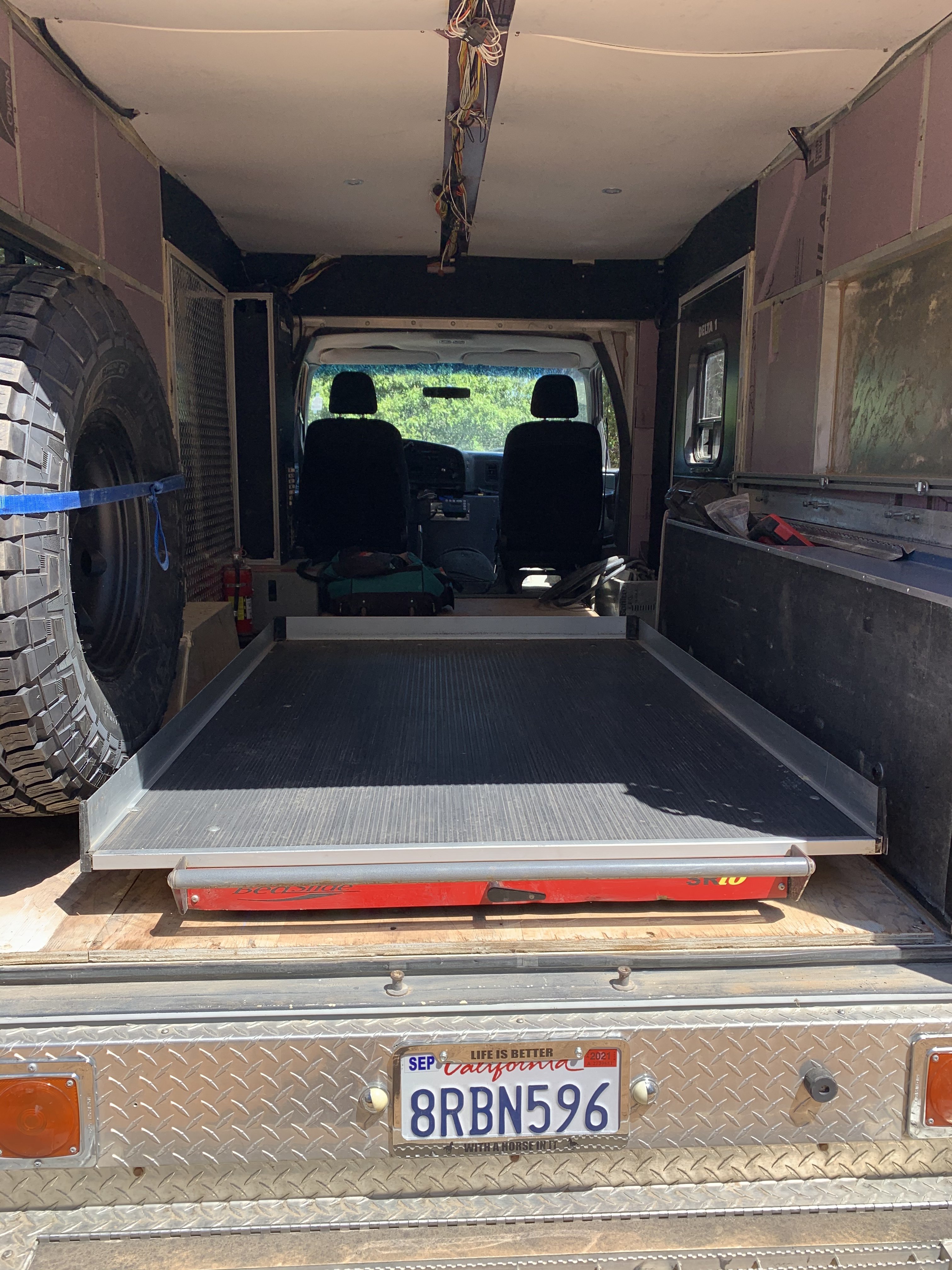

  • The interior has been striped of all the nasty ambo parts that I am sure have seen their fare share of action and the wiring has been paired back and cleaned up.
  • The interior is very simple and open right now the intent was to build as we used it in order to most efficiently use the space.

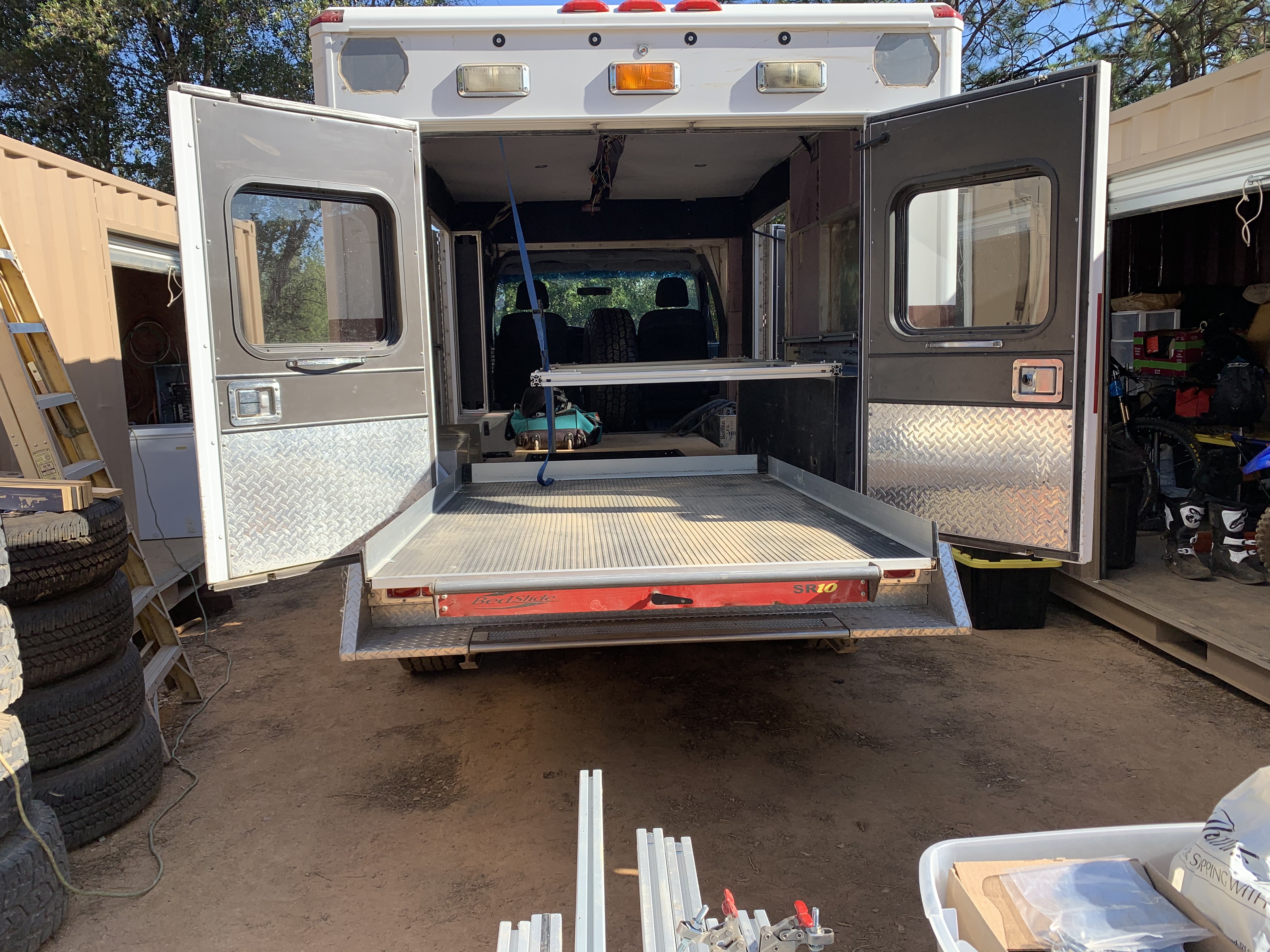

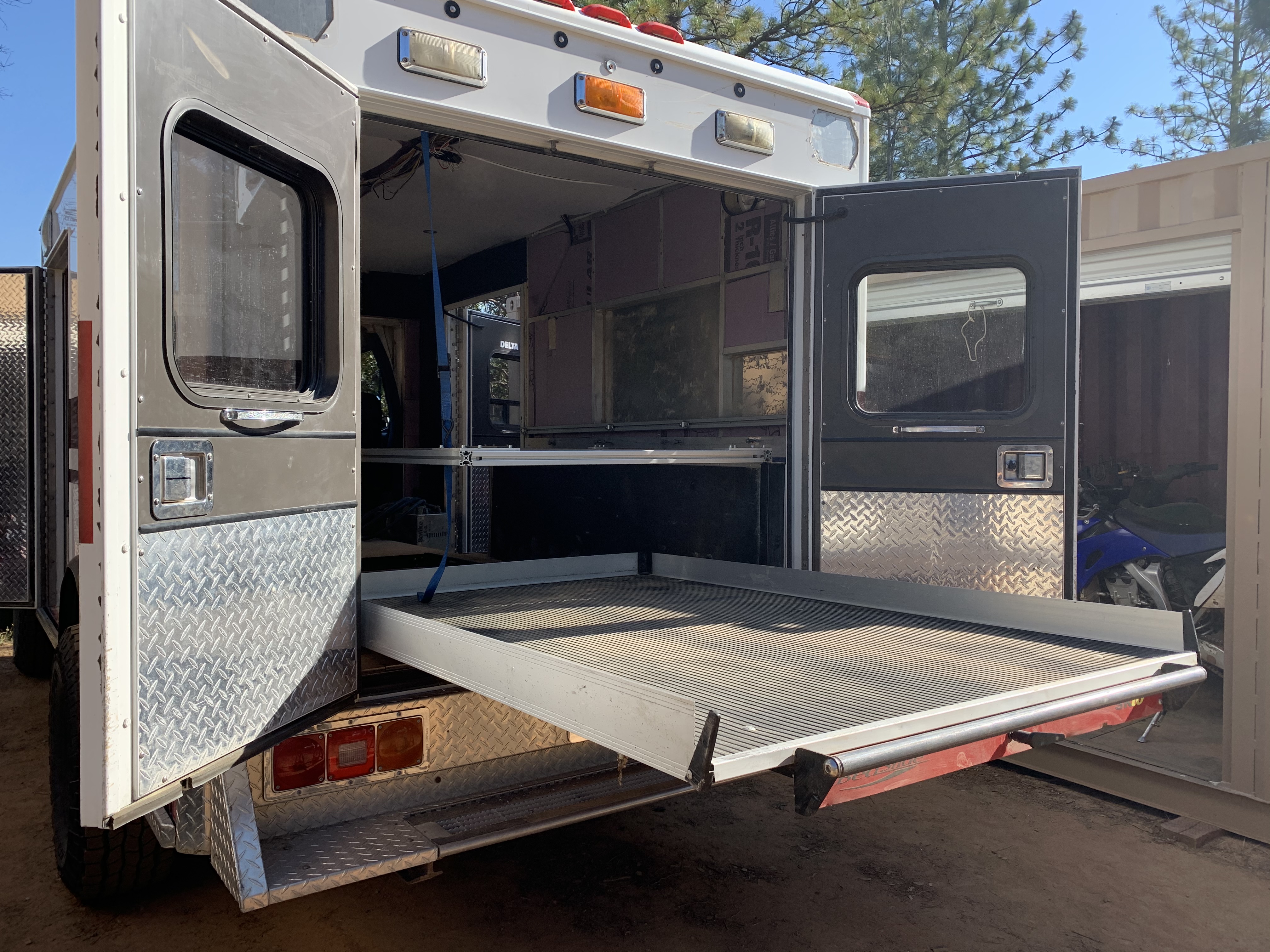

  • Currently there is a full bed platform the folds up into the way and a truck bed tray slide out for easy access to gear.
  • The interior was re insulated with havelock wool mats and sheeted with high grade 1/4 inch plywood.
  • The roof is covered with cedar plank, with led lights and a max air all installed.
  • There is a diesel heater installed in working form but still needs to be plumed into the truck tank, right now it is set up on an aux tank.

I'll preface this with in its current form the Ambo is 2 wheel drive, I will list what it need to be completed and will give detailed notes to the buyer so nothing is missed.
  • It needs a transfer case for an E4od transmission.
  • Driveshafts
  • Front axel regear
  • Speed censer compensator
  • 4x4 shift linkage
  • transmission crossmember adjustment
  • It has the ABS light on needs new rear censor and 04 truck front censors
