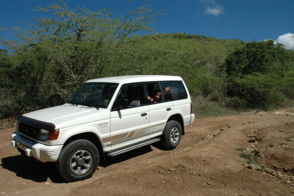

Getting there...

The All famous "Cerro de Nandy" how well did the montero made it up there?
