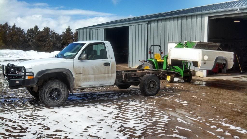

I received this pickup as "wages" from helping my parents on the ranch during high school. It is a base model with manual windows, locks, and the floor mounted transfer case selector. It has the 5spd manual with the 4.3L. I did the usual easy mods during college like wheels, fender flares, toolbox. I later added the ARB front bumper and transferred the light force lights from my grill guard. The winch came later and has done more "farm" work than recovery work. I recently ran across an article which highlighted a rig from flexible fabrication. so I decided to "loosely" copy their flatbed design with the intentions of purchasing a rtt for it. I have started the bed and am in the process of designing the rear bumper portion of it.

I "borrowed" my dads mig welder, and plasma cutter and bought a JD squared tubing notcher and bender, both are awesome. I started the frame out of 3x3 .120 wall square tubing and decided everything would consist of .120 wall.
I took the bed off to test fit the new one and mark the mounting locations. This is as far as I have made it.

mtf, looks awesome so far!
i really need to learn how to weld!
What model ARB bumper is that? didn't know they had one to fit the 1500? Did it just bolt in?
I have seen where folks had adapted the one for 2500 series trucks, I really like the look on your truck.
Cant wait to see how this turns out.
mtfarmer
Welding is a blast and comes in handy. This is one of the few welding projects were I actually get to use new steel, used to mostly welding broken farm equipment.. The bumper was a direct bolt on application. I think the bumper is built very good and is not insanely heavy, having said that I want to do the landcruiser arb mod because mine hangs out a fair bit in the front. this post is of the mod...http://z71tahoe-suburban.com/iboard/lofiversion/index.php?t17766.html but it will have to wait until the bed is done.
82fb
Looks great,. Only thing I would add is that the 4.3 is a decent motor, but certainly not a powerhouse. Given that, keep the bed as lightweight as possible.

Well here's an update since spring planting has wound down, and its the calm before haying starts up next week. I got the bed "done". I had bed liner applied to it and the tent rack. The RTT works great and I was able to take it out last week on its maiden voyage. I updated the Light force blitz halogens to 50w hid xgts. I also added 6 rigid dually leds for camping lights. I installed the National Luna dual battery system along with an optima yellow top which is for the lights and fridge. That's about it, and the next thing will be to replace the arb bumper.
