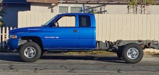

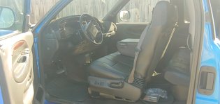

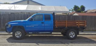

We drove up to Long Beach area to check it out. It looked fairly clean, was an 8.0L V10 with 83,000 miles. This was a fully optioned model with camper package and towing package. The owner had built a flatbed, which wasn't a big deal as I was going to remove it and put the ambo box off the M1010 on it. We made the deal and we drove it home. Fast forward a few months and it was time to take the flatbed off. That was challenging in our driveway as it was HEAVY. Okay, I started getting things prepped to take the box off the M1010. I had done my measurement and length and wheelbase looked to work fine. Before I got the box off, I happened to notice a neighbor's truck sitting behind the M1010 on the street. I noticed the newer truck was wider than the M1010. Hummm..... tape measure in hand, the one measurement I didn't check was width. The Ram was 3" wider than the M1010 box. With the way that box is built, there was no easy way to make the wheelwells wider and once I started chopping, there would be no turning back if it didn't work. At that point I scraped that plan...

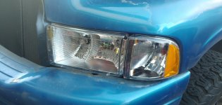

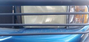

Removed the grill guard and installed new headlights.
Pulled the flatbed off before realizing the truck was too wide.

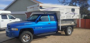

After picking up the Northstar TC800 camper
Replacing the flatbed with a truck bed
Camper on with new bed and currently how it looks.

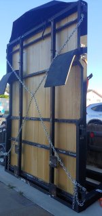

I used rated eye bolts mounted into the corners of the bed frame (steal part). Then I used rated turn buckles to attach the eye bolts to the camper, to tie it down. This was manly a temp solution to get it home from AZ to San Diego. I had to estimate everything, since I had to pre-setup stuff before driving over, since I wouldn't have any tools to fab up things when there.
As for swapping beds. The flatbed was a previous owner built one and it was very heavy. This camper ended up being heavier than expected and I was basically at GVWR without anything loaded for a trip. I really wanted to swap out to an aluminum flatbed but couldn't find a deal in the price I wanted to pay. Found a deal on the stock bed and the guy wanted the flatbed, so it made it easy as I didn't have to remove/store the flatbed. This cut 300 lbs off the total weight, so I had a little overhead to work with. Your idea of doing toolboxes down the sides of a flatbed is what I have wanted to do from day one. You can never have enough outside storage. Downside is, you will likely overload the rig because you will have all of that storage. The stock bed kinda keeps things in check. That is the one thing I like about newer 3/4 ton trucks, they have a GVRW closer to 10K lbs versus my Ram (and most trucks of that era) of 8800 lbs.
