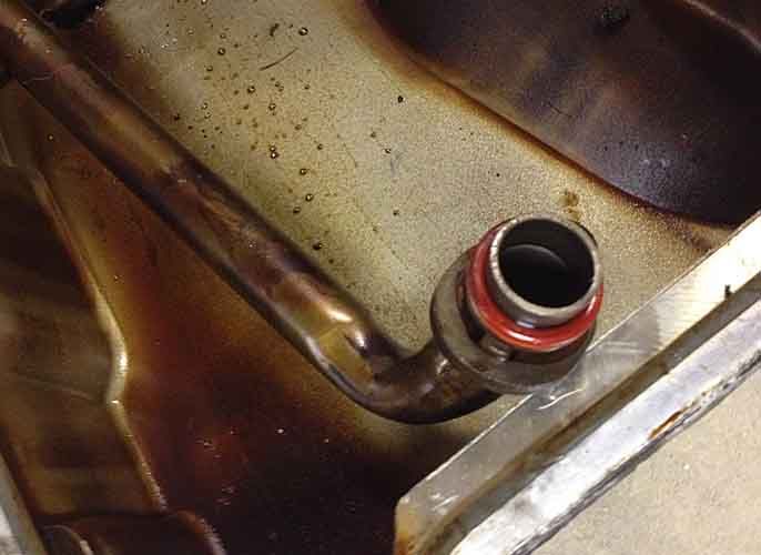

If you start getting very low pressures on a high mileage engine of this type, consider replacing the o-ring on the pickup tube, and maybe a pump replacement.
http://www.expeditionportal.com/for...ckup-Suburban-Yukon-etc?p=2116569#post2116569
And at that point of engine surgery might as well change the timing chain set while you are in there.
