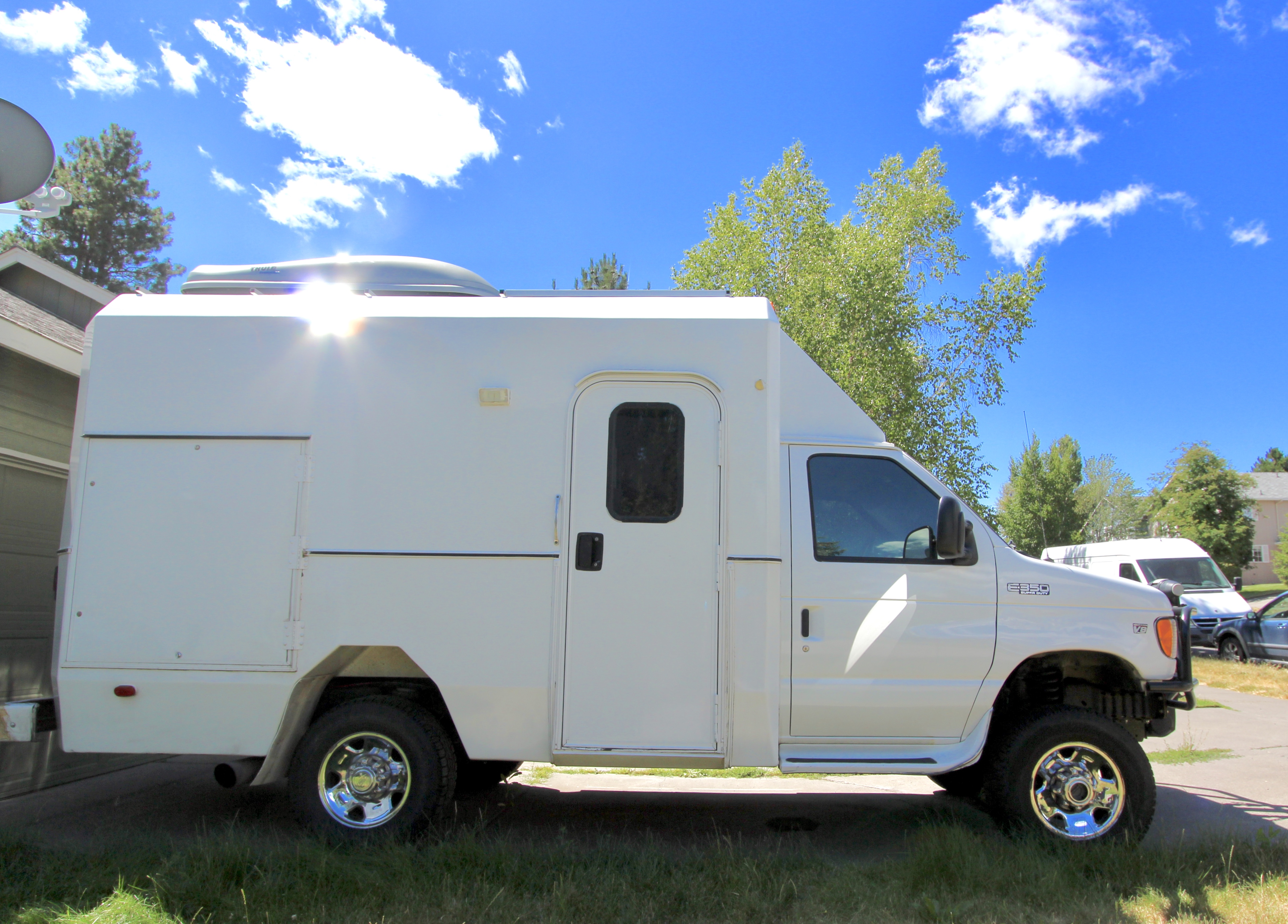

7ft x 12ft fiberglass two piece clam shell body by Mobile Concept
21 foot overall length so it still fits in a normal parking space
6 1/2 ft standing height inside
Passenger side RV style entry door with entry steps, a deadbolt, and a handle lock

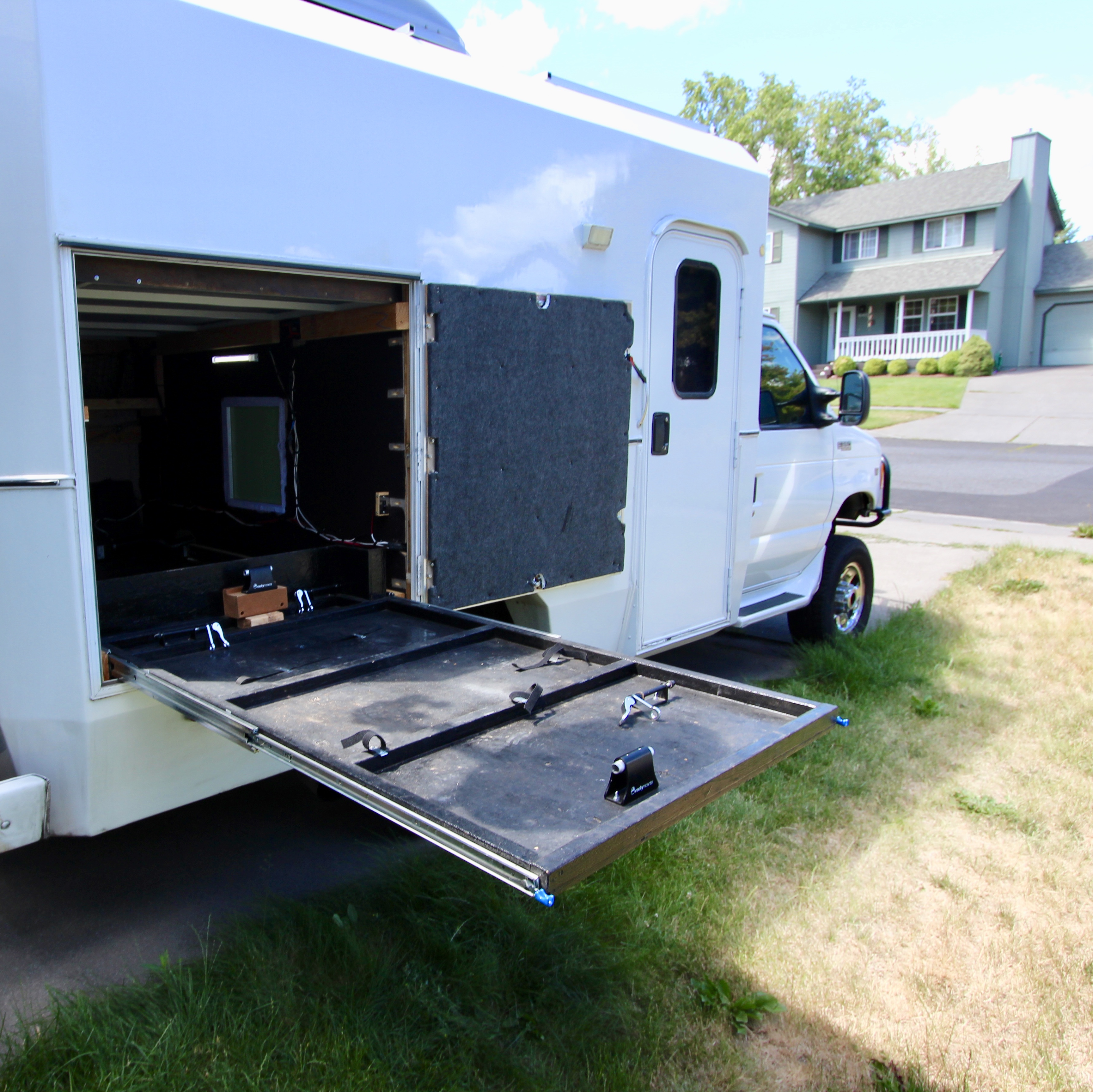

Passenger side 45”x45” Garage door to access the all of the storage space underneath the bed platform, inside is a full width 500 lb drawer slide to conveniently pull your storage out of the side of the vehicle.

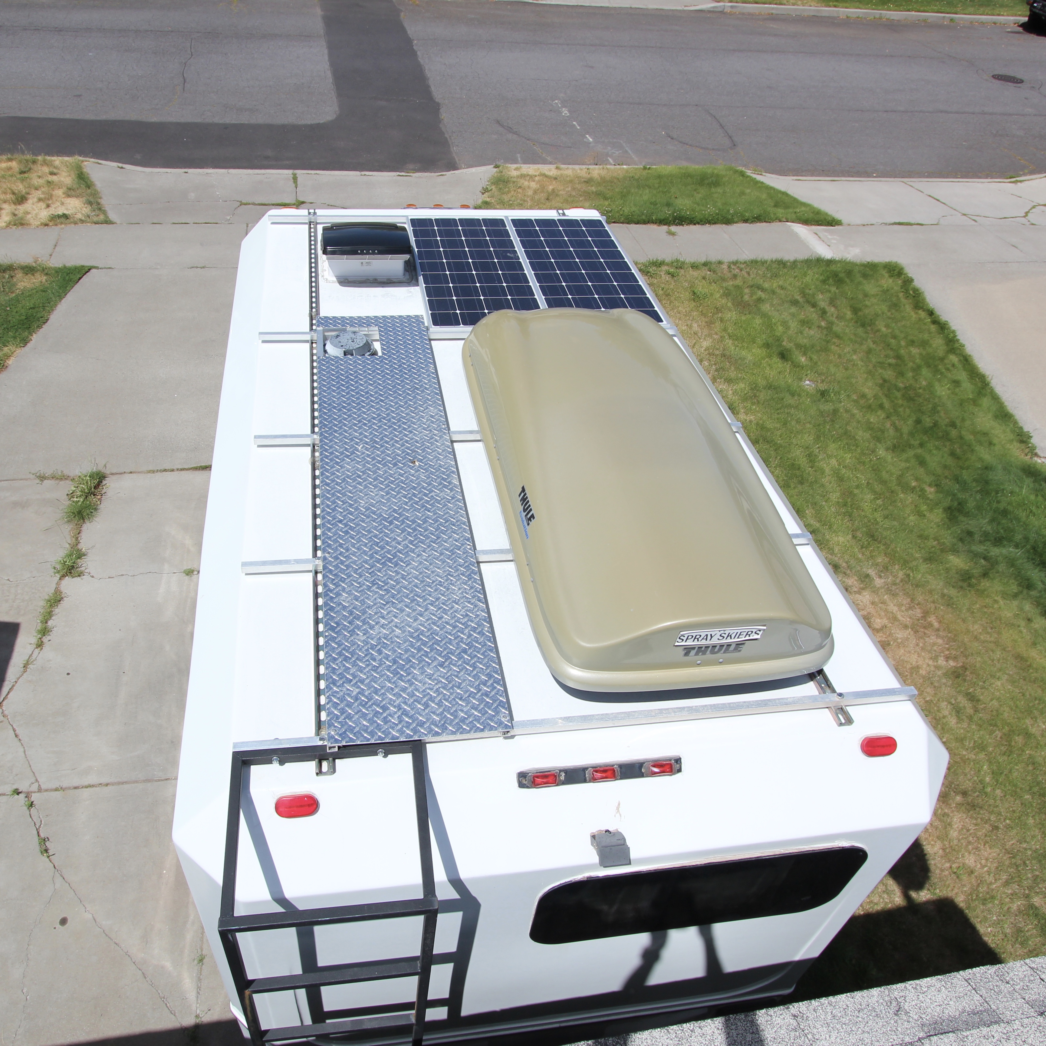

200 ah 12v system charges while you drive or with the 200w of solar panels.

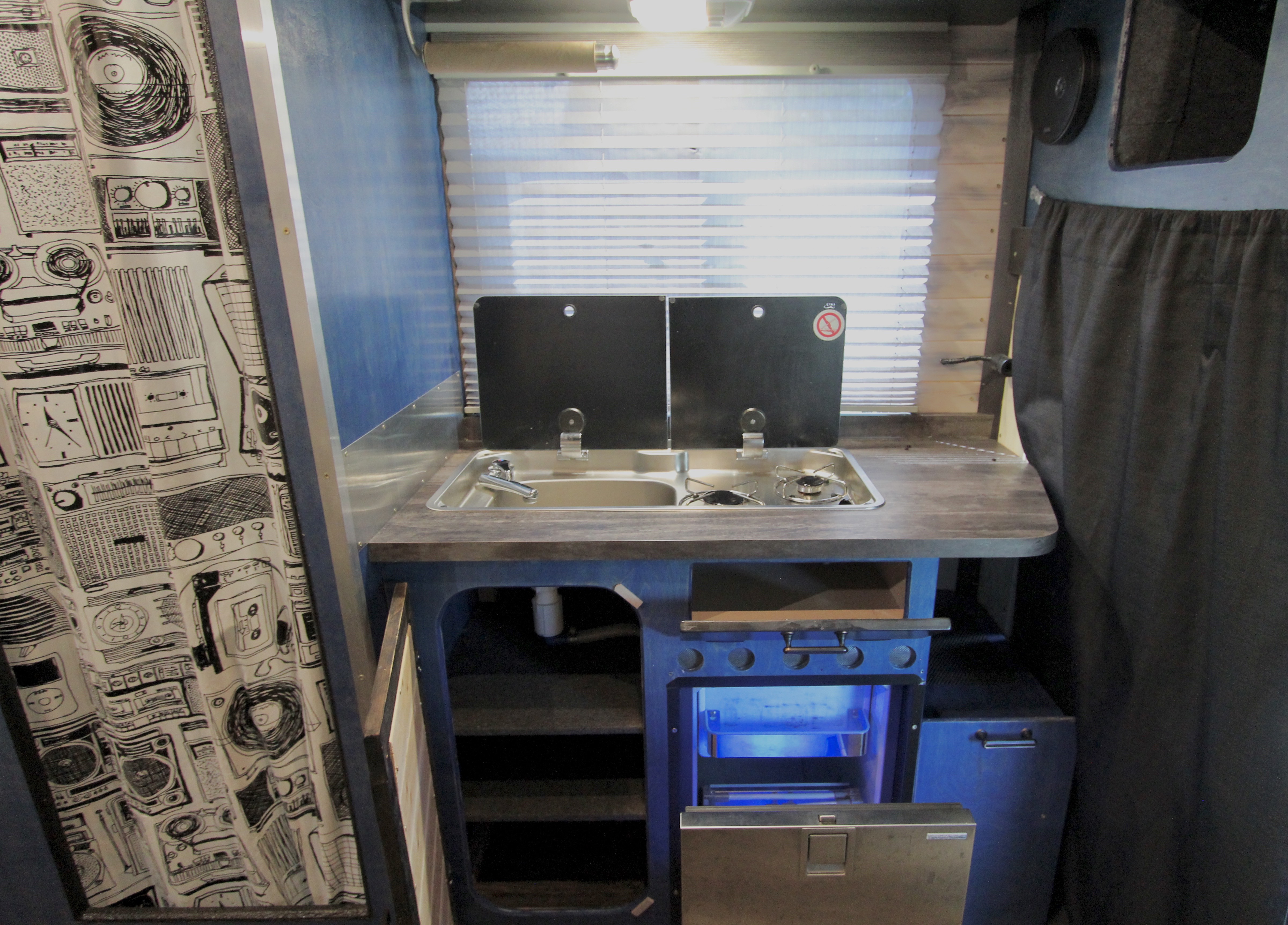

12 volt stainless steel truckfridge drawer style fridge

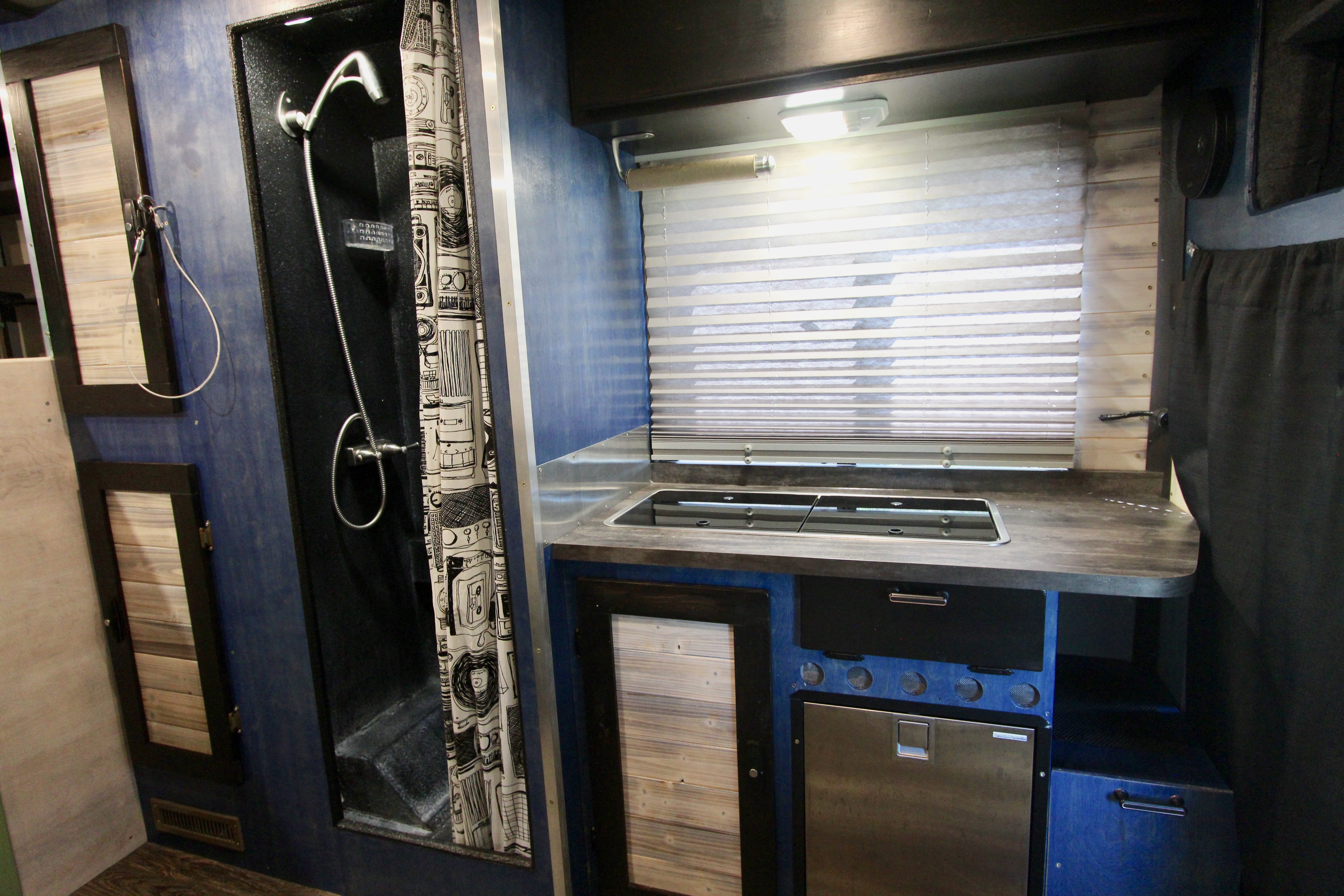

Sink and stove combo from CAN with two burners and separate lids for each (this has it’s own 1 gallon propane tank that lives in an exterior vented compartment, and generally powered the stove for 2-3 months of every day use!)
Shower INSIDE the van, walls are coated with LINE X and are extremely waterproof/durable. The shower also doubles as a space to dry wet clothing/gear, as it has it’s own small heater vent, and it’s own 6" exhaust fan.

Custom powder coated rear ladder build by Action Van of Bend, that gets you to the low profile aluminum roof rack, with walkway, Thule Box, and solar panels.

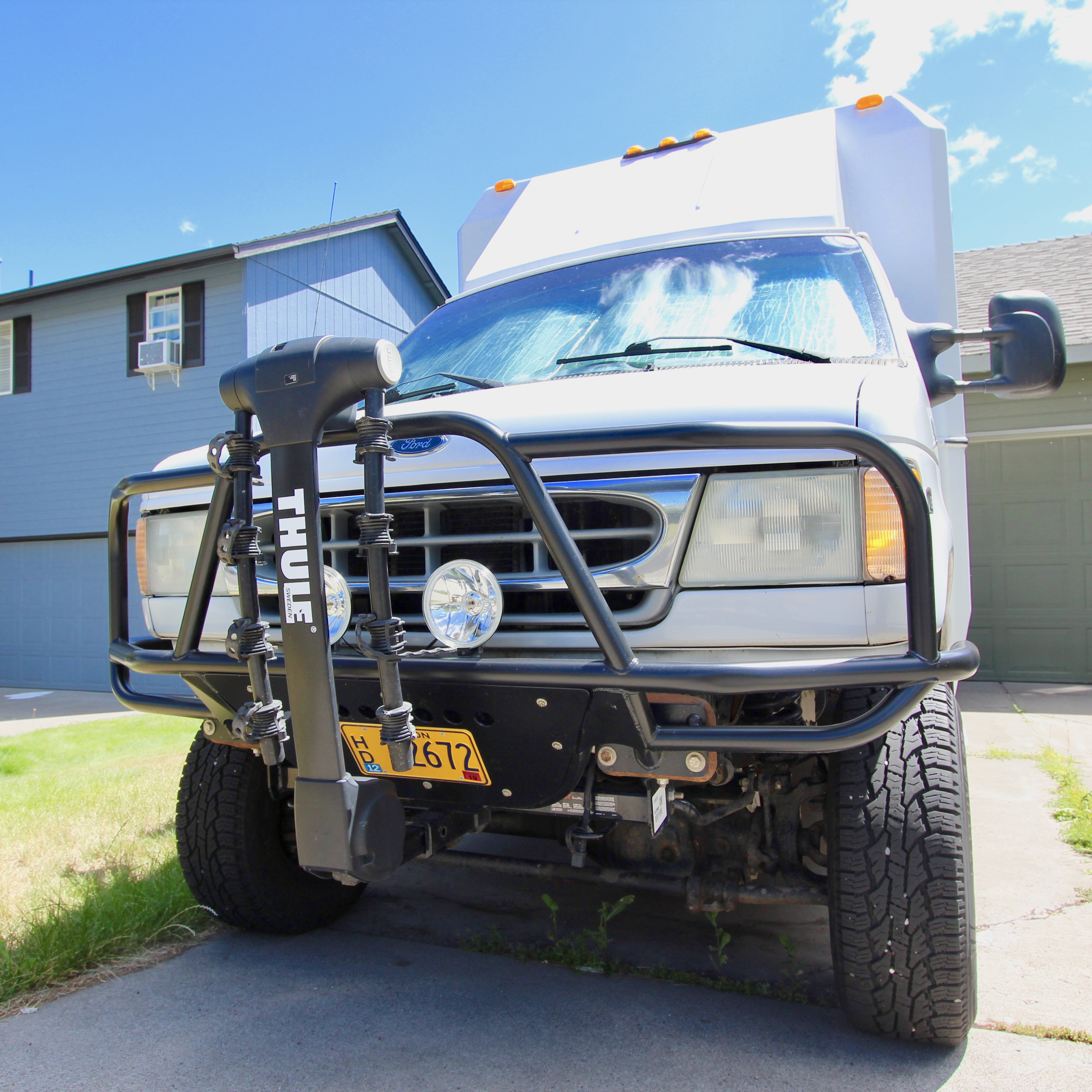

Front bumper/brush guard created by ThreeSixNine Custom Fabrication in Bend. Powder coated and extremely strong. Two Hella 500ff series driving lamps mounted and wired to come on with the bright switch for crazy good nighttime visibility.
