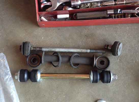

As to the rest, synchronicity, as I've just been doing a bit of such maintenance myself just a couple hours ago, replacing my front stabilizer bar end links. Figuring out a few tricks doing it on my Sub, before doing the missus' Tahoe this weekend. Hers are shot (165k mi), mine merely worn (126k mi). The parts are very inexpensive on rockauto, either AC Delco or aftermarket. The Delco front stab links are a PAIR, I think the others are single side only.
Drove a few miles around town afterwards, front suspension seems a bit better / more lively. No squeaks, but I'm thinking about brushing some moly grease on all the bushings when I do the other vehicle. But then again I'm in SoCal, it doesn't really matter.
http://www.rockauto.com/en/catalog/...8,1380327,suspension,stabilizer+bar+link,7580
pic in a bit
eta Some tips / tricks on the end links. You need to work on both ends at the same time, helps if the bar is free to pivot a bit. The new bushings are stiff, fat and tall. When everything is stacked, you won't see any threads on the thru bolt to put the nut on. And that's even with the bolt on the replacement part being longer than the original. I tried a couple different lame ways to squeeze the stablizer bar and lower control arm together, ratcheting tie down, bar clamp, ultimately I put a scrap block of wood between the bolt head and my floor jack and raised each side off the jackstands, put the whole weight on that lowest bushing and got enough threads exposed to put the top washer on and get the nut started. Then tightening things up was a snap. once together the 'squeeze' on the four bushings evens out.

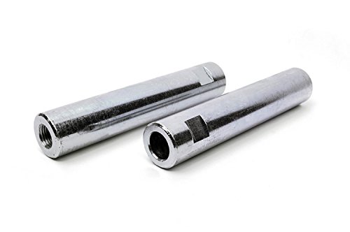

If your tie rods are the same as the ones that were on the 2004 Sierra I had I would upgrade immediately. Those things were so skinny I was always expecting them to bend or snap. This was a work truck so it didn't see any offroading other than getting the bike and camper to a camp spot.

Same concern here, I've had these bookmarked for a while, plan to put them in when I do my torsion key / spacer lift and shock replacements and my own balljoints. Might as well do it all at the same time and pay once for alignment. They basically replace the locking nut on the tie rod end and sleeve over those spindly 1/2" diameter tie rods.
http://www.amazon.com/dp/B00B2AEMXI...=UTF8&colid=QWZ1BSZYG6VW&coliid=IV05DBK1TYUVG
There are 'better' drop-forged beefy tie rod ends. They cost a good deal more, too.

As to those tie rod "sleeves". I would think that yes it would help with tie rods bending, but I would also think that would direct the forces closer to the joints which would be more prone to breaking. Maybe I'm over thinking this but that's my .02
rayra
well look at it this way, the ball joints are already bearing a lot of the stresses and you're talking about putting fresh ones in anyway. Full size truck is a lot of weight, SUV even more so. If your offroading plans include ruts or lurching around a lot of boulders, you can expect to bend those thin tie rods and chew up expensive tires. I'd rather put the wear on the ball joints than chew up my tires driving home with my toe-in totally off.

Rayra - interesting points on the sway bar connects. After a wheeling trip, I had completely pulled my stock ones through and they were just dangling. I got the same ones you are showing, but I didn't go through the experience of putting them on as my truck was in the shop getting some other work done so they just put them on for me.

I did the same stock links on the missus' Tahoe last night, as well. On hers I brushed on a bit of synthetic moly grease on both contact faces of all 8 bushings. Call it an experiment. And thanks to the 'trial run' on the Sub, it took very little time on the Tahoe. My brilliant scheme to have two large old low-mpg same-series 4wd SUVs finally pays a dividend!
Found her ball joint boots were all blown out, too, which is a minor messy bummer. The ball joints themselves seem to be in great shape for 165k mi (almost all highway). But her axle boots look fine. Yay for a mild climate. Wish there was a way to lube the control arm bushings without tearing things apart.
