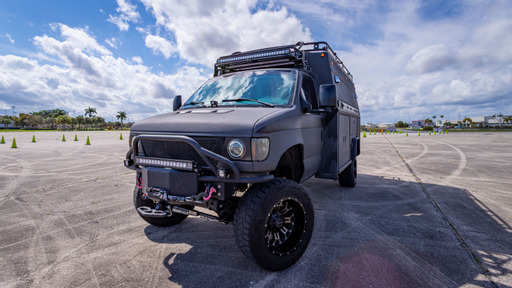

2003 4x4 expedition ambulance
Drive;
- u-joint offroad 4x4 conversion

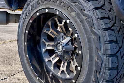

-6’ lift on 35’ toyo open countries (load range f)
-2 piece fuel wheels

Exterior’
-Coated with dark gray raptor liner
-Advanced fiberglass concepts front fenders with 3’ flare
-Custom aluminum rear fenders

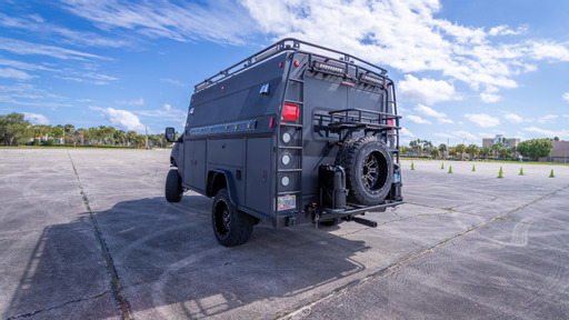

- custom Full length aluminum roof rack with 3 custom ladders and basket over cab
-custom rear bumper with swing out tire carrier and 2 jerry cans and basket above full size spare
-U-joint aluminum front bumper
-smitty built x20 12k winch with synthetic line
-Custom aluminum inserts for jeep wrangler headlights
-e-track system on driver and passenger exterior

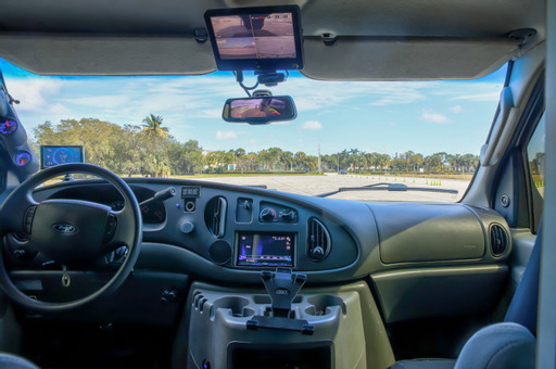

Pioneer 8200 nex double din head unit with nav, carplay, and android auto
2 jl amps, a single jl 10’ sub ,, jl 6x9’s,6’ kickers & tweeters in front doors
Front and rear cameras viewed from deck.
driver, passenger and rear interior cameras viewed from rear view mirror monitor
Front, rear, driver and passenger cameras that record 24/7 to dvr monitor from i-beam

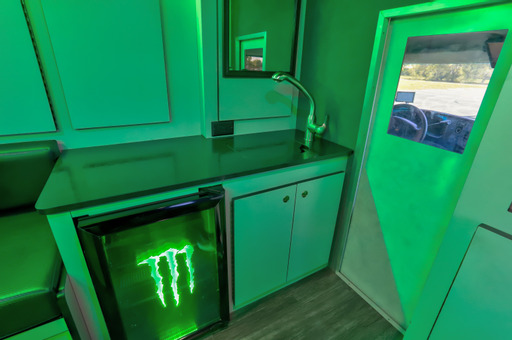

-48 in kitchen cabinet with countertop stainless sink and gray water jug under sink
-came with 2.7 cu ft fridge with ice box, i installed a monster fridge for coolness, i will include both

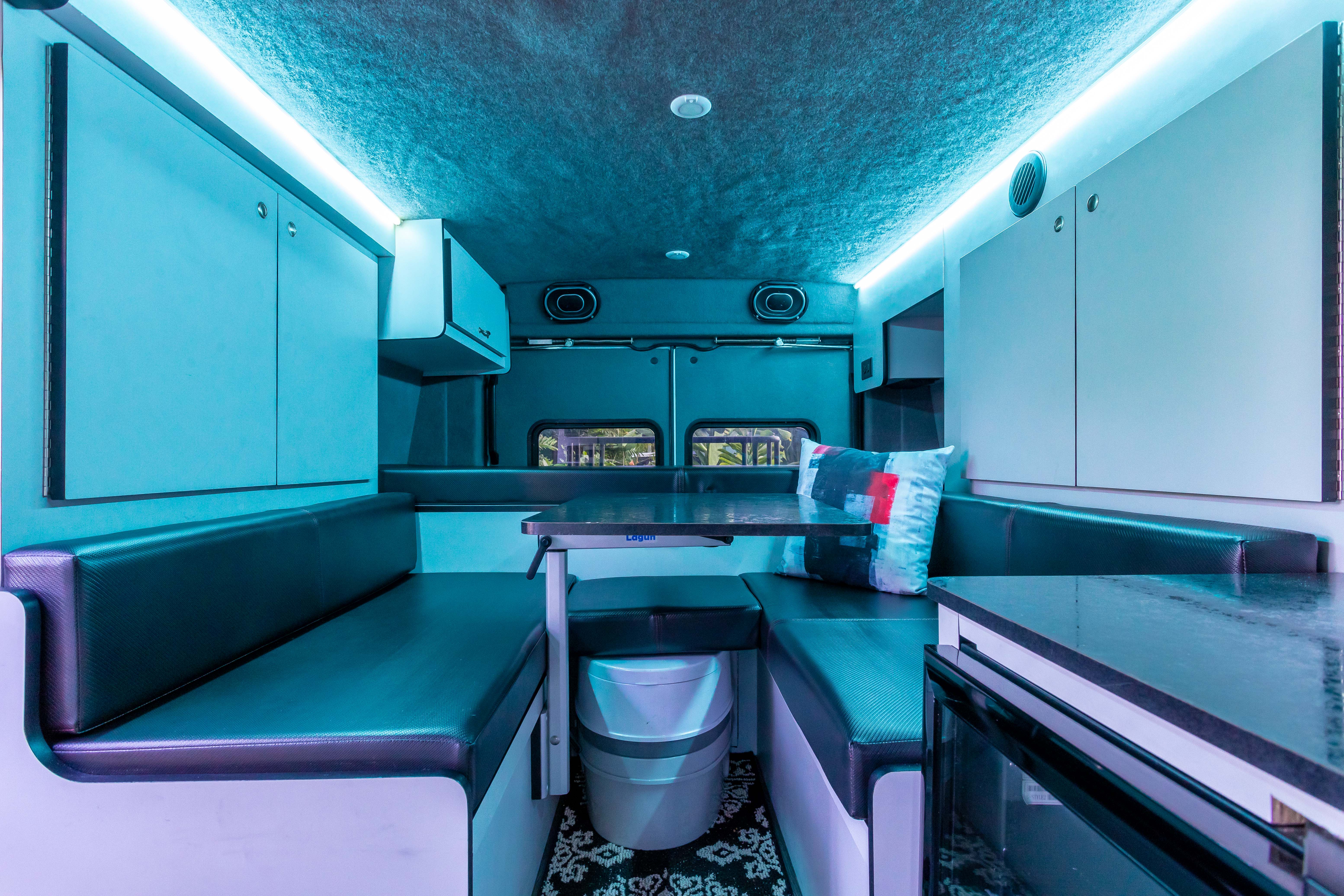

-platform bed
-2 3.7 ft benches that make extra bed
-floor to ceiling cabinet near entrance door
2 upper cabinets on driver side with adjustable shelves
-2 upper cabinets on passenger side
-laguna table with 2 mounting locations
- seat belts on both benches
