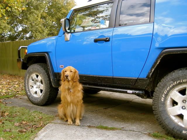

The humble beginnings with my pooch, Beau.
OME lift
285 BFGs
Pooch and ARB Rockrails w/ skids and ARB added.
Blacked out stock rims
Added some IPF 900XSD's and Warn M8000.

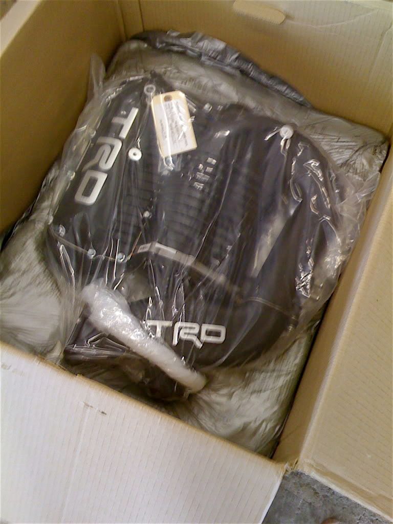

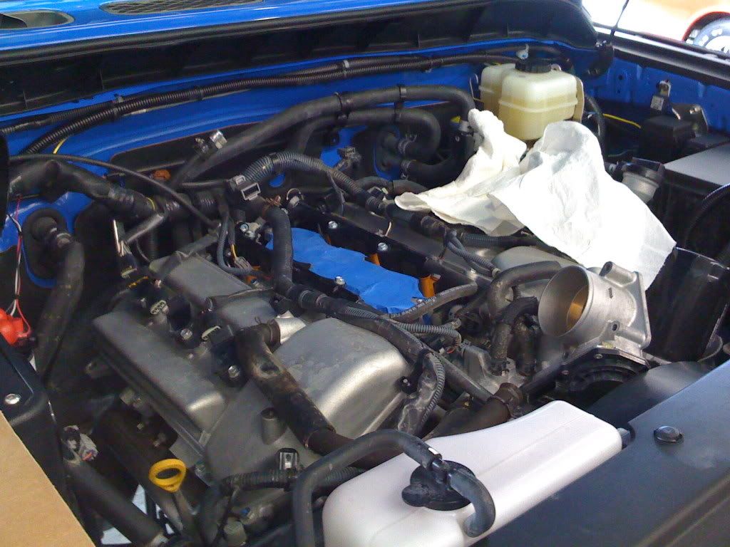

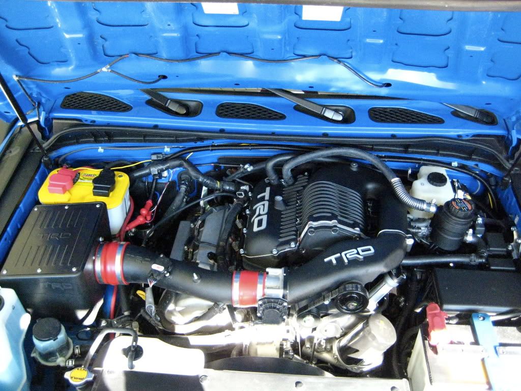

Next up on the list was some more power and a dual battery kit (oh an i have a TRD intake that was installed 2 days after the FJ was bought). The supercharger was a long install. I ran into a few things. The intercooler pump is supposed to be mounted in the front but the ARB and Warn are in the way. So i had to fab up a mounting spot, use the dremel to make room for tubing, fab up some tubing, relocate some stuff.

Finished up with the dual battery running an Optima yellow top as an auxiliary. I am not the best electrician so i purchased a dual battery kit (minus battery) from DirtyParts, INC.

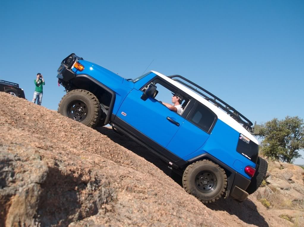

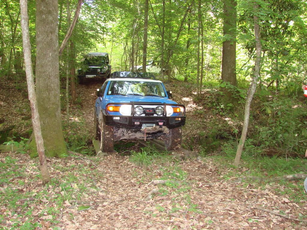

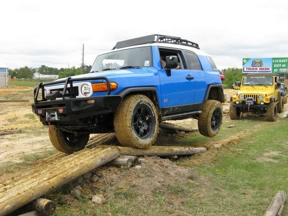

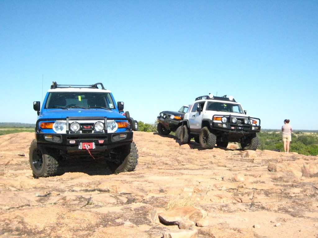

Now, a few wheeling pics.
My obligatory towing out a jeep pic. I believe this was this guys first time out wheeling in his new 4dr JK. Nice guy. His kid in the back seat looks frustrated that his dads jeep is getting pulled out by a Toyota though, haha.

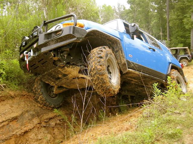

no sway flexing the OME heavies
Could you please tell me what the red plastic plate is that is in the front of your winch fairlead?...
Is it some sort of protection against the hook damaging the fairlead when rolled in?
Where do you get them from?
Thanks.
Thanks.
They are a relatively new product (Just the last few years) If you do it right it folds your winch hook in across the piece of urethane and you have no winch cable exposed and the urethane sort of acts like a cradle for the hook and a stop for the line. You can buy them at any generic 4x4 shop over here. http://winchdepot.com/Winches-Winch...s=124&t_pt=100737&t_pl=6573&t_pn=DAYKU70039BK
