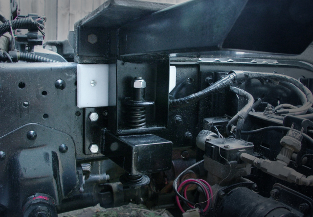

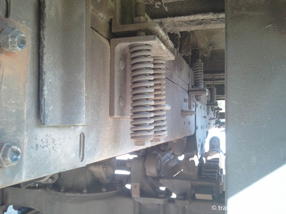

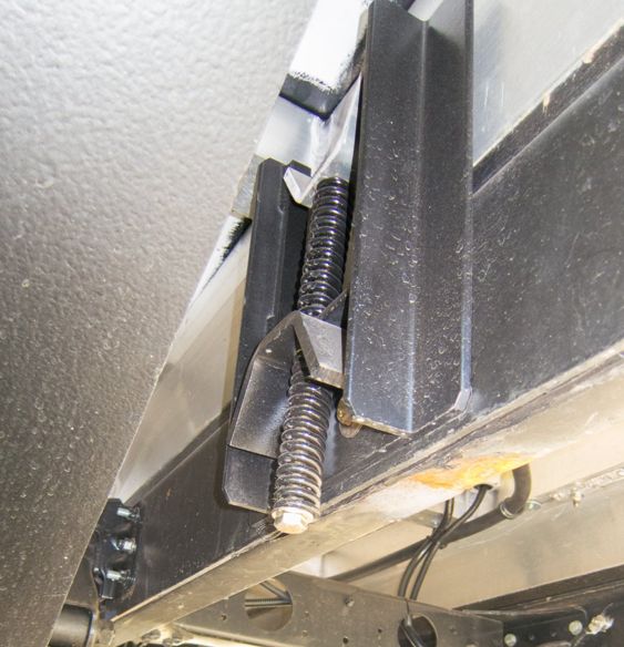

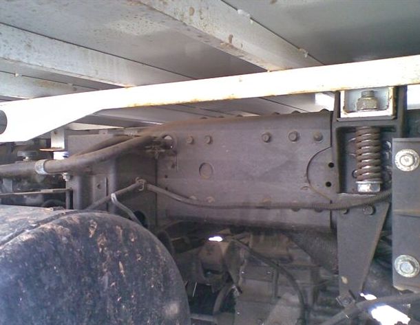

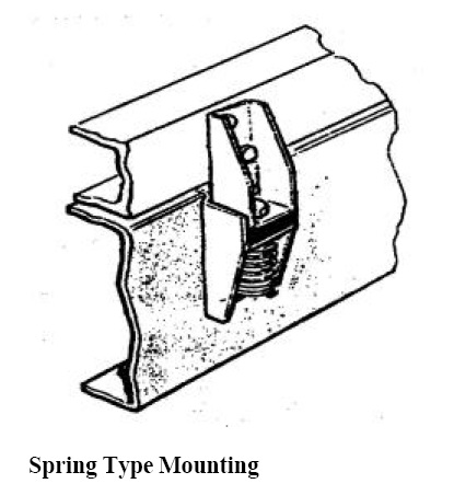

Would you ever consider building a camper off of that box, I.E. using that as a starting point? What do you think the box construction and mounting is?
The boxes are usually bolted to the frame directly - so expect lots of twisting if driven off-road. You'd probably want a subframe mounted on three points so the frame could flex w/o affecting the box. I think the box 'might be' strong enough to make a camper.
pugslyyy
Expedition Vehicle Engineer Guy
I agree - you could use the box but would want to change the mounting. You don't necessarily need a subframe, you could do it with spring mounts.
I'd say 100% yes. That is what I am doing (mine is a Marathon box, that is a Supreme, but the construction is the same).
.040 aluminum rivited to stringers every 16 inches. Rivited aluminum skin has been used since pre-WWII on aircraft that go through 100,000+ cycles without problems. Also these commerical boxes have to hold up to maybe a million+ miles, so if they can handle that, they can handle some 'market roads'. Very easy to run wiring, easy to insulate, etc, etc.
Yup, change the frame U-bolt mounts to a simple 'spring type' and you would be good to go.
