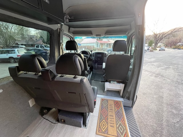

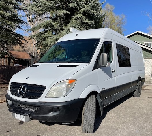

2007 Sprinter White High Roof 170 Inch - $46,000
enakffej
Spacious, fuel-efficient (19-20 MPG highway), great handling on- and off-road family adventure van
Light, modular build for stealth, on- and off-grid camping and mountain biking adventures
Seats and sleeps four with custom, removable MB two-person rear seat on factory mounts
115,200
3.2L Turbo Diesel V6 w/o DEF
Well maintained with no mechanical issues; new windshield

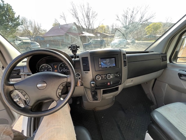

Alpine INE-W960 touchscreen navigation stereo, MRV-V500 amplifier, rear door 6x9” speakers and 10” subwoofer
Custom tuned Fox rear shocks, upgraded Bilstein B6 struts, Fr/R Sumo Springs (Vancompass Stage 3) and Over-sized AT Michelin LTX2 Tires (265/75 R16)
Well insulated ceiling, walls, and floor
Dometic FanTastic ceiling vent and fan
CR Lawrence split awning window in sliding door
Two 105 AH AGM cabin batteries w/ National Luna dual battery controller under passenger seat; charged by alternator, 100 W solar panel, or shore power charger
LED ceiling lighting
Cabin USB and 12V ports; 1,000 W inverter
Planar diesel cabin heater with wall-mounted thermostat controller
Queen-size bed w/ 4” trifold foam mattress
Four large custom drawers
RB Components overcab shelf and curtain
RB Components aluminum cabinet over passenger seat
Large garage with custom metal gear holder
L-track throughout
ARB CKMA12 air compressor mounted in engine compartment (air up tires, bikes, paddle board, and rafts)
Carefree Colorado Awning
Bed, back seat, drawers, and storage easily removed
Located in Durango, CO

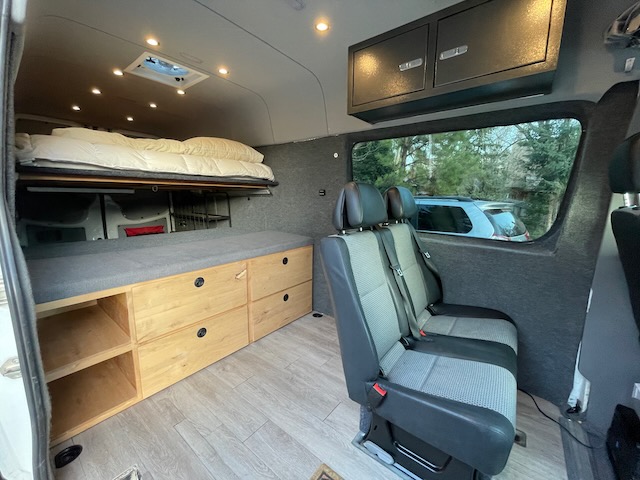

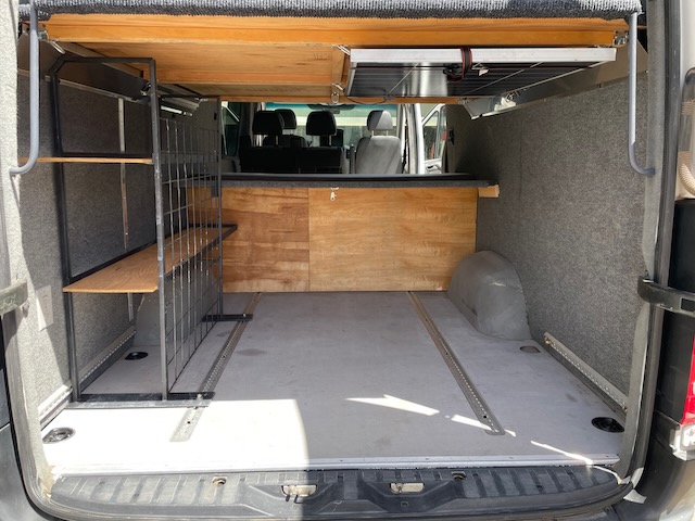

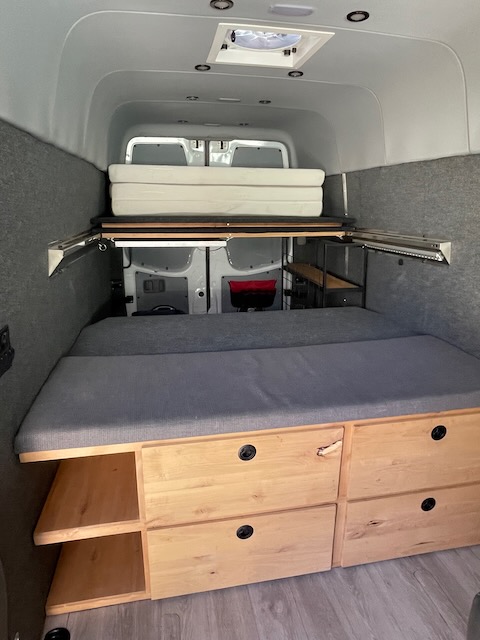

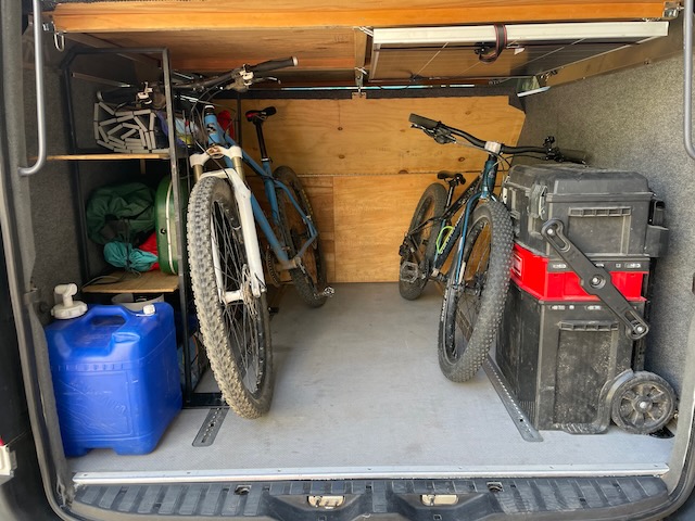

I'd like to see a few more pictures of the way the beds setup and also from the beds looking towards the drivers compartment. Can you also post a picture of the roof? How big are the beds?
enakffej
Thanks for your questions. Some additional pics:
Upper bed is queen size with two removable carpeted plywood panels on fixed rails that are welded to the wall. One of the pics shows it with the mattress folded and the two panels stacked toward the rear.
Lower bed is on top of the drawers and extends toward the rear on plywood mounted to it on a piano hinge. The rear portion can be raised and clipped to the upper bed to seal off the garage and provide addition room (that's a 29er with both wheels on in the photo above). The top of the drawers are upholstered with 2 inches of foam, the rear portion is carpeted only (we put a Paco pad there to sleep). The lower bed sleeps size ways and is roughly is 5.5 to 6 feet I believe (need to measure). It's where our kids sleep but I'd be happy there for a few nights.
I don't have any pictures of the roof, but will take some in the next few days. The only penetration in the roof is the fan. The awning is mounted to the factory roof rails. There are some holes where an awning was mounted in the past, which are sealed with silicone caulk.
