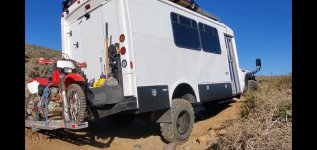

It does very well though I’m not looking for opportunities to maximize articulation. Here’s a pic of a pretty articulated section of trail. No problems.
