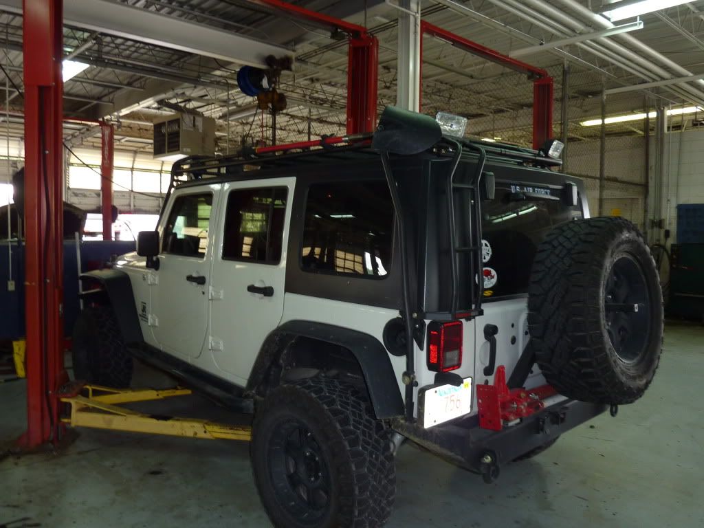

I've looked at several roof rack options as well. Like you, I think the AEV rack will be a good option whenever it is ready for market. As an alternative, I might also recommend the Front Runner Rack (http://www.frontrunneroutfitters.com/Roof-Racks-c35/). They mount to the hard top. They have two options listed for the JK Unlimited (the 2.2 and the 1.4), but I've talked with them about a 3rd mounting option. You can get the 1.6 rack (meant for the 2-door JK) fitted on a 4-door hard top. See the pic below of a Jeep that ran as a support vehicle for last year's Dakar rally with the same set-up. The rack will hang slightly over the freedom panels, but still allows for their easy removal. It also will remove with the hardtop, so you won't have to deal with unbolting the rack in order to remove the hardtop (unlike D-90). I have concerns, like many probably do, about mounting a rack to the fiberglass top, but you can order additional feet (like the Jeep pictured below) to spread the weight of the rack along the top.

Also, my brother Ben is an AEV dealer (http://hedrickspeedsports.com/), so let me know if you ever need anything! Ben has a thing for Hemi Jeeps. :) Here are some pics from our last trip to Uwharrie (http://benhedrick.com/styled-8/) I was in Ouray, CO back at the beginning of this month. That place never gets old! Again, good to see you, and maybe we can catch up the next time the family and I are in Asheville!
