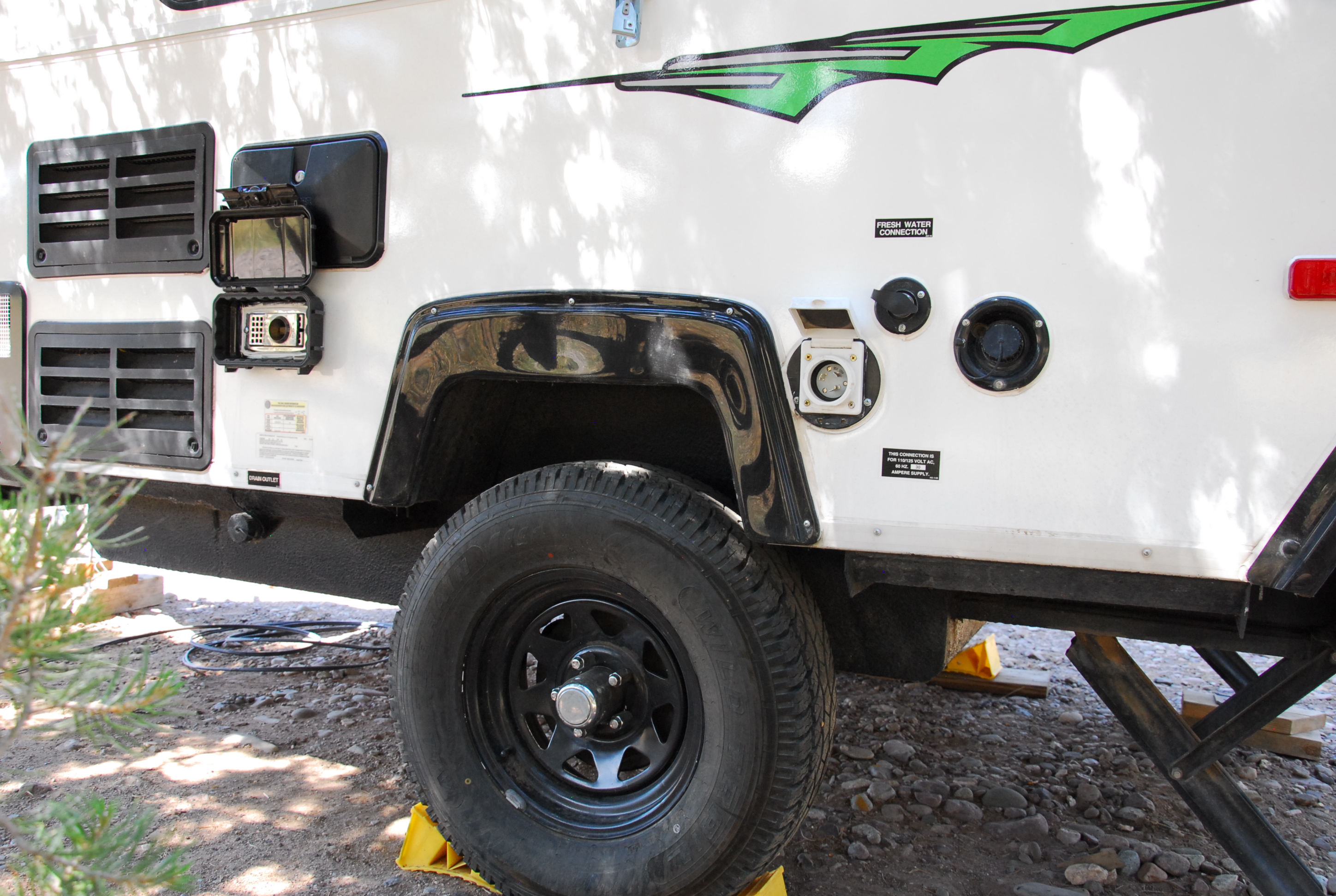

Frame/Suspension:
Added 2” x 3" Box Steel Frame between factory frame and suspension allowing the new floor to be “dropped” a full 7” in the walk-around area, yielding:
* Much stronger camper frame, reducing flex under load. Does not affect final effective ground clearance as the “drop” in the floor system is not full length and the body of the camper has raised 3” from this modification. Larger tires complete the final ground clearance equation.
* Increased stand-up height yields a full 8’ headroom from new "dropped" floor to peak of roof at interior. This mod was a game-changer in the livability of the camper, and no more creaking cabinets when moving around in unit.
* Stronger floor framing with 3/4" plywood over 2"x 2" welded box steel supports 16” oc. Dropping the floor has brought the counter top height to 35" - no stooping over low counters, while improving sightlines out windows and increasing interior spaciousness dramatically. Toe kick space incorporated at sink cabinet side. Two inches exterior-rated foam insulation below entire camper floor for warmth and quiet, totally undercoated, then covered with FRP panel below, except at gas line access.
* New, 6-ply, 15" tires allow for lower tire pressure, better ground clearance; full size matching spare.* Bumper upgrade to 4”x4” tubing. Supports spare tire or bicycles with less flex, stronger frame.

* 95 Watt solar panel with 35 amp GoPower Controller. Panel on 25' cable to find the sun; can be mounted on hitch when in camp, or simply set on the ground with its steel frame for stability.
* Dual 6v deep cycle batteries new in 2017
* Several LED light fixtures added for reading, over kitchen area, in cabinets. LED lighting throughout, includ ext porch light.
* Digital thermostat for furnace controls temp within approx. 4 degree variation.
* Cooling fans added at back of fridge increase cooling efficiency, with switch at interior.
* Shore power cord upgraded to exterior plug style to eliminate tangling under bed platform. Eliminates draft at sidewall penetration. Cord storage below bed platform deletion left more room for other utilities below bed.
