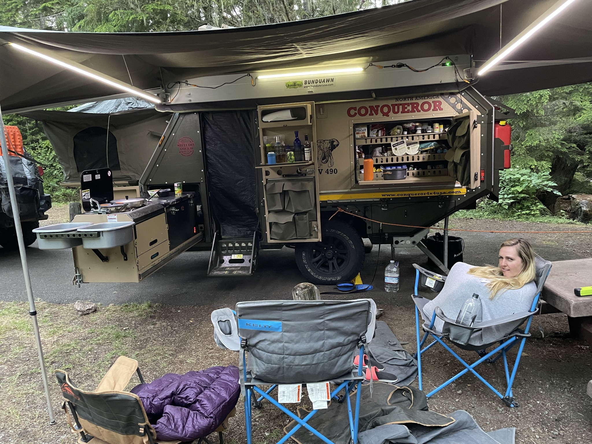

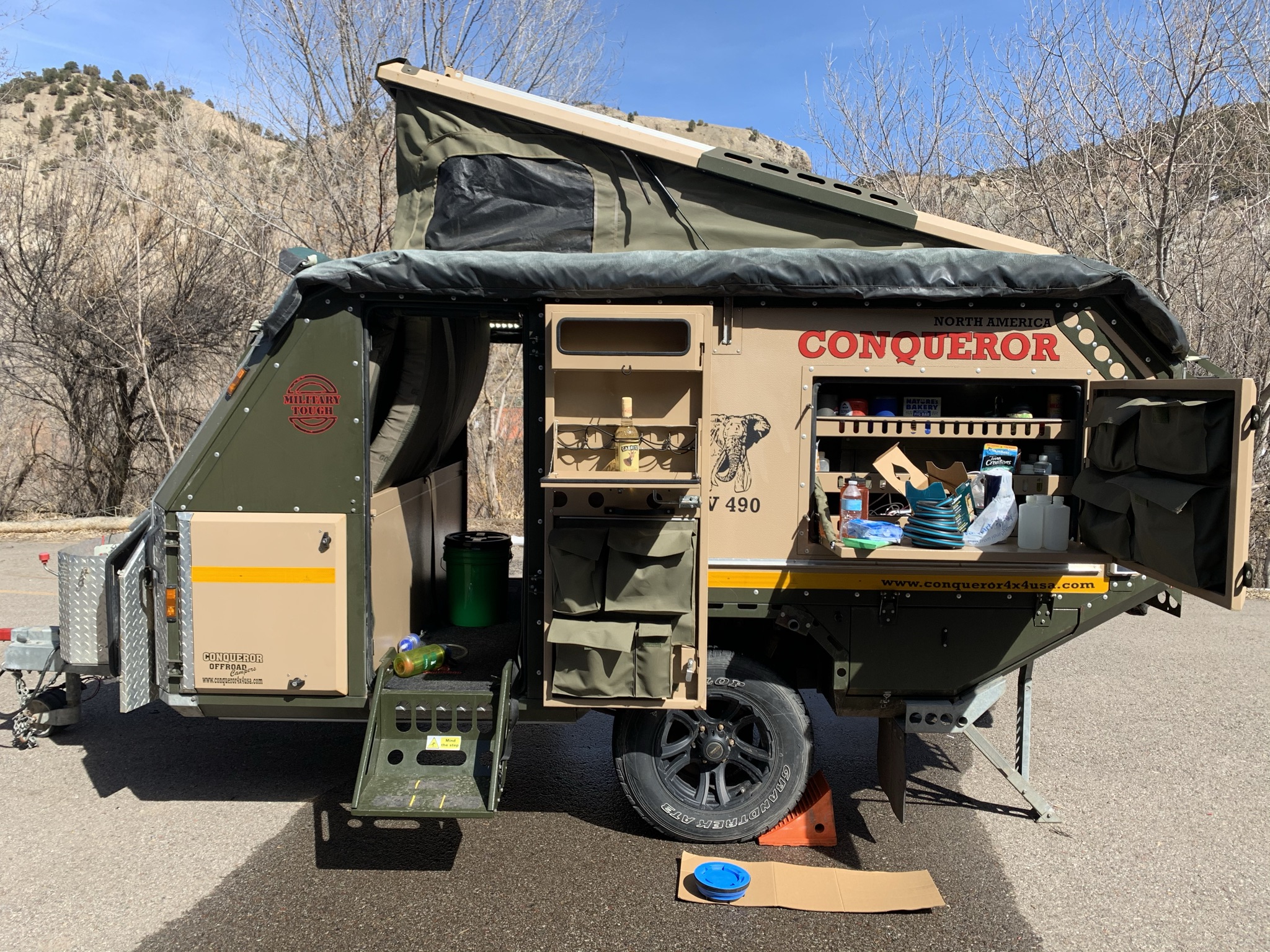

A 490 for the price of a Turtleback. I bought this a year ago and used it a number of times, but I honestly prefer a RTT setup for my kind of travel and I want to build a truck. I cant afford to do both, so shes for sale. I bought this last year for a fair price, and I put a lot of time into it and made some big improvements. Kind of describing the camper in this post as well as pros/cons.
I can guarantee this is the most affordable 490 in the country.

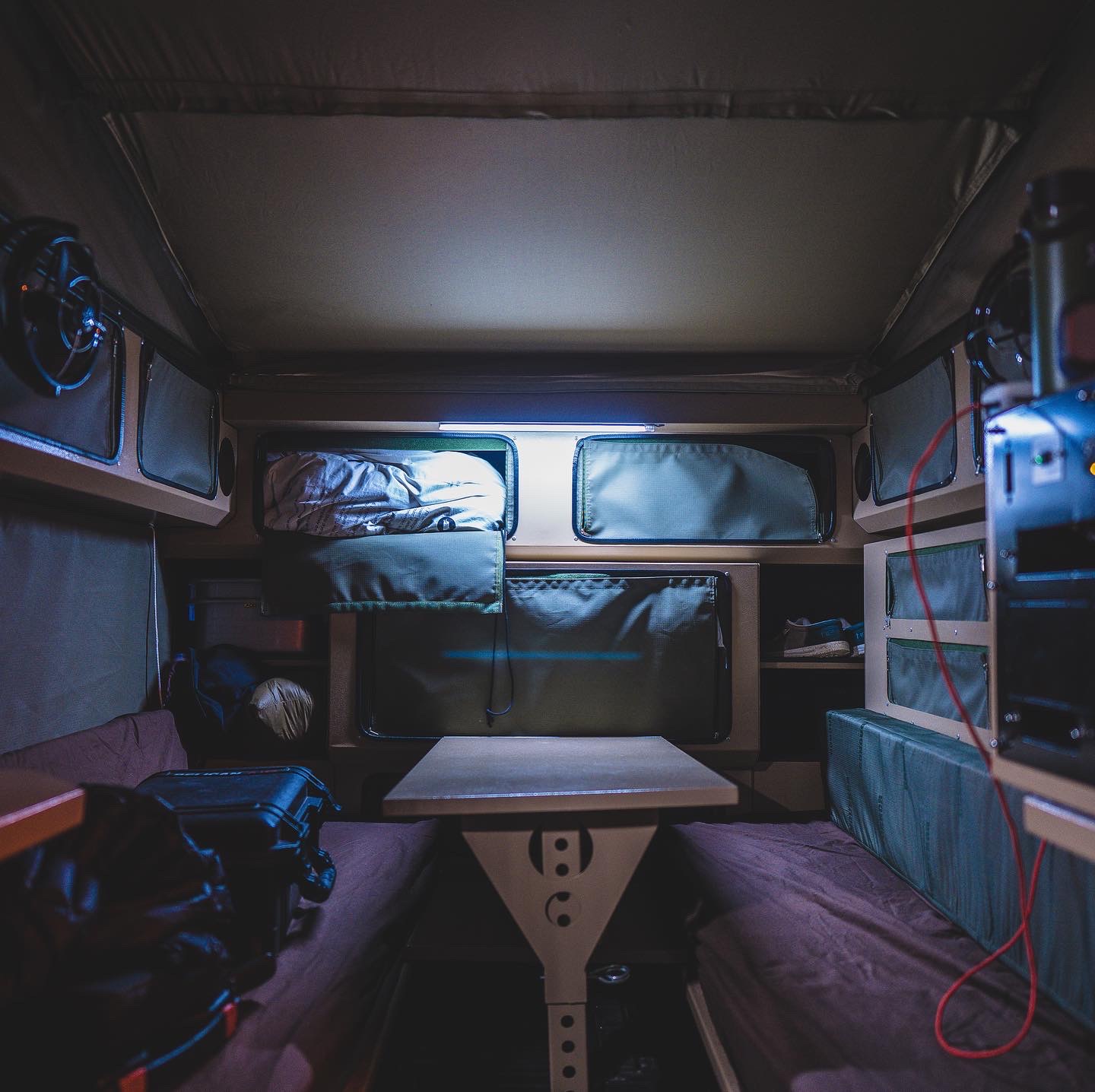

The camper can absolutely sleep 4. It has the couch area bed, which is cool because you can sleep like that when your on the move and you don't have to pop anything up. Just climb inside and go to sleep. The front has the fold out bed, which is where we typically sleep and we leave the other bed set up as 2 benches.

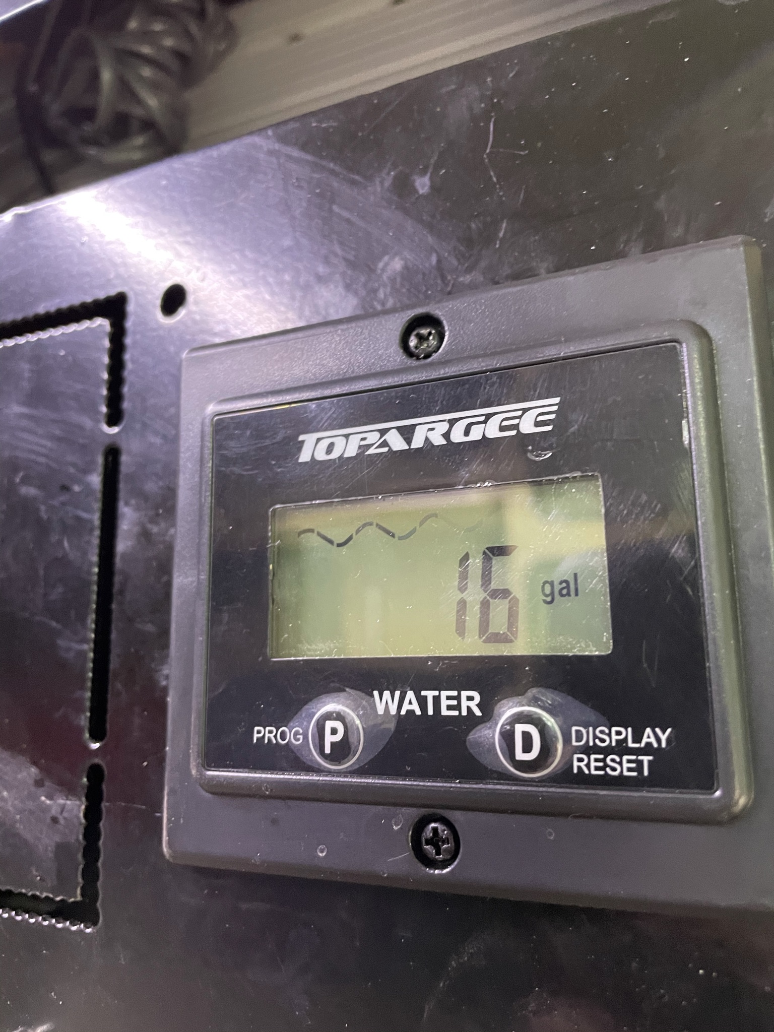

1.)I added a Topargee water monitor, which tells you how much water you have to the gallon.

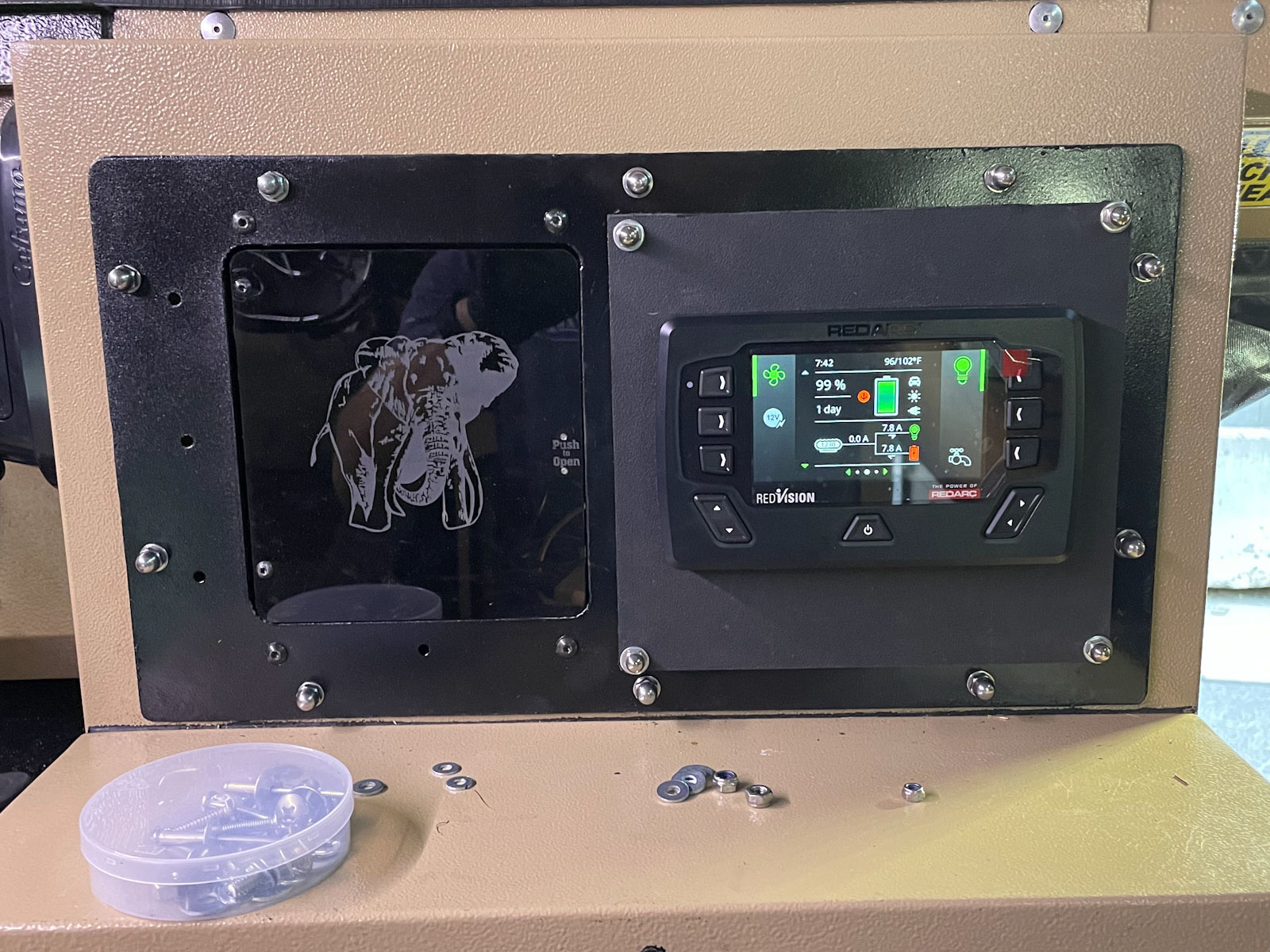

3.) I ripped out the entire control panel on the inside and replaced it with a Redarc Redvision and Manager 30 system. This gives it wireless controls from outside. One of the issues with the factory control is you had to climb inside for everything. With this, you can turn internal lights, water pump, etc on with your phone. Along with this upgrade I ran the top 200w solar panels (included) permanently to the charger. The factory setup you had to run cables every time you got to camp which was weird. I then added an aux solar input at the rear. I wont be including my extra solar panel, but if you decide to get one you can hook up at the rear very easily with an Anderson plug and have up to 30a of charging power. The battery system stays at 100% with the included 200w of solar, I was using my portable solar panel to run my portable AC unit.

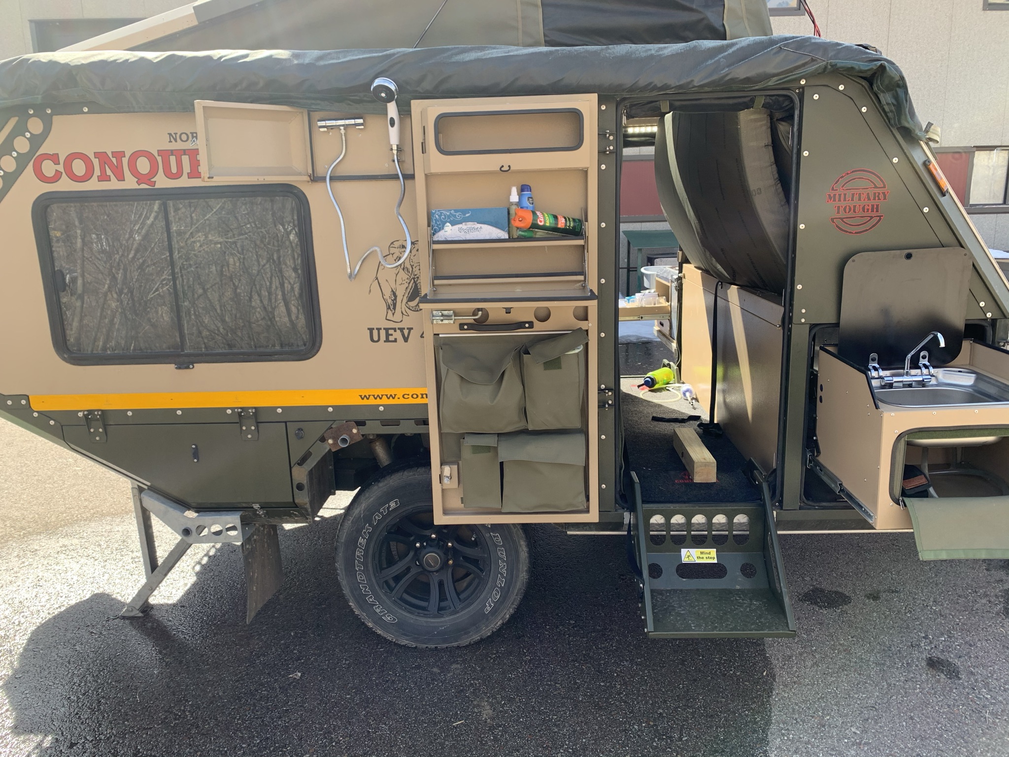

1.)The roof gasket could use a replacement. I havent seen any water come in because of it, and it has been through a fair bit of rain. Its about 80 bucks on Amazon for enough of it, I have the part number saved somewhere.
2.) Its missing one of the Duvet cover for one of the beds, as well as a coffee cup from the original kit.
3.) It lived its first years in Alaska. There is some rust under it on the A-arms for the suspension. Its not structural and I fluid filmed it when I first saw it, but its there and should be noted. Sort of like when your powder coat on a roof rack starts to flake type of rust, not the wheels are about to fall of sort of thing.
4.) Theres a large ding in the pantry door. The original owner left it unlatched and took off, and it swung around and put a dinger in it.
5.) The front bed and bathroom side awning covers are crunchy. This is a known thing with the Conqueror campers, as the covers weren't made with UV resistance tarp for some reason. They still zip up, but will likely need taken to a boat or truck tarp place in the next few years to have a new cover made. My brother works at such a place if you dont have anyone local, I just havent gotten around to handling it. More of a cosmetic thing currently.
