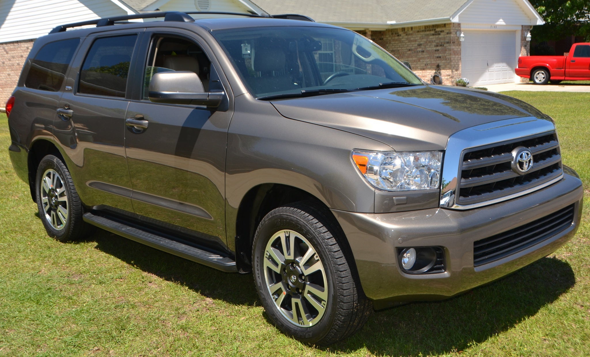

Hi Guys,
I’m still in the parts-gathering stage of my build, but this is the planned parts list for the Sequoia Expo Rig:
FRONT AXLE- ICON Coilovers
UCA- ICON with Delta Joint
REAR AXLE- Tundra rear axle swap with Leaf spring conversion, ICON RXT Multi Rate leaf spring
WHEELS- 17” ICON Rebound
TIRES- Nitto Ridge Grappler , (33” or 34”)
RACK- Rhino, ARB or Front Runner
SNORKEL- Modified-ARB 200 series
RTT- CVT or Tepui
WINCH BUMPER- Expedition One or CBI
REAR BUMPER with tire carrier- CBI
Traction device- ARB front and rear
SKID PLATES- ARB
DIFF BREATHERS-ARB
WINCH-WARN
ordered and in route-
Tundra tow mirrors
Heat Shield - windshield Reflector(loves these things)
Weather Tech floor liners
Vent Shades
