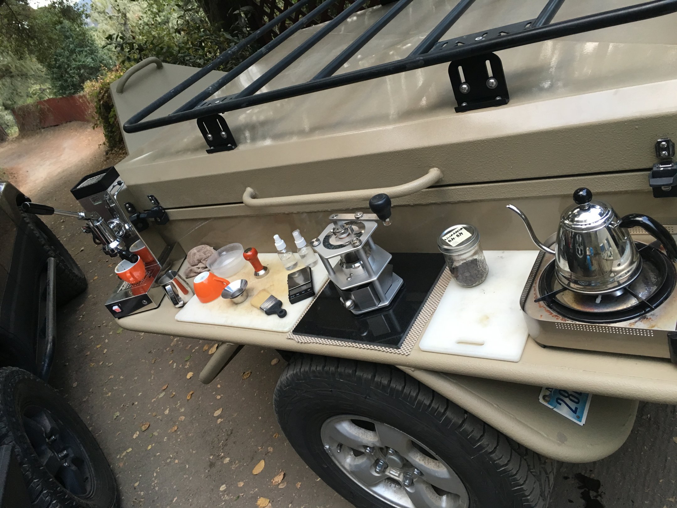

I wanted full length "fenders"; we NEVER have enough table space when camping. And the two full length fender-shelves ARE FANTASTIC!!!

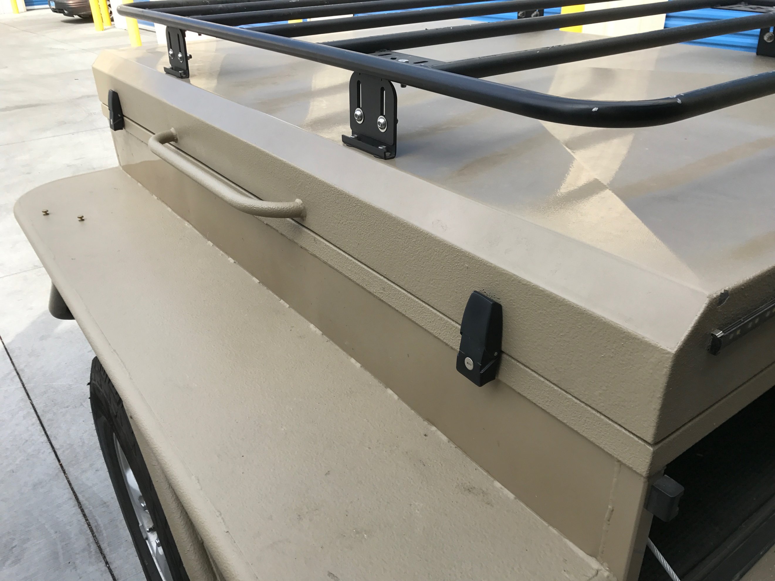

All steel construction with a cross-brake'd lid for efficient weight-to-rigidity. Jason sprayed the front, lead edges and bottom with color to match paint Monstaliner. All surfaces, inside, out, suspension components, etc. were sprayed with paint or Monstaliner.
The main box is 4'x6' plus the nose box. The main cargo box lid is designed to be removable by sliding forward the lifting off. All latches are high quality SOUTHCO; no cheap crap here!

Full custom Trail Tailor roof rack.

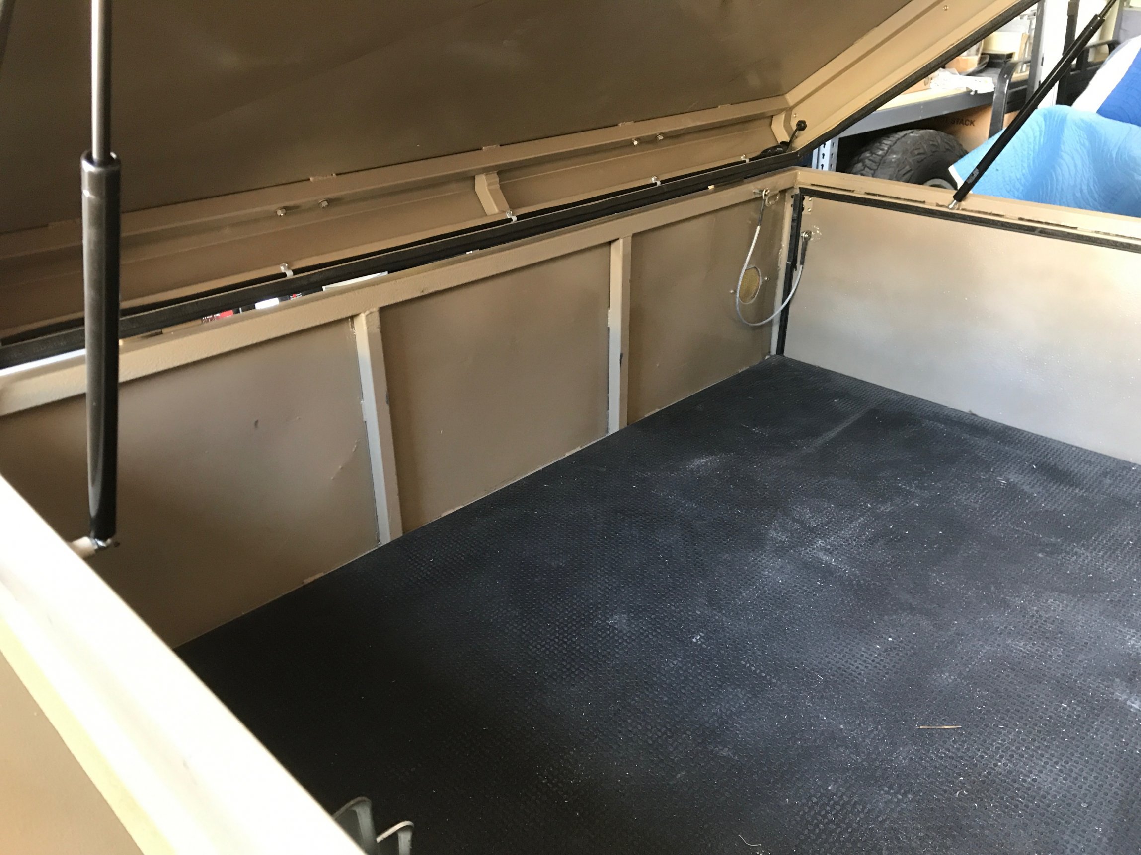

Has a super heavy duty reinforced 3/4" thick 4' x 6' rubber pad for the cargo floor.

350psi airlift struts

I am a nut about dust ingress. I used polyurethane sealant on ALL panel seams: Main cargo & nose box. Additionally I installed commercial automotive grade commercial bulb seals on the nose box lid, rear tail gate & double seals on the cargo lid.
I also installed a fine dust filter assembly that equalizes pressure between the inside and outside of the trailer to minimize/eliminate dust being sucked into the trailer's box. Works!
